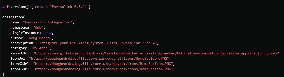

@dnickel ...Just curious, what integration have you been using...Option #1- native Hubitat, or Option #2- the redloro-nodeproxy integration that @brianwilson maintains?
From HPM
OK..that is the same one I have been using...Option #1 - native Hubitat. It works well as long as you don't rely on the HSM integration to arm/disarm the system.
