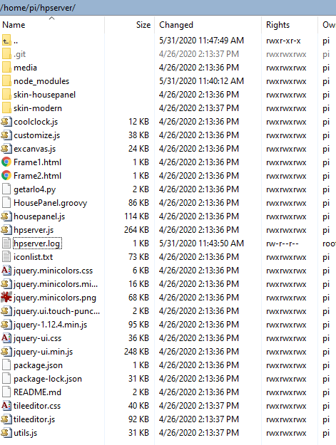

My directory looks like:
I am sure i am missing something basic, can you point me in the right direction?

Hi Jeff
You are mixing the old and the new together. The new version doesn’t use PHP at all. And none of the complicated file permissions apply any more. It’s a lot easier.
The doc online is only for the old. I’m updating it this week but not yet done. Until then follow the directions I gave @ross1 above that basically just loads the Node server and then you browse to the rPI on port 3080.
