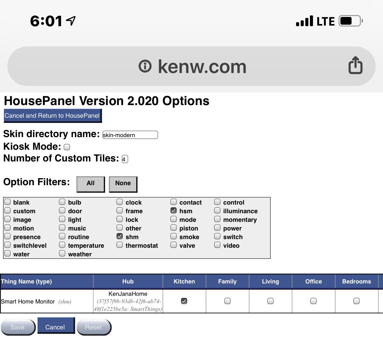

When you are in HP click the Options button. Then select HSM in the checkbox list. You should see it. If not you need to add it when you edit the app on the main Hubitat page.
HSM should be the second checkbox in the 4th column on the Options page. This screenshot doesn’t have it because I’m not at home on my intranet but it shows the checkbox you want to use
Literally every box is checked in that section including HSM/SHM... I don't even see it as a device to add in the HP app within Hubitat... That is my issue... How do I get the app to see it so I can add it to the list of devices? I'm pretty sure I can figure it out on the HP side... Its the Hubitat side that has me messed up... :slight_smile:
