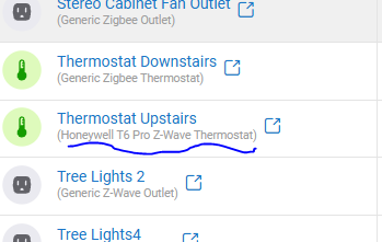

Apologies to answer this with a story but... I was gonna say The Generic driver but I installed it on the C-8 Pro by choosing the actual device in the Brand option. Next thing I know it asked me if I wanted to replace one of my Thermostats to which I replied Hell Yeah. Next thing I know is the install is finished and the little man pops out of the C-8 Pro and starts serving cocktails. I have only had a couple of things to do with this HUB and its been very smooth, not like some of the teeth pulling i got used to with the C-5. See Device Screen Snip, Thanks for your reply.

I'm using @thebearmay Advanced Honeywell T6 driver.
He has every configuration possible in the preferences section of the driver.
