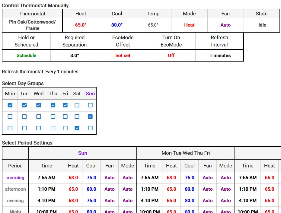

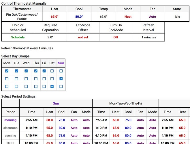

Update on this issue. rlithgow1 you were right I missed setting ISU 300 on this thermostat, and I have moved all of the drivers to the Advanced driver suggested by user2574. But I still have some issues with that driver. I am seeing some errors and some not all of the thermostats don’t respond to the scheduler. The example below the schedule called for the thermostat to be set to 68 but it was still set to 65 minutes after the scheduled time. This was the scheduler screen shot. I did use the scheduler to manually set the temp after taking the shot and the thermostat did respond to the temperature manual change.
2025-03-02 08:13:05.990 AM info Heating Setpoint for Pin Oak/Cottonwood/Prairie: 68.0 from Manual
app:62025-03-02 08:11:33.495 AM info Heating Setpoint for Pin Oak/Cottonwood/Prairie: 70.0 from Manual
app:62025-03-02 07:55:01.207 AM info Thermostat Fan Mode auto from Time Schedule
app:62025-03-02 07:55:00.692 AM info Cooling Setpoint 75.0 from Time Schedule
app:62025-03-02 07:55:00.651 AM info Heating Setpoint 68.0 from Time Schedule
app:62025-03-02 07:55:00.617 AM info Thermostat Mode auto from Time Schedule
dev:62025-03-02 07:57:13.211 AM debug parse:zw device: 32, command: 8106, payload: 27 39 , isMulticast: false
dev:62025-03-02 07:57:12.502 AM debug parse:zw device: 32, command: 7006, payload: 01 01 00 , isMulticast: false
dev:62025-03-02 07:57:10.283 AM debug Got thermostat setpoint report: ThermostatSetpointReport(value:[3, 32])
dev:62025-03-02 07:57:10.280 AM debug parse:zw device: 32, command: 4303, payload: 02 2A 03 20 , isMulticast: false
dev:62025-03-02 07:57:10.166 AM debug Got thermostat setpoint report: ThermostatSetpointReport(value:[2, 138])
dev:62025-03-02 07:57:10.163 AM debug parse:zw device: 32, command: 4303, payload: 01 2A 02 8A , isMulticast: false
dev:62025-03-02 07:57:06.203 AM debug Translated thermostat mode: heat
dev:62025-03-02 07:57:06.202 AM debug Got thermostat mode report: ThermostatModeReport(mode:1)
dev:62025-03-02 07:57:06.200 AM debug parse:zw device: 32, command: 4003, payload: 01 , isMulticast: false
dev:62025-03-02 07:57:05.356 AM debug Translated thermostat mode: heat
dev:62025-03-02 07:57:05.355 AM debug Got thermostat mode report: ThermostatModeReport(mode:1)
dev:62025-03-02 07:57:05.353 AM debug parse:zw device: 32, command: 4003, payload: 01 , isMulticast: false
dev:62025-03-02 07:57:04.502 AM debug Translated fan state: idle
dev:62025-03-02 07:57:04.500 AM debug Got thermostat fan state report: ThermostatFanStateReport(fanOperatingState:0)
dev:62025-03-02 07:57:04.498 AM debug parse:zw device: 32, command: 4503, payload: 00 , isMulticast: false
dev:62025-03-02 07:57:03.648 AM debug Translated fan state: idle
dev:62025-03-02 07:57:03.647 AM debug Got thermostat fan state report: ThermostatFanStateReport(fanOperatingState:0)
dev:62025-03-02 07:57:03.645 AM debug parse:zw device: 32, command: 4503, payload: 00 , isMulticast: false
dev:62025-03-02 07:57:02.081 AM debug Translated fan mode: auto
dev:62025-03-02 07:57:02.080 AM debug Got thermostat fan mode report: ThermostatFanModeReport()
dev:62025-03-02 07:57:02.078 AM debug parse:zw device: 32, command: 4403, payload: 00 , isMulticast: false
dev:62025-03-02 07:57:01.383 AM error
java.lang.NullPointerException: Cannot invoke method toInteger() on null object on line 593 (method parse)
dev:62025-03-02 07:57:01.377 AM debug got temp: 65.0
dev:62025-03-02 07:57:01.375 AM debug parse:zw device: 32, command: 3105, payload: 01 2A 02 8A , isMulticast: false
dev:62025-03-02 07:57:01.300 AM debug got humidity: 28.0
dev:62025-03-02 07:57:01.298 AM debug parse:zw device: 32, command: 3105, payload: 05 22 01 18 , isMulticast: false
dev:62025-03-02 07:57:00.763 AM error
dev:62025-03-02 07:57:00.758 AM debug got temp: 65.0
dev:62025-03-02 07:57:00.756 AM debug parse:zw device: 32, command: 3105, payload: 01 2A 02 8A , isMulticast: false
dev:62025-03-02 07:57:00.745 AM debug got humidity: 28.0
dev:62025-03-02 07:57:00.743 AM debug parse:zw device: 32, command: 3105, payload: 05 22 01 18 , isMulticast: false
dev:62025-03-02 07:57:00.627 AM error
dev:62025-03-02 07:57:00.589 AM debug got temp: 18.5
dev:62025-03-02 07:57:00.586 AM debug parse:zw device: 32, command: 3105, payload: 01 22 00 B9 , isMulticast: false
dev:62025-03-02 07:57:00.122 AM info
Pin Oak/Cottonwood/Prairie battery is 95%
2025-03-02 07:57:00.120 AM debug got battery report: 95
dev:62025-03-02 07:57:00.118 AM debug parse:zw device: 32, command: 8003, payload: 5F , isMulticast: false
dev:62025-03-02 07:55:24.223 AM debug skip:ClockReport(hour:7, minute:55, weekday:1)
dev:62025-03-02 07:55:24.221 AM debug parse:zw device: 32, command: 8106, payload: 27 37 , isMulticast: false
dev:62025-03-02 07:55:24.125 AM debug Translated presence: present
dev:62025-03-02 07:55:24.124 AM debug Got presence report: BasicReport(value:255, targetValue:255, duration:0)
dev:62025-03-02 07:55:24.122 AM debug parse:zw device: 32, command: 2003, payload: FF FF 00 , isMulticast: false
dev:62025-03-02 07:55:01.199 AM debug setting zwave thermostat fan mode 0
dev:62025-03-02 07:55:01.198 AM debug setThermostatFanMode(auto)
dev:62025-03-02 07:55:00.658 AM debug setCoolingSetpoint(75.0) called
dev:62025-03-02 07:55:00.625 AM debug setHeatingSetpoint(68.0) called
dev:62025-03-02 07:55:00.108 AM debug setting zwave thermostat mode 3
dev:62025-03-02 07:55:00.107 AM debug setThermostatMode(auto)
dev:62025-03-02 07:54:44.557 AM debug Translated fan mode: auto
