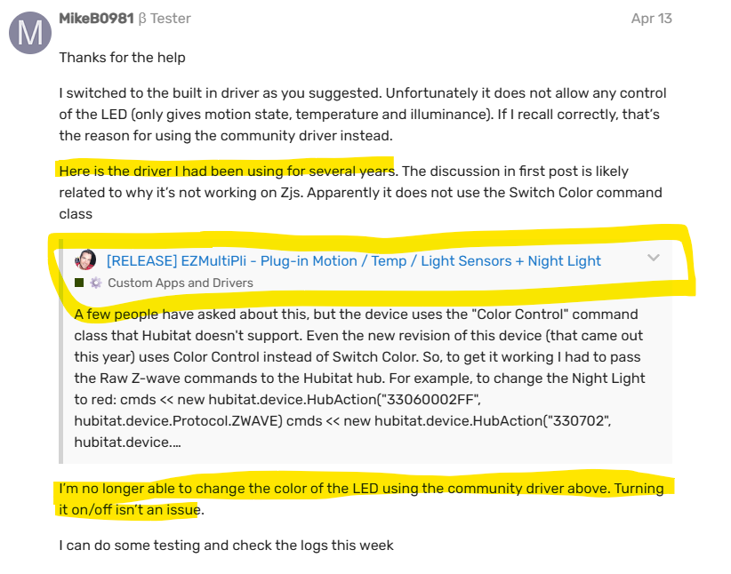

you are right, I didn't send the logs but I did answer your other questions. My apologies.
Last night I decided to exclude these devices from my C-8 Pro running Z-Wave JS and included them on my C-7 and brought them over using hub mesh. They are working fine now
Right, we've addressed the problem with that specific driver (this is not a hub problem) above:
Trying the built-in driver or at least a custom driver that uses the classes would be better (in the sense that it's the only thing that stands a chance of working :smiley: ), as also mentioned above.
Logs (and knowing what's actually happening around this time, e.g., what command you're sending with what parameters) are really going to be the key to figuring this out; if you're happy with them on the C-7, that's good, but we'll have to wait for someone with them on Z-Wave JS to provide this information in that case. Thanks!

i have a version of my driver for this working without raw hex i believe should work in zwave js.. i dont have js yet on a hub so cannot test fully but if you search for ezmulti in hubitat package manager you should find the driver. let me know.
