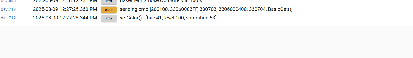

ok here is the version of setcolor in my driver.. not the one above.. same issue.. i have not switched to zwave js as i have 5 of these devices that will not work for that reason.

log.warn "sending cmd $cmds"
commands(cmds)
here is the log showing what is sent
