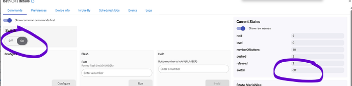

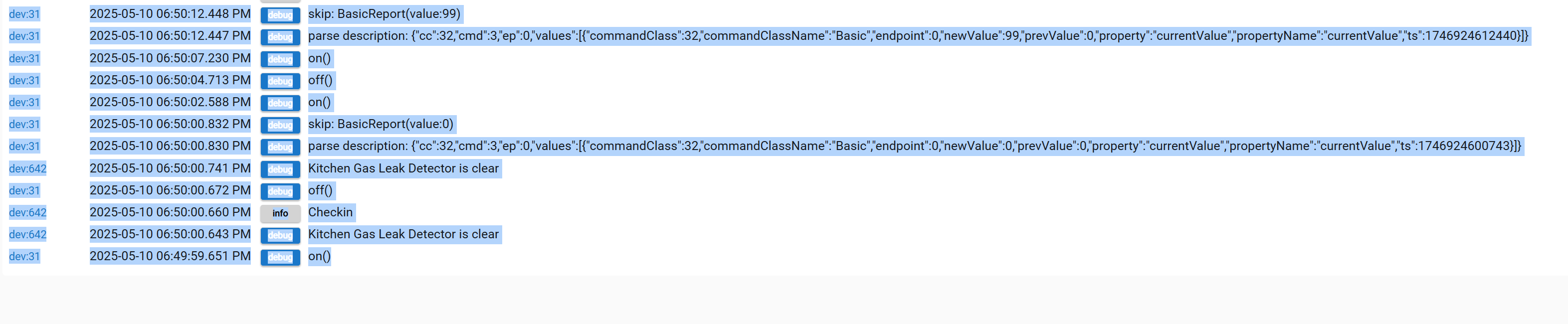

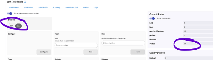

So here are some screenshots

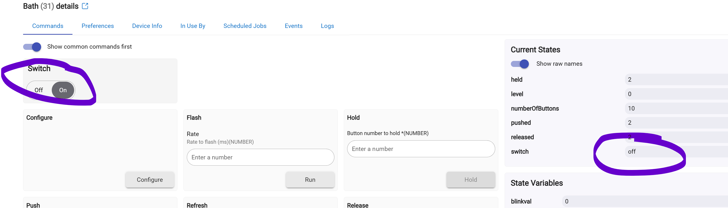

The switch status never update. PS - A switch can only have two states...on/off...this NEVER updates.

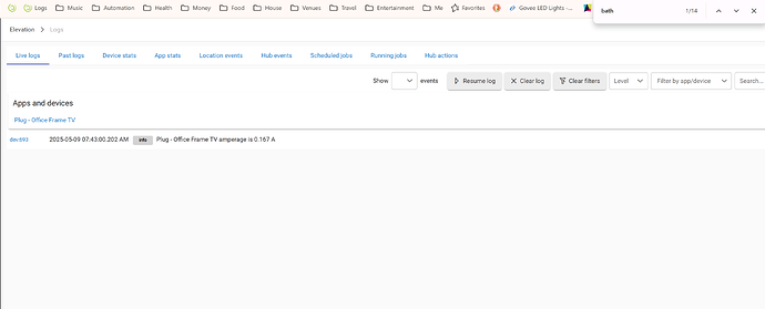

Debug is enabled
BUT NOTHING EVEN SHOWS IN THE LOG - I turned it on/off 6 times and this is the log output...

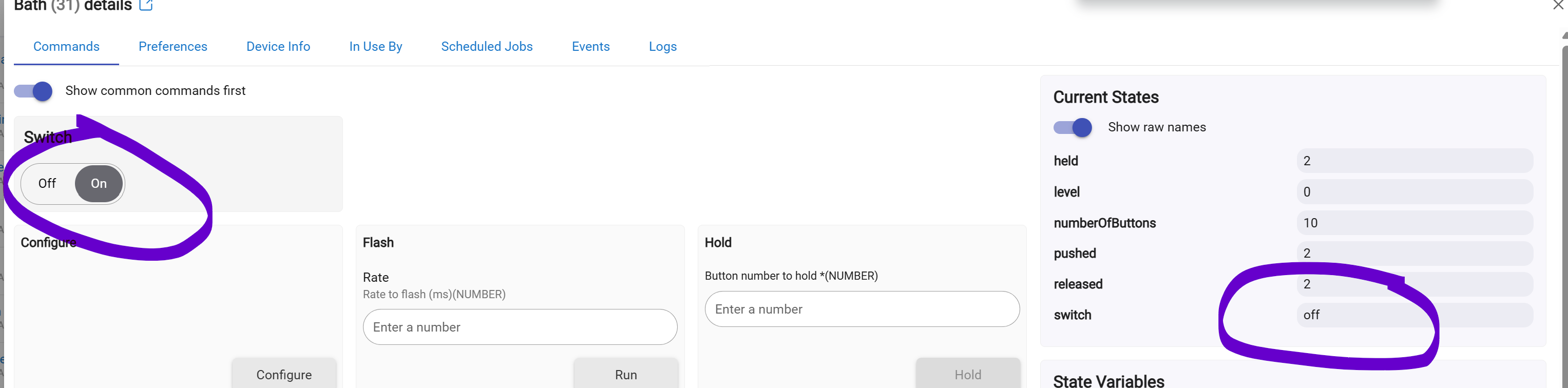

So now the funny/irritating thing?
The light is actually turning on/off each time I send the command

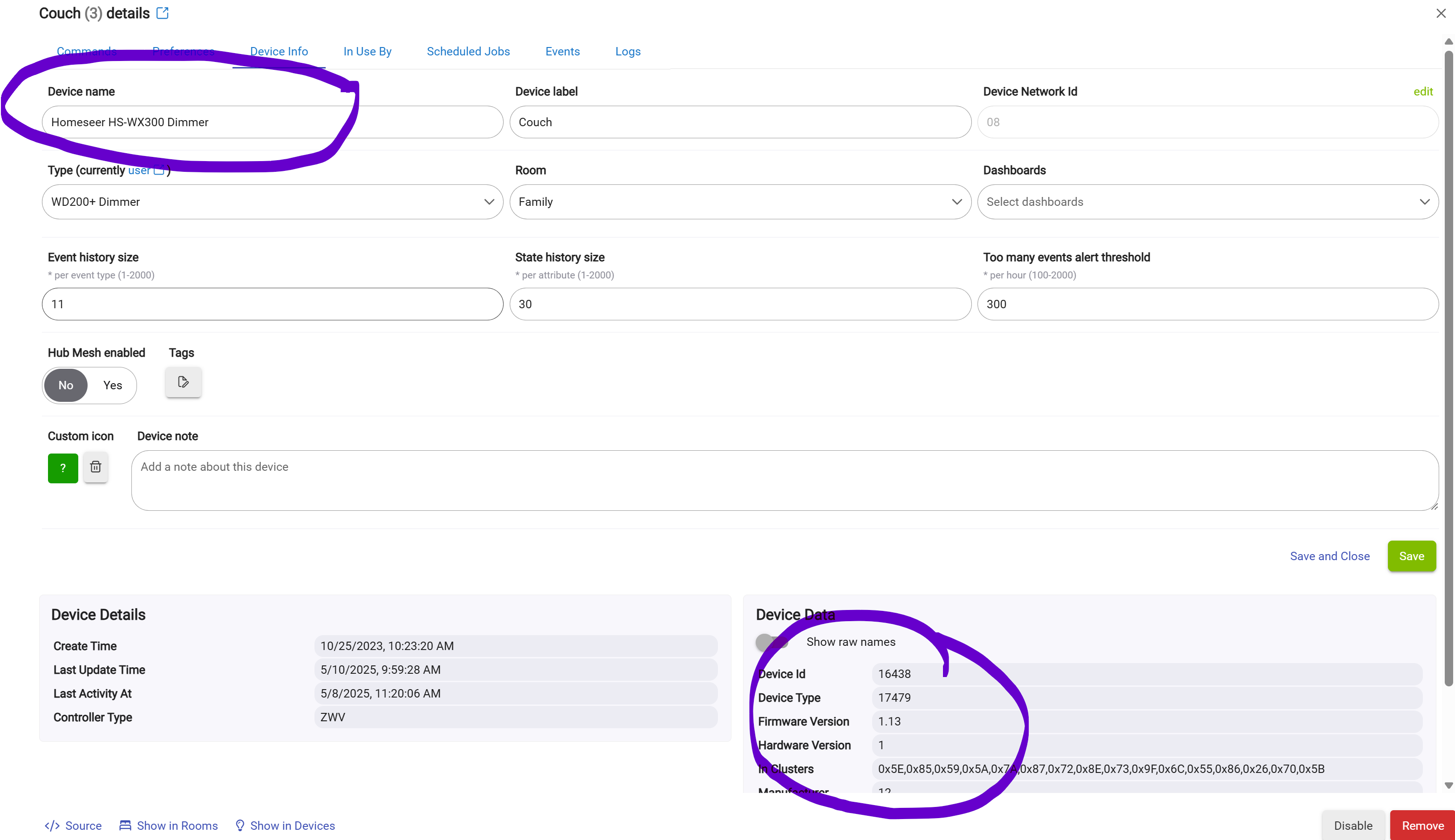

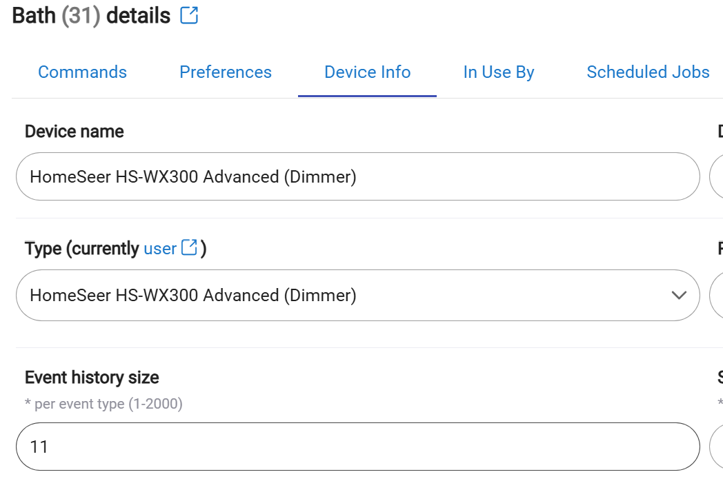

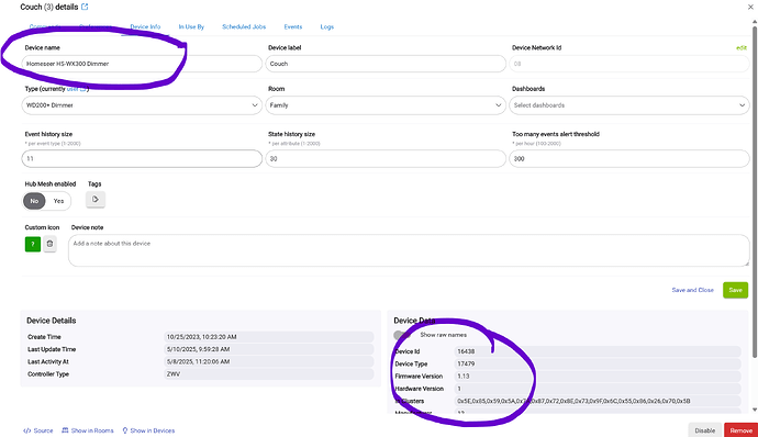

You still have not answered what driver you are using, which is a very important question for further troubleshooting. If it is mine, please enable debug logging and run the On or Off commands and see what gets written out to there. It won't be nothing at all unless you didn't run the command or don't have debug logging enabled, so I'm suspicious from the above where it seems there is the closest thing to to this I can find (but, again, maybe it's not this driver).
I’m sorry I thought I had posted screenshots of the driver. When I get home, I’ll do the rest of it. I think further up in the email chain and I may be confused, but I’ve already turned on debug and I get no output at all. That’s the reason Walding came up. The only time it logs a message when I turn it on and off from the wall.
I don’t have the exact name in front of me, but it’s the one that ends with advanced that parentheses I’m pretty sure it’s yours.
A screenshot of the driver name or UI doesn't really tell where it came from (or what the code is, which is ultimately the issue). My best guess is that is mine since everything I recognize should match. But:
This would not be the case with my driver if you have debug logging enabled as above.
So, without that, either you're using a different driver, don't have this enabled, or something else is wrong; without knowing more, particularly the first point, little useful troubleshooting can be done.

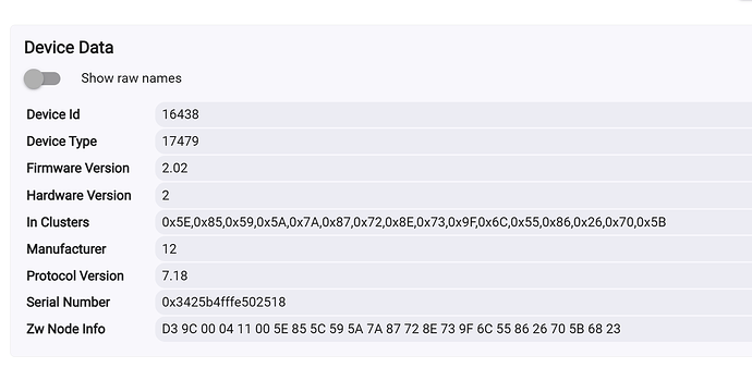

This is the driver I am using

So today I DID get out with debug on
The state of the switch never changes in the device output
Device
Thank you for the information. (A link to the driver is generally easier than the raw code here, but a tip if you do: using the "code" formatting button on the editing toolbar, or surronding the block with three backticks, ```, generally makes it easier to read.) That looks like my driver, which I suggested as a likely possibility and provided a link to above.
The output you provided also looks consistent with the debug logging I'd expect.

This may be a more global problem than your driver. When I did the JS upgrade...or let me at least say that "previously" since I can't swear to exactly when this changed...
Homeseer also see mys 200's a 300 now. I have no idea how...or if...this really impacts functionality.
HomeSeer or Hubitat?
If Hubitat,I don't see anything to suggest that in the screenshot above, except you're using a driver apparently written for the 200, which you would have had to have changed to (it's different from your screenshot above and the code you provided). The driver you're using is a key piece of this issue, and I wouldn't be surprised if you had problems for that reason.
The hardware type is version 1. It is a 200. That field USED to say 200. It now show it as 300. I can only "assume" that changed with the JS update...since out of all the things I looked at after the upgrade wasn't that. Maybe a version upgrade could do that too.
So a Hubitat issue ...not Homeseer. Do you have any idea if that is any more than a text field? IE - Does the hub use that in any way or depend on the driver...or both.
Between the two versions of these I have about 30 of them and are really familiar with them.
PS - Your driver is awesome and lets me control the LED's in rules with ease. Thanks!
I'm still confused what field you are talking about, as neither "300" nor "200" is anywhere outside your control in anything you've circled. A "hardware version" of "1" is also entirely plausible for this device -- that's always some integer value, normally unrelated to any marketing name the manufacturer may have for the device. (There are two generations, and it's possible the "WX300 R2" is hardware version 2, but I only have the original and don't know.) Some drivers uses this data in some way, but in most cases, it's unlikely to matter much, if it all (e.g., mine doesn't use anything here at all), but I still don't think I see anything odd.
I'm even more confused now, as you're saying you have a WD200 but put "300" in your topic title, were apparently using that driver above, but are now saying it's a "200"?
These devices are pretty similar, even their configuration parameters, to such an extent that some drivers could be interchangeable. But both the hub and my custom drivers have specific drivers for each, so it is important to be clear about what hardware you are using and what driver you're using. Unfortunately, the more answers I get to these questions, the more confusing things seem to get. :slight_smile:
EDIT: OK, nevermind, I re-read the post above and you have both but see "300" for the "200" models? That's just the "Device Name," which is set by the hub with the driver name upon inclusion. Apparently, that's what it matched with then. If you changed the driver, as you must have, the "Device Name" is just an artifact of this history. It's entirely within your control what you do with the Device Name after this, at least with Z-Wave devices, or you can set a Device Label to override the display name, as you also have.
EDIT 2: No, wait, I looked at the Device Data for the device you have using the WD200+ driver and that's definitely a WX300, as the Z-Wave device data matches. The WD200+ would have a device ID of 12342. So, back to confusion. :slight_smile: (Are you sure you didn't change a driver somewhere?)
