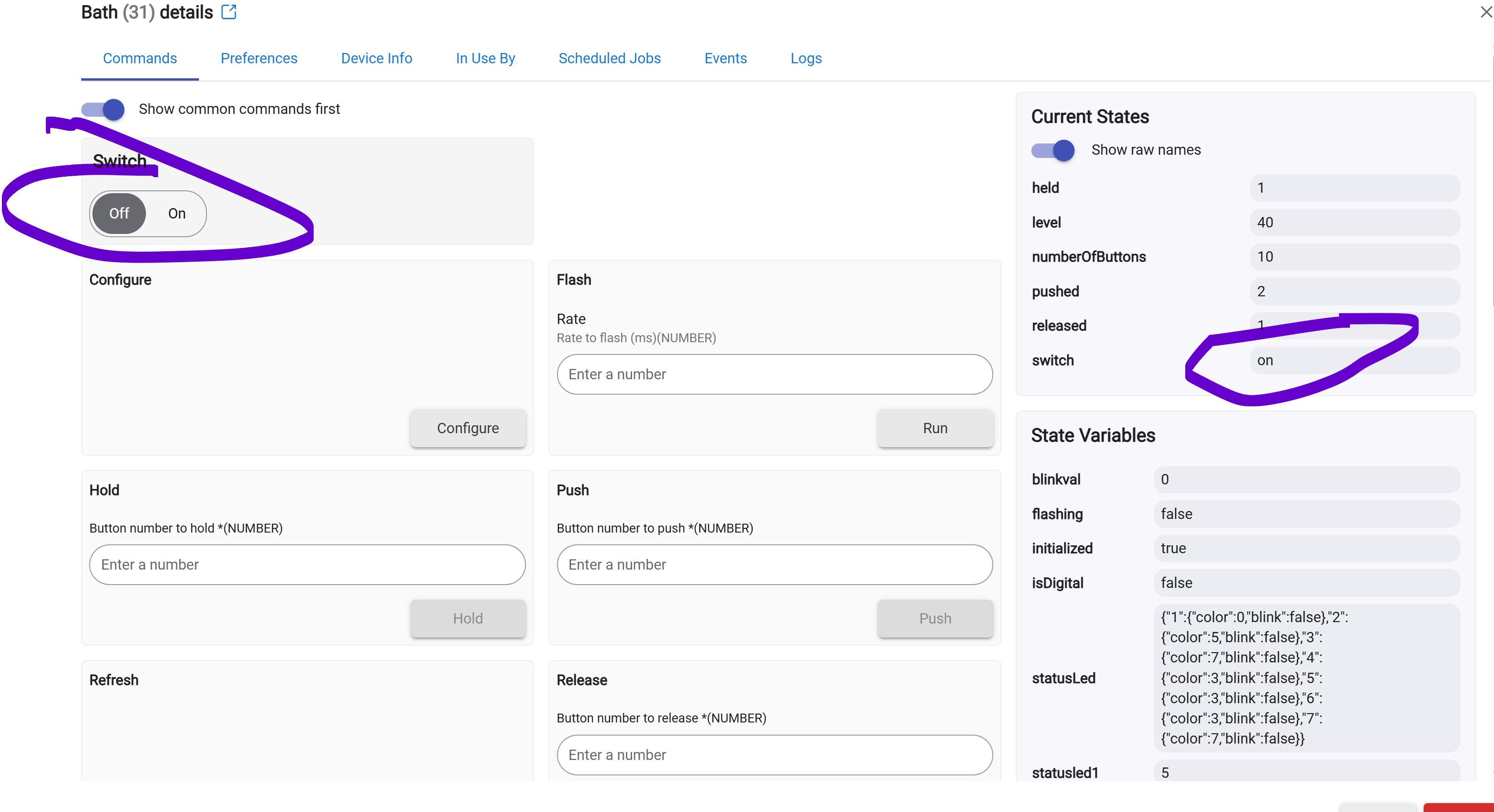

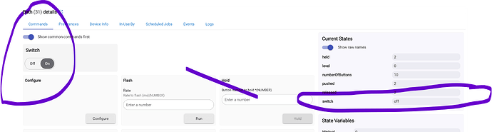

While the "button" on the left say ON...the "Current State"
Says OFF. From what I can tell this is actually the state the system thinks it's in.
"Current States" is what really matters. I wouldn't pay much attention to the top left in your screenshot; that's just the UI trying to be helpful in making a command you're likely to want to send easier to do (and something that should be fixed if it's a consistent problem, but not unlikely to be one related to the driver or Z-Wave JS or not). I'd start by making sure that the device is actually reporting like it's supposed to, which is what I'm seeing and which I thought was the original claim.
Part of the confusion is certainly my fault. I'm not taking the screenshots on the same devices. They are all acting up. I have all versions of HS switches. Somewhere I have some of the R1 300's...not sure if they are different ID's.

It's still not clear to me if the "status" you mean is just a possible UI glitch with that "Switch" box in commands or the actual "Current State" of the device, which is again the only thing that matters:
The "Events" tab here is really the authoritative source, but unless something in your browser is broken, "Current States" normally updates in real-time, too, so it's normally just as good if you're watching -- but it might be good to check.
If the "Current State" value (again all that matters for now) is not updating in response to digital (commands from this page) or physical (from the paddle) manipulation, enabling debug logging and providing the output of Logs when you do these things would be helpful to see. Make sure you are using my driver (it is apparent from your screenshot that some other driver was in use at at least some point, as mine does not use one of those state variables).

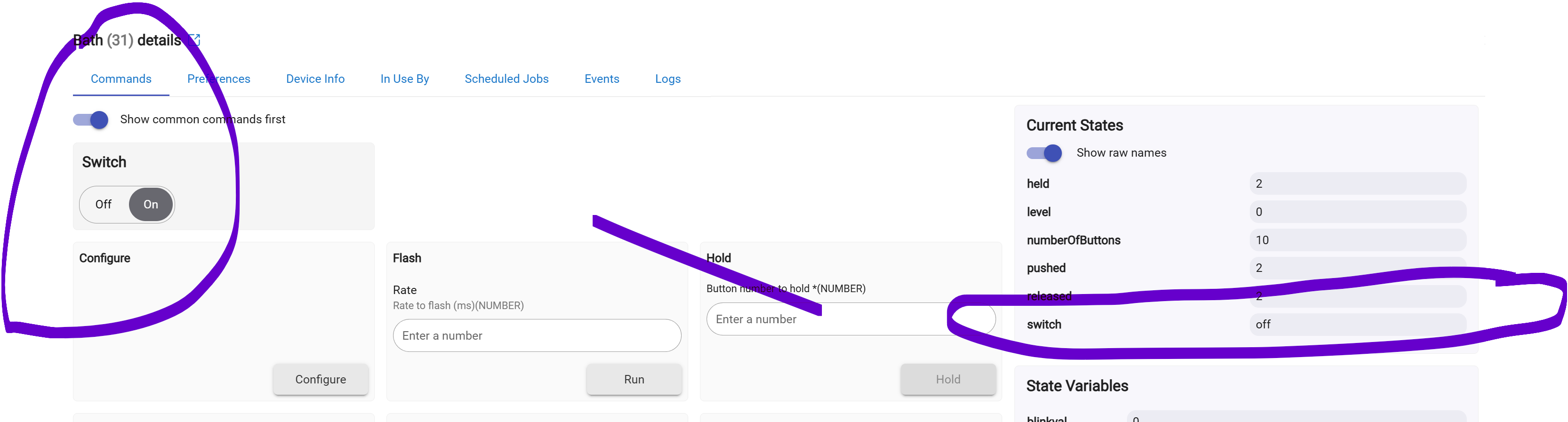

You helped me narrow this down...I think. I have an R1. It works perfectly as the state updates.
ANY any of my R2's weirdly turn on and off in the real world...never update state...and the weird part.
EVEN WHILE THE BULB TURNS ON AND OFF THERE ARE ZERO LOG ENTRIES.
This is an R2 Issue only. Thanks for pointing out your test switch was a R1.

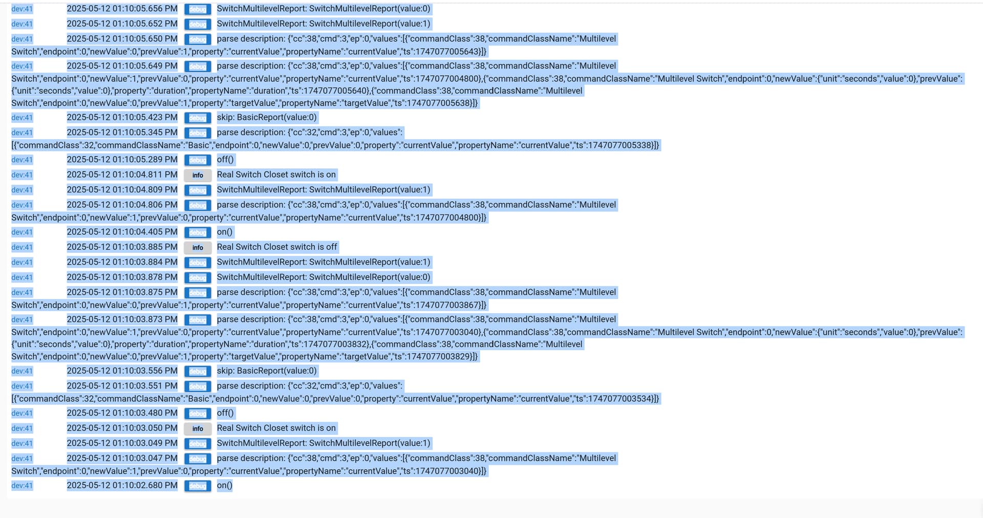

I'm assuming debug logging was on when you did this? And does the stock driver show anything different?
Settings > Z-Wave Details > Z-Wave Logs would be another place you can check (if you're using Z-Wave JS, as you are; it's not very informative otherwise), ideally looking for just entries that say something about your (hex) node ID while you believe a report should be coming in. Otherwise, staff may need to turn up Z-Wave logging on your hub to see if they can figure anything out. I don't have an R2, and it looks like they're sold out everywhere (with likely no plans to replace them?), so I probably won't be much help.

2025-05-12 02:42:10.700 PM|DRIVER « [RES] [SendDataBridge] - was sent: true
2025-05-12 02:42:10.699 PM|SERIAL » [ACK] (0x06)
2025-05-12 02:42:10.697 PM|SERIAL « 0x010401a90152 (6 bytes)
2025-05-12 02:42:10.694 PM|SERIAL « [ACK] (0x06)
2025-05-12 02:42:10.690 PM|DRIVER » [Node 225] [REQ] [SendDataBridge] - │ source node id: 1 - │ transmit options: 0x25 - │ callback id: 26 - └─[SupervisionCCGet] - │ session id: 4 - │ request updates: true - └─[BasicCCSet] - target value: 0
2025-05-12 02:42:10.689 PM|SERIAL » 0x011500a9000100e1076c01840320010025000000001a50 (23 bytes)
2025-05-12 02:42:10.687 PM|DRIVER one or more queues busy
2025-05-12 02:42:09.051 PM|DRIVER all queues idle
2025-05-12 02:42:09.048 PM|DRIVER « [RES] [GetBackgroundRSSI] - channel 0: -101 dBm - channel 1: -103 dBm - channel 2: -103 dBm - channel 3: -97 dBm
2025-05-12 02:42:09.046 PM|SERIAL » [ACK] (0x06)
2025-05-12 02:42:09.044 PM|SERIAL « 0x0107013b9b99999fc6 (9 bytes)
2025-05-12 02:42:09.042 PM|SERIAL « [ACK] (0x06)
2025-05-12 02:42:09.039 PM|DRIVER » [REQ] [GetBackgroundRSSI]
2025-05-12 02:42:09.037 PM|SERIAL » 0x0103003bc7 (5 bytes)
2025-05-12 02:42:09.032 PM|DRIVER one or more queues busy
