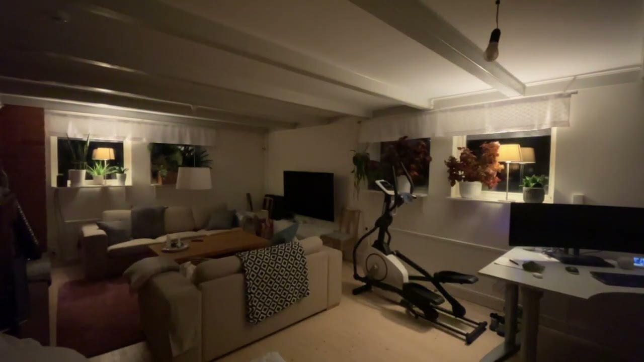

Did a test between the integrated and Maker API. There is no real difference in speed between the two integrations. :slight_smile:
In the video clip, the right light is still on Maker API/Homebridge and the left is the new Hubitat HomeKit app.
