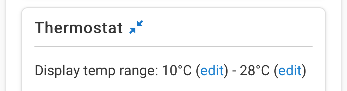

In the HomeKit integration app, scroll down to the thermostat section:
You can edit the temperature range but it’s blocked at minimum 10C. You cannot enter a value below 10C in the app.
I admit I only ever touched the max setting. You’re right, doesn’t seem to let one set it lower than 10. @gopher.ny

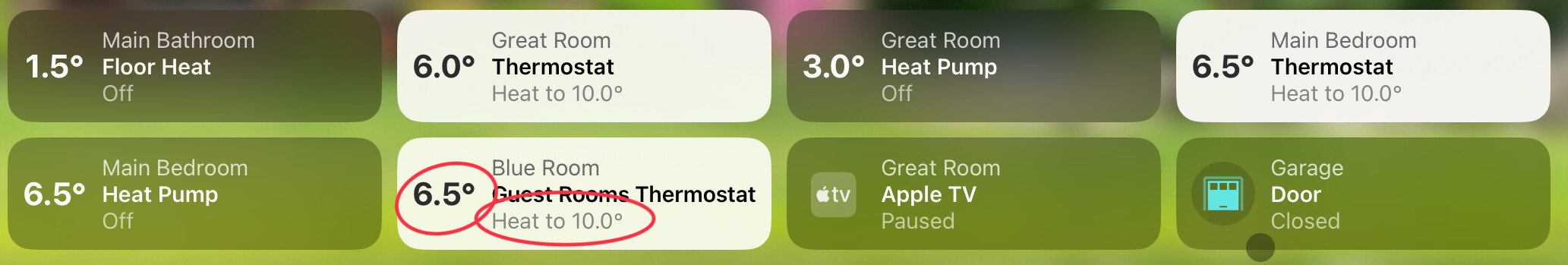

I wonder if 10 is a limit in HomeKit/Home app itself (I just assumed). I have my thermostats in my country house integrated to HomeKit with Homebridge, and the lowest setting with Homebridge is also 10 in the Home app. I keep my thermostats set at 6 (via Hubitat automations) when I’m in the city, and I just assume it’s set correctly if the temperature displays around 6. Will change them to the built-in integration if this update allows them to go lower.

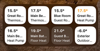

And for those who are wondering, creating a virtual "Outdoor Thermostat" and writing my outdoor temperature at home to it was the only way I could find to display the outdoor temperature in a HomeKit widget on the homepage of my iPad as shown below. (You can't select a temperature/temperature sensor as a device in a widget.)
