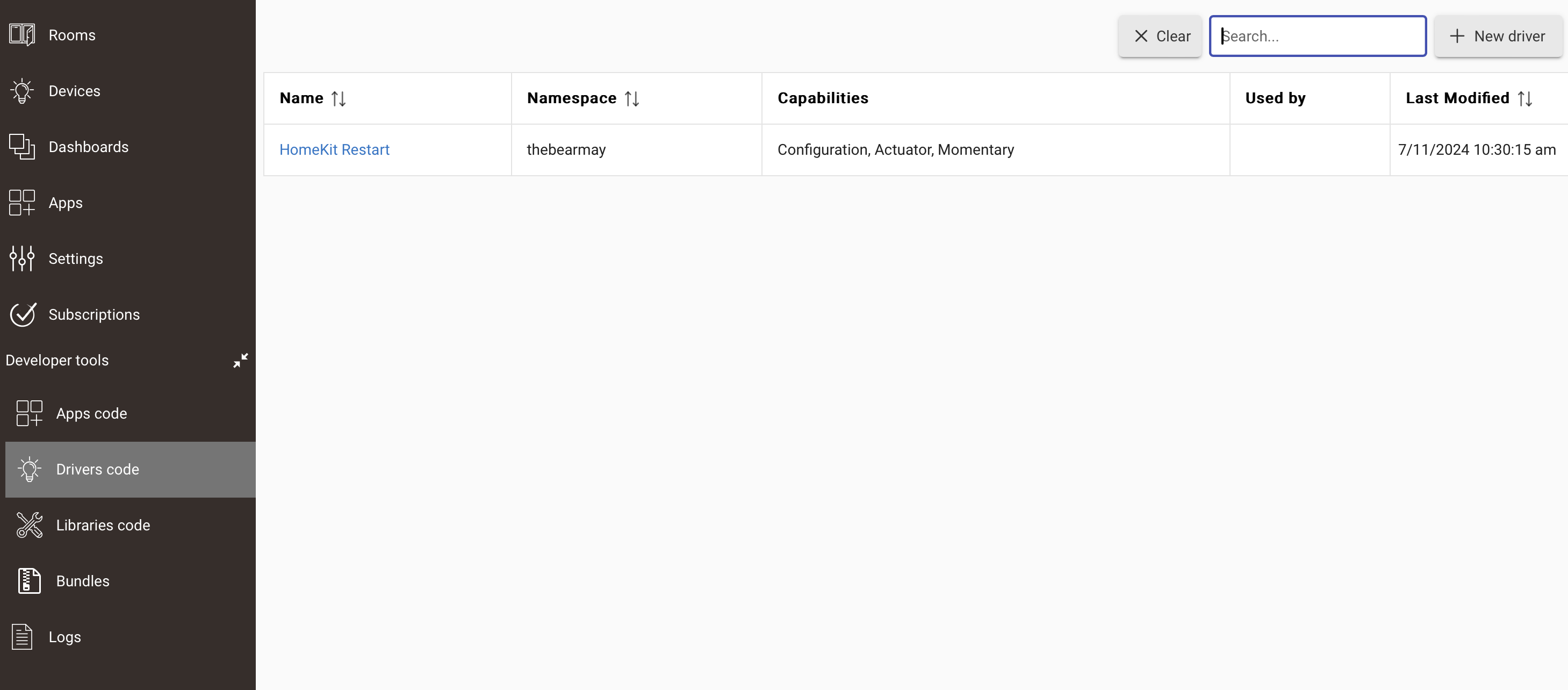

I am still trying to figure out how to install the rule. I was able to get the driver installed.

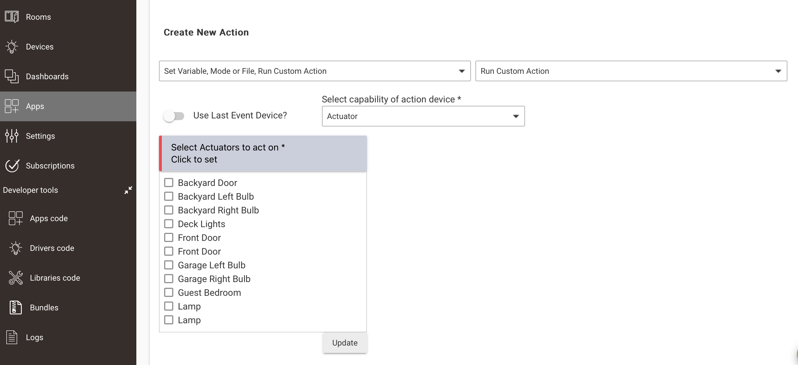

However, when I try to configure the rule and select Actuator I don't see Home Kit Service Restart listed.
I have tried everything.

Did you actually install the device from GitHub? It’s a driver and you can call it whatever you like. Once it’s installed, then RM can use it.

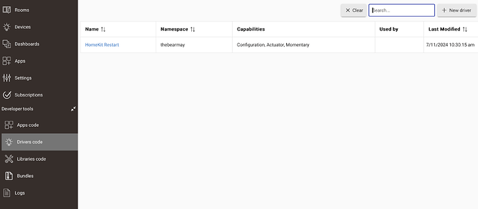

Yes, I installed the driver code from GitHub. It looks like it should be working based off the screenshot but its still not showing up in the menu,
That is Step 1.
Step 2 would be to use that Driver to create a Device. Only once a device is created, will it show up so Rule Machine can use it.

I tried doing that and I am still not able to select device in the variables list.
I tried running the device and it doesnt seem to be working. I am not sure where I went wrong.. I am guessing I am doing something wrong when setting up the virtual device.
You need to add an action that invokes the device you added.
Someone posted the steps on how to setup an actuator action.

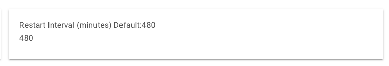

I can't make sense of the Restart Interval in the device prefs. I'm trying to avoid invoking a process that creates child processes, seems like a memory leak waiting to happen. I guess I just don't know enough about how the actuator logic works.
