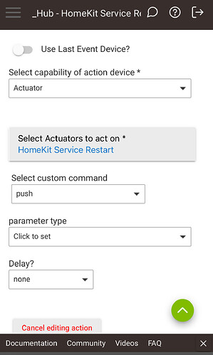

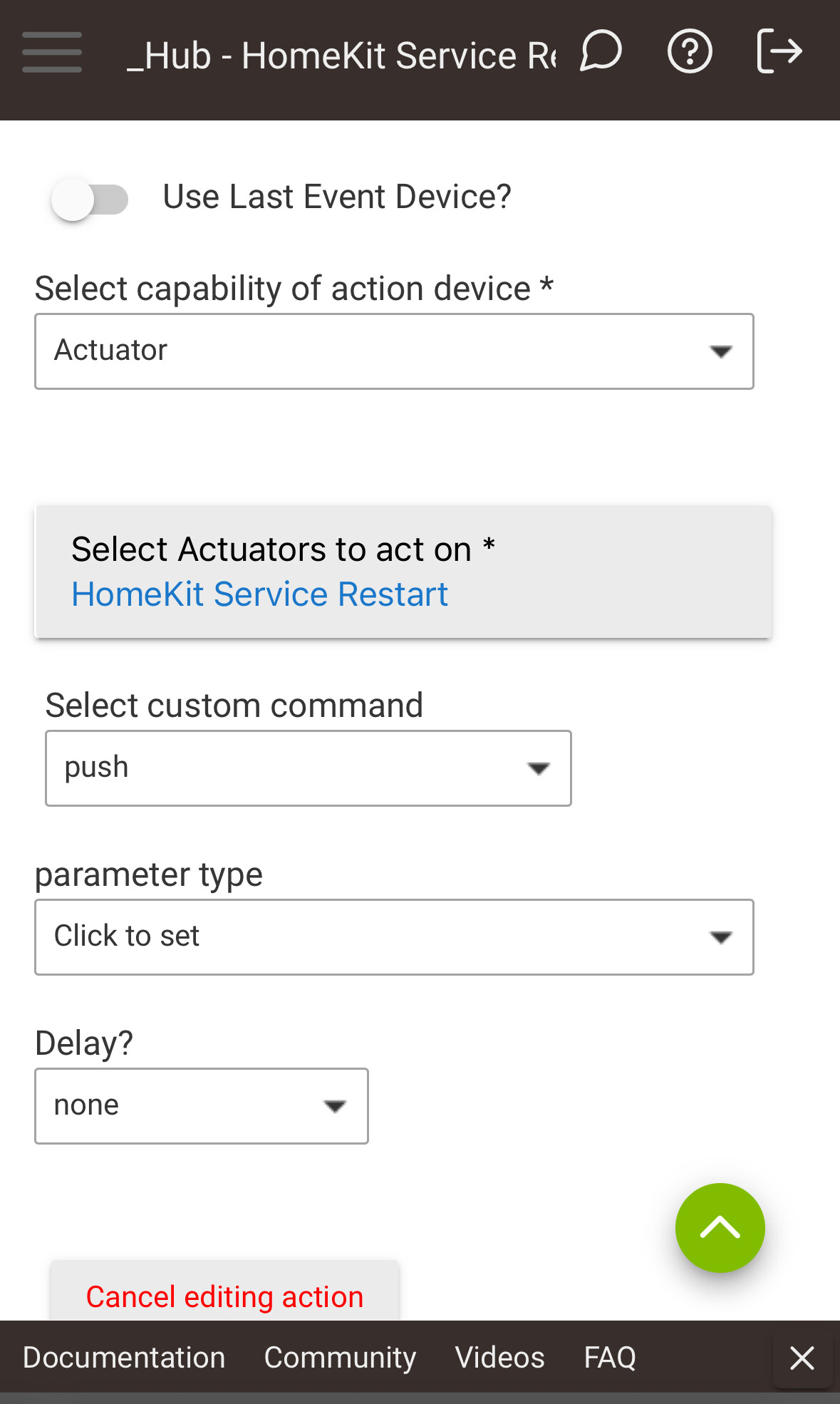

Hi @dJOS,
I am having the same problems and I am attempting to use your fix and mirror what you have.
That being said I am not seeing anything listed under actions that would allow me to use push() on HomeKit Restart Service.
Did you add a virtual switch to make that appear?
Also under the local variables I am not showing a device in the drop down for the type and the closest thing I was able to get was string.
I am clearly doing something wrong and am new to the habitat/smart home world
Thanks!
The button device type is actuator.
Just use the “Run custom action” option Rule Machine.
