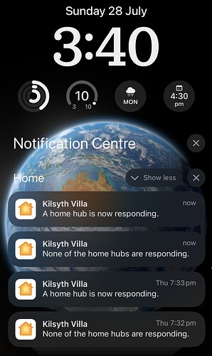

@gopher.ny I’m still seeing random ā€œhubs are not respondingā€ notifications every few days on the current HE version. 10 seconds later I’ll usually get a notification that they are responding again.
Unfortunately I can’t tell which of my 2 hubs are behind this.
Curious about how you got the reports?
I’m pretty sure those notifications have nothing to do with the Hubitat hub. Your Apple hub has lost internet access. To verify disconnect your WAN cable from your cable modem and wait 10 to 15 minutes and you should get the same notification.
….and turn off WiFi on your phone so that it is cellular only. (Or go take a drive.)
Those are from the Apple Home app.
I was home both times - I have a gigabit fibre internet connection with a wifi 6e mesh network.
However, the description is that a ā€œhubā€ lost connectivity, so you are probably correct that it wasn’t Hubitat - I forgot HomeKit describes them as bridges.
The Home Settings page of the Home App has "Home Hubs & Bridges" and it then splits into Home Hubs and another section for bridges. I'm agreeing that "Hub" is expecting a bit much for people to keep up with the nuances of terminology.
