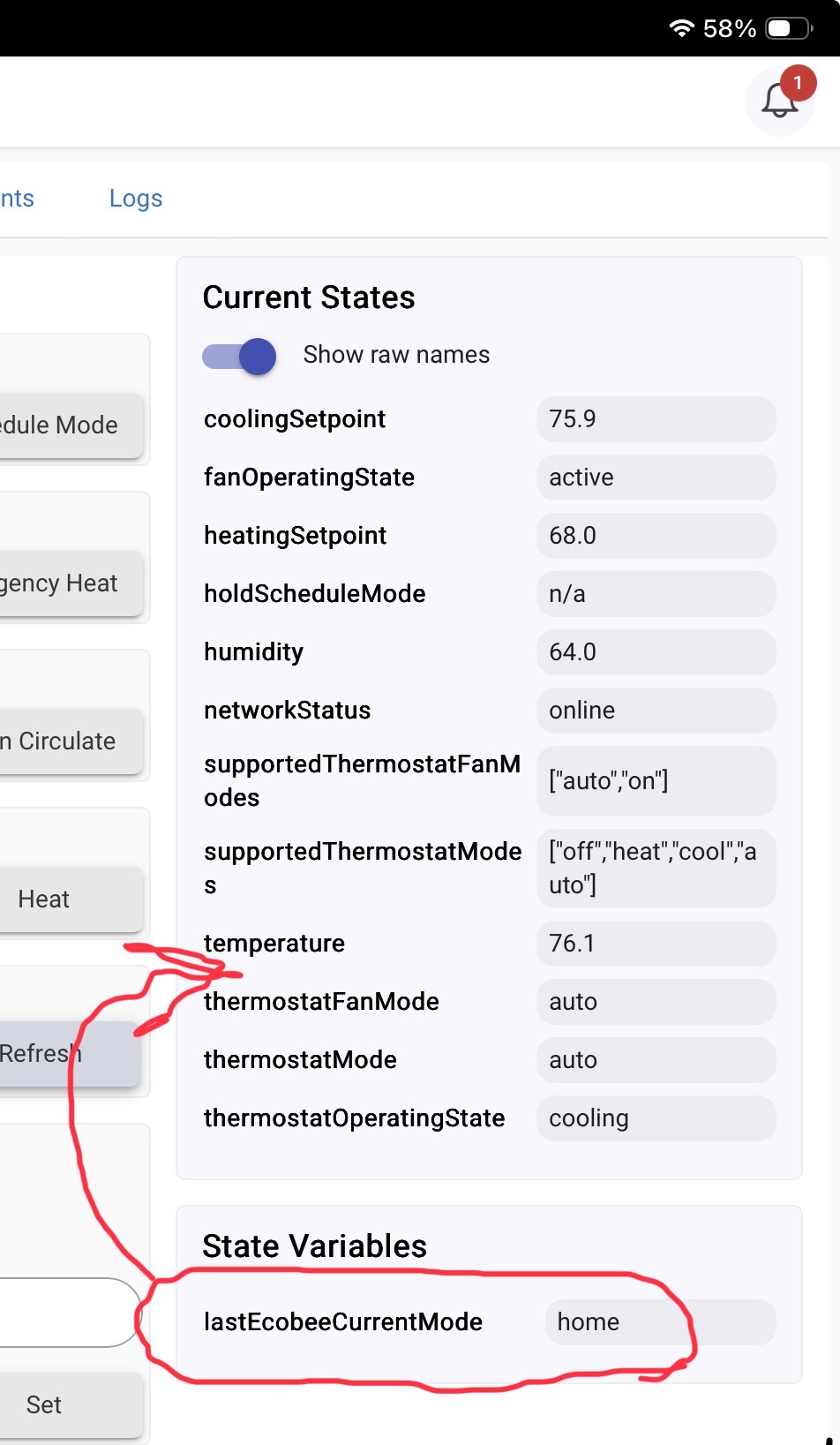

Any possibility of moving the “lastEcobeeCurrentMode” up into Current States so Rule Machine can access it?

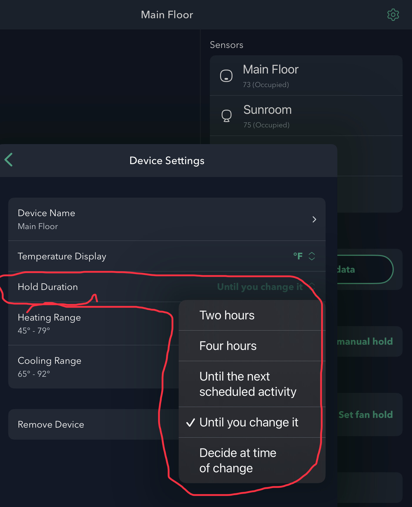

How does the below setting influence these actions from HE?
  1. Changing a set point value(s) (i.e., setting a manual hold)
  2. Setting a hold of Home/Sleep/Away

The HE implementation follows the preference settings shown in my image above. (Both of the last two appear to be treated as permanent hold.)

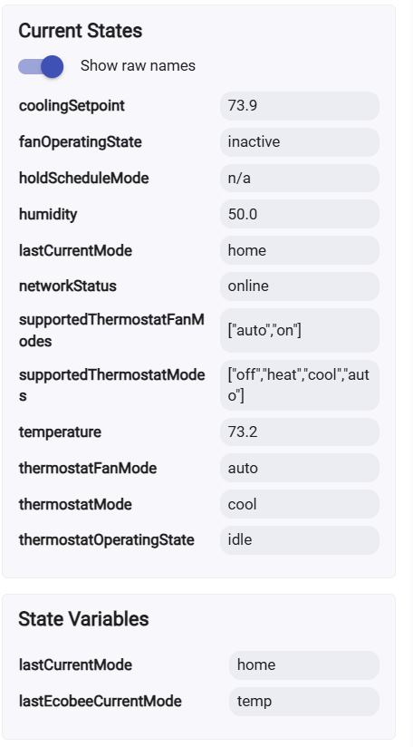

But I will get lastEcobeeCurrentMode populated as a current state in the next build.
@gopher.ny Did I miss this in announcements? Or still coming?
It's in the state variables but not in the Current States (attributes) yet:

It's called "lastCurrentMode", and it's under current states now. I'll disappear it from the state variables at some point.

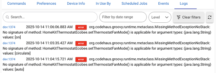

The “Set thermostat fan mode” from command page fails with:

  3. The lastCurrentMode was always the current mode so was useless for returning unless it was saved in a variable. It was usually “temp” which was not very useful.
