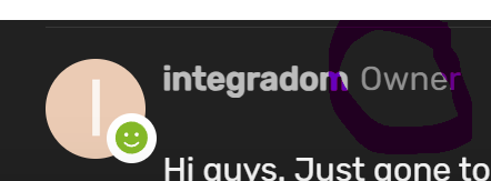

Hi guys. Just gone to "hub owners" to join but my 2 only neurons are trying to find out how to do it, (as it seems, required to post links to provide you with further info). Maybe after a good sleep I'll be able to figure it out.
In the mean time, it seems you are focused on zigbee/zwave tech, devices that aren't exactly my favorit habitat (I've been using mobile phones for too long, prefer cabled tech to wireless). Still fell I can be usefull, eventually due to 25 years of AV/media system integration?
Should be pretty simple, make sure once you register your new Hubitat HE hub you're logged in with the same credentials.
Edit: Looks you're sorted. :slight_smile:
