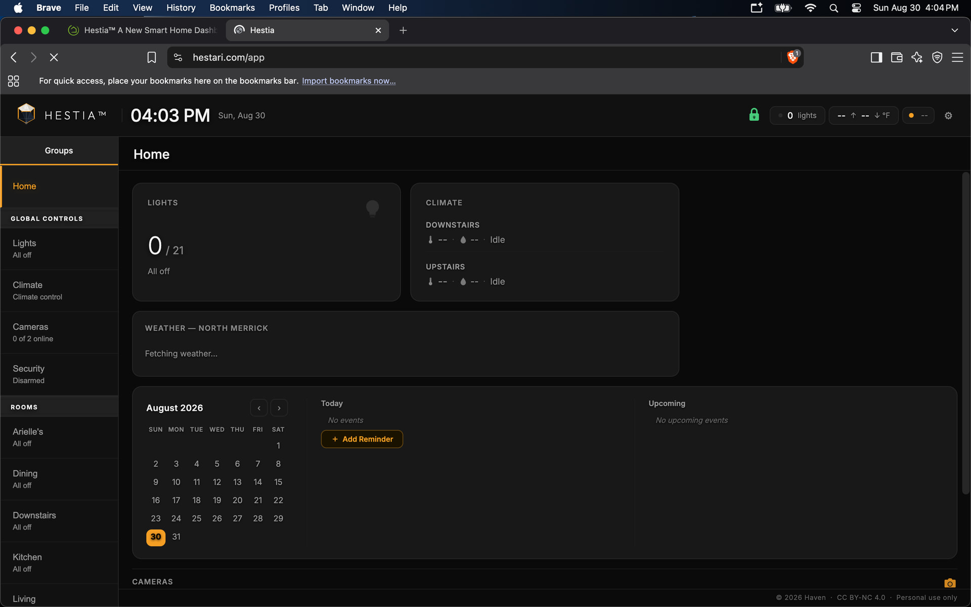

@jkudave - are you still having issues with hestari?
Yes. Now the page just seems to spin forever and not everything loads. See below. It was working previously, minus the cameras.
Still not working when hub security is enabled.
