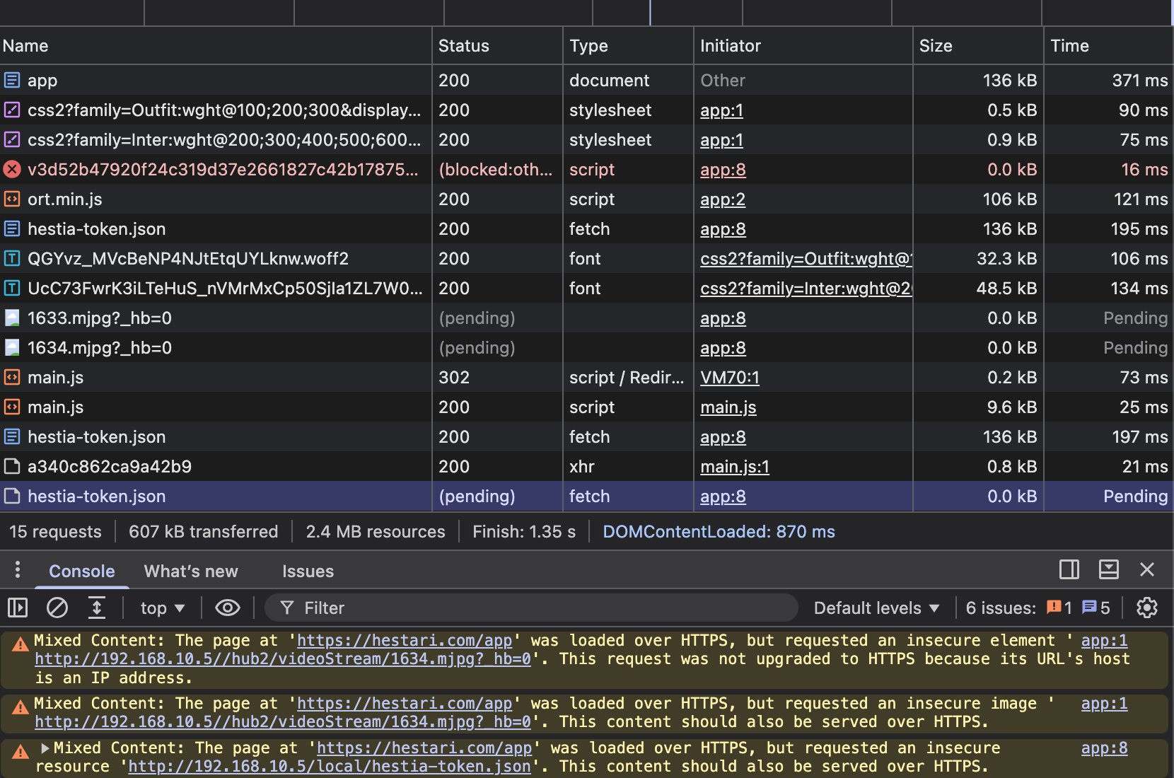

You can somewhat see it spinning here:

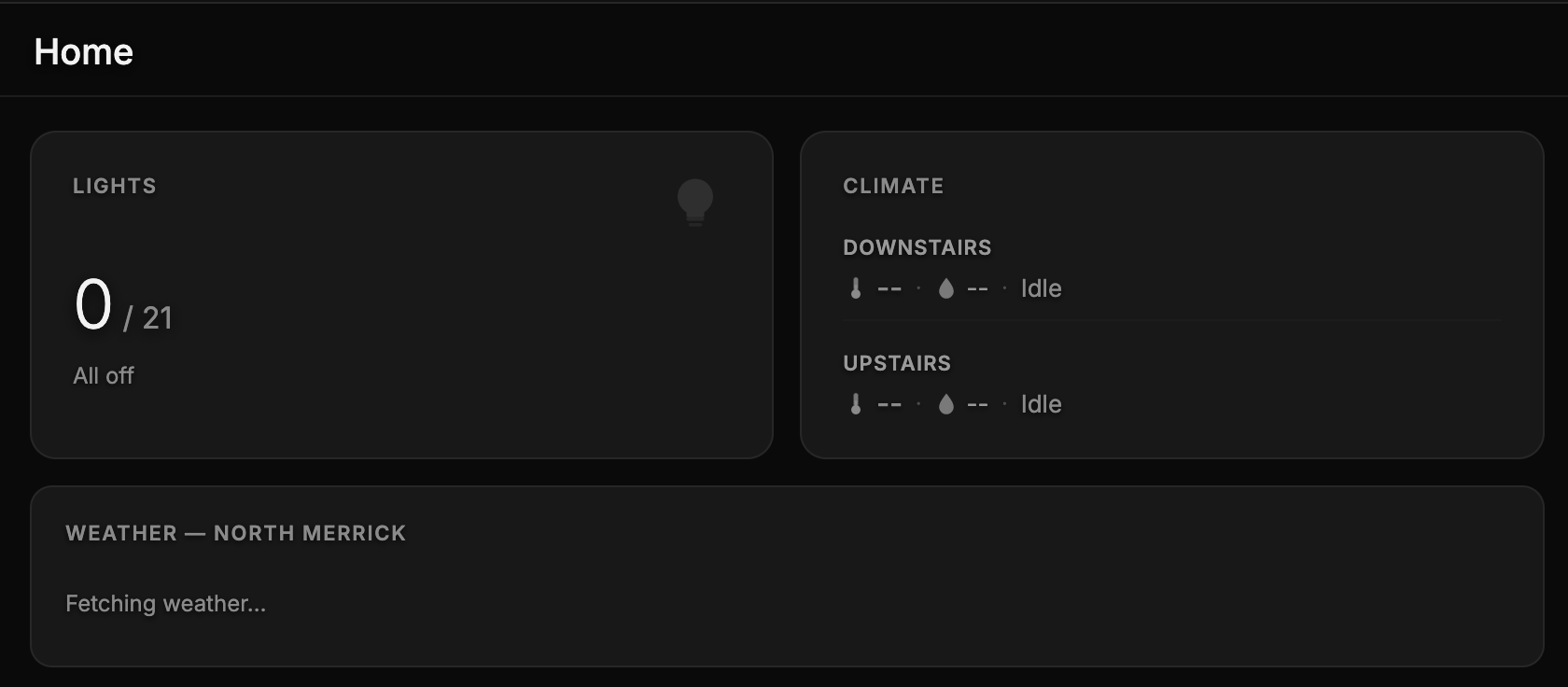

And you can see that things are definitely not loading here:
I definitely have lights on but the above shows 0. T-stats and weather haven't loaded either.

@jkudave — those screenshots were exactly what I needed, thank you. Found it.
Your DevTools screenshot showed a request to /local/hestia-token.json sitting at "(pending)" forever, with a Mixed Content warning right next to it. That's the actual cause: hestari.com loads over HTTPS, but that request goes out to your hub's plain http:// address. Browsers are supposed to block that kind of request, but in some cases — yours included, it turns out — they don't reject it quickly, they just let it hang indefinitely instead of failing. Hestia was waiting on that one request to finish before anything else on the page could load, with no timeout, so it just sat there forever. That's why the shell of the page could still show up while lights, thermostats, and weather all stayed stuck at nothing. Not a Hub Login Security thing after all — that was my earlier guess and it was wrong.
Fix is live now: every request like that gets a timeout, so if one hangs, Hestia just moves on and keeps loading everything else instead of freezing.
Could you give it a clean retest?
