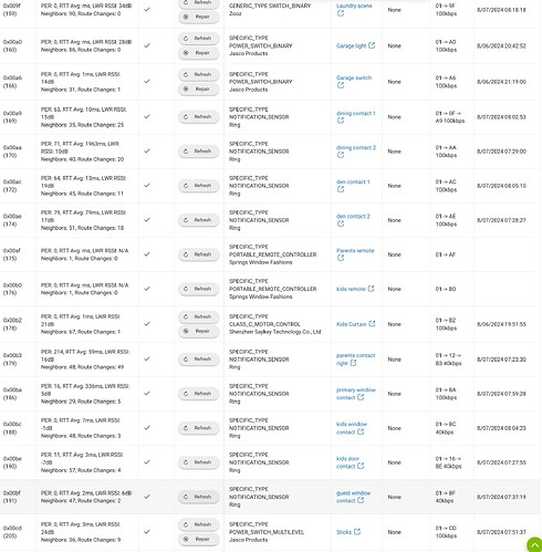

Hi sorry are you still looking for help? I had this flagged but had not had a chance to review the details yet.
Do you know how long since last reboot when you took those screenshots?

Last reboot was shortly after this, updated to 2.3.9.166
I am interested in how long the hub had been running since the last reboot when you took those screenshots. The uptime (at time of screenshot). If you remember.
The stats reset when you reboot, so the difference between 1 hour and 24 hours+ means a lot for some of the stats.
Oh, got it. At least 3-4 days (and up to a week) since I was monitoring if removing s2 security from those ring devices would help - it didn’t.

The screenshots you posted above everything looks really good and has quick response times. The only thing that looks problematic is the shades but if they are battery they are probably FLiRS which may actually be the entire issue. FLiRS devices will crush the mesh when you try to send them commands :frowning:. Its not actually the device, it is the hub, sending the FLiRS wake up beam.
