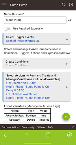

I have a rule that I disabled. How can I tell if it’s been enabled? I unchecked disable but it didn’t run immediately. Here is a screenshot of the rule.
How did you disable it? Using the checkbox in the Apps page UI? (That's only thing literally worded "disable" or "enable," but some people loosely use this term to describe similar app-specific option like pausing the rule rather than this platform-level feature -- so just making sure.)
If so, the app is definitely not disabled because you can get into it. Disabling an app prevents all app code from running, including the code that displays the app UI. You'd also still see the disabled checkbox on the Apps page (if you have the "Disable" column visible; see Apps Page | Hubitat Documentation).
Disabling an app per se will not make anything happen. Apps do not get any notifications when they are disabled or enabled. Your rule looks like it will only run at 25 minutes after the hour. What time did you observe this behavior at? Did you not see anything happen at 25 after? (If you're in a time zone that is in even hours away from UTC, that should be soon but not likely when you posted.) If you still see anything unexpected, enable all logging for your rule and see what Logs say, per How to Troubleshoot Apps or Devices | Hubitat Documentation.

If you want to manually run the actions once, sure. Otherwise, from your rule, it should run on its own at 25 minutes after the hour, per my description above. (Again, re-enabling the rule won't make the actions just run, even if it missed a previous run time--but the schedule should still be there for the future.)

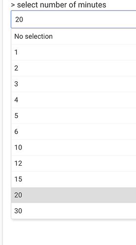

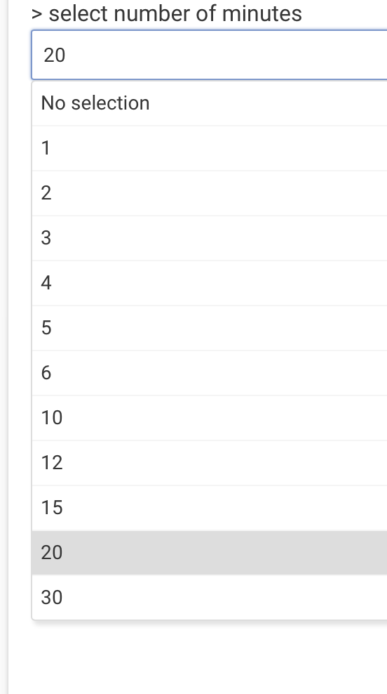

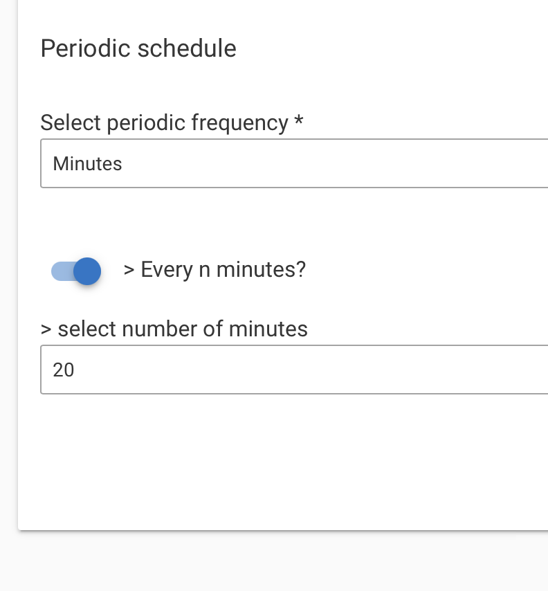

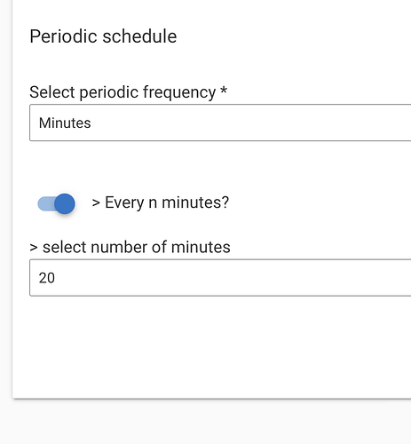

I think you want to select this option for it to run every x minutes. You have it running at 25 minutes after the hour, so 2:25, 3:25, 4:25. Unfortunately, this option does not include 25 minutes.
