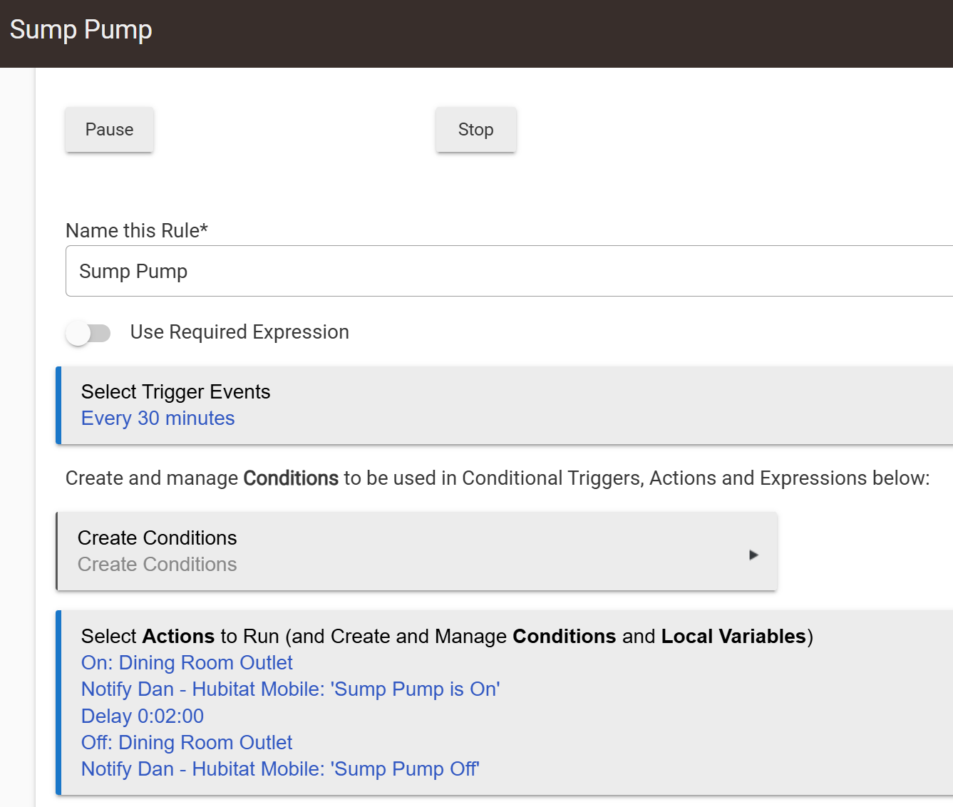

What I am trying to do is turn on a sump pump every 25 minutes, run it for 120 seconds and then turn it off. Also, I need to be notified when it turns on and turns off via some message capability. I have my phone registered. I would be okay with a push to my iPhone. I just need to get this up and running before it rains again. I assume Rule Machine.
I am trying to get a simple answer and everyone is helpful but I am getting overwhelmed by the complexity of the Hubitat.
Can someone who knows how this can be done please help?

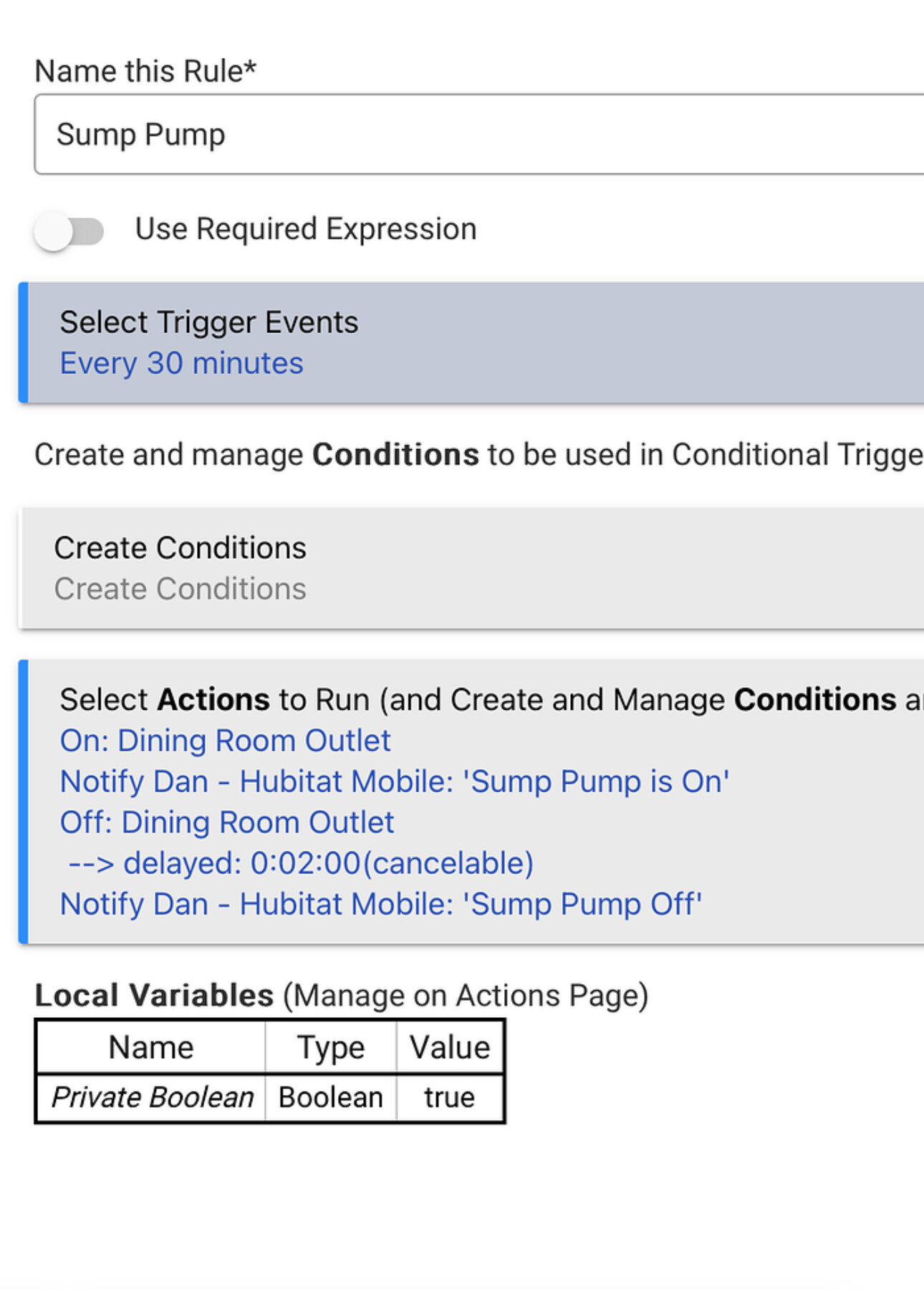

How about something like this? This was created in Rule Machine (RM). It is going to run every 30 minutes (limitation of RM's Periodic Trigger), but it should be a decent start. Just be aware, it is going to run ALL THE TIME. The notifications to your phone will become very annoying very quickly.
Revised per @hubitrep's suggestion.

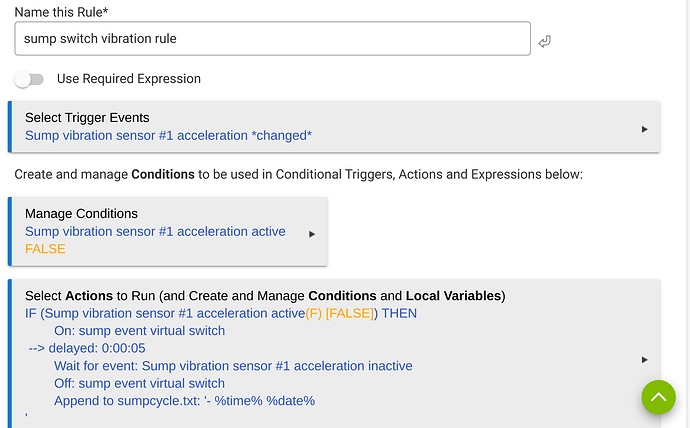

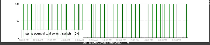

I use a typical float switch to activate the pump and a vibration sensor taped to the discharge pipe. This rule turns on/off a virtual switch when it cycles. You can use that switch to created a notification or log. Additionally I use a webCoRE graph to visualize the activity. You can tell it's been raining here.

The 'off' notification will be sent immediately after the 'on'. A Delay or Wait for event - time elapsed is needed instead of a delayed action.
Good point!

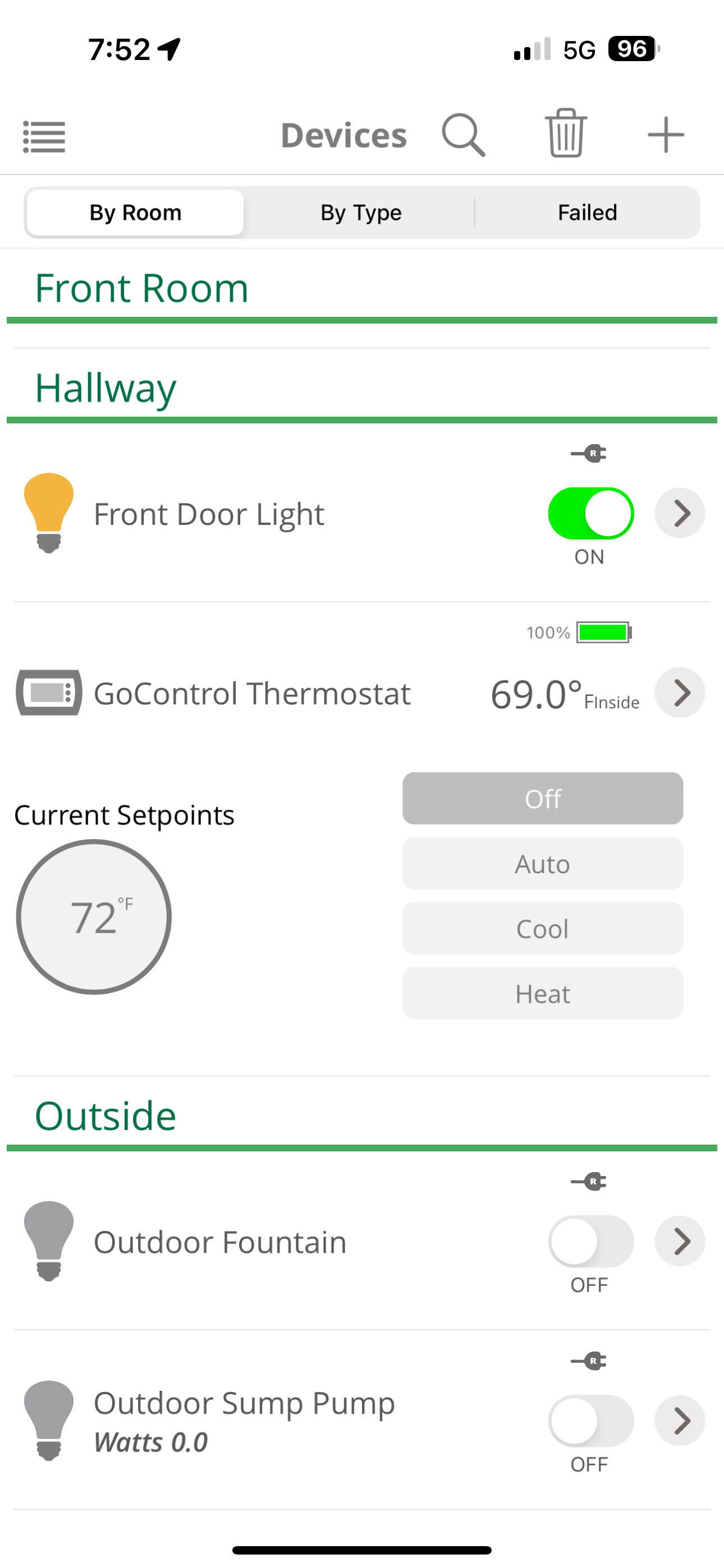

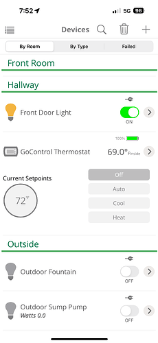

I have a Minoston that shows me in Watts if it’s on with Vera at the bottom of the attached. Will it show up like in Hubitat?
Where does that go? Thanks

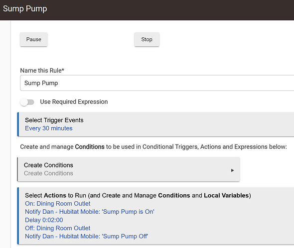

Instead of the delayed command in this example?
Here you go. This would definitely work better, per @hubitrep's advice.
Again, this is just a starting point to help you become more familiar with Hubitat.

That works!! Thanks!!
I did not realize that Every 30 minutes means 30 minutes after the hour. I think I was looking for periodic.
