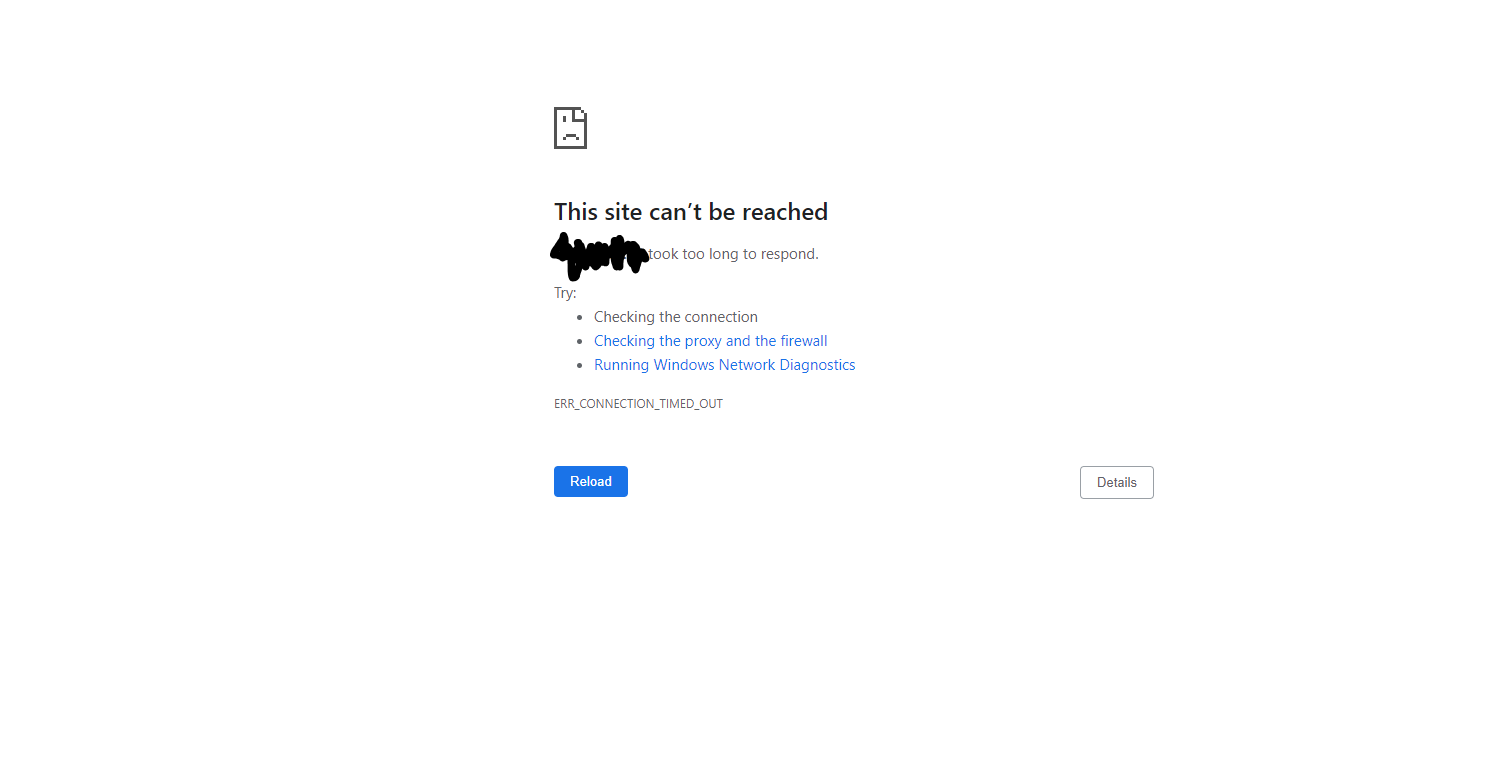

I can't connect to my hub the automations work just fine but I can't connect to my hub I tried rebooting it but it didn't work
What do you usually enter into your browser address bar to reach the hub?
I’m guessing you enter its IP address based on your redacted screenshot.
So is it possible the hub’s IP address changed? If that’s the issue, then rebooting wouldn’t help, because your router may assign new IP addresses when connected devices reboot if you haven’t assigned a DHCP reservation.
If you try browsing to http://findmyhub.hubitat.com/ does that find it?

I agree it’s most likely an IP network-related issue of one kind or another, interfering with access to the hub UI.
