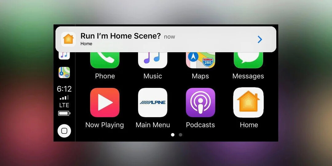

Ok, I got it setup so that I can Siri control my devices in carplay....but I was under the impression that I would have an actual "Home" app on my carplay screen like the image below (bottom left) that in turn woud allow me to click devices rather than use siri. Is this a fake image and the "home" app will never exist like this?
Tap the little square with a circle around it icon in the bottom left, until you go to a split screen view. Usually it puts nav on the left and then music and other stuff on the right. In this view if I am near my home the garage door automatically shows up on the right side pane where you can tap to open/close it. I assume it relies on having your home location set correctly on your phone as well.
We dont actually use it because there is also a button built into the car headliner.
No, there's not a Home app in CarPlay like what's shown in that picture.
Maybe there was at some point (I just started using CarPlay myself a year ago), but there isn't one today.

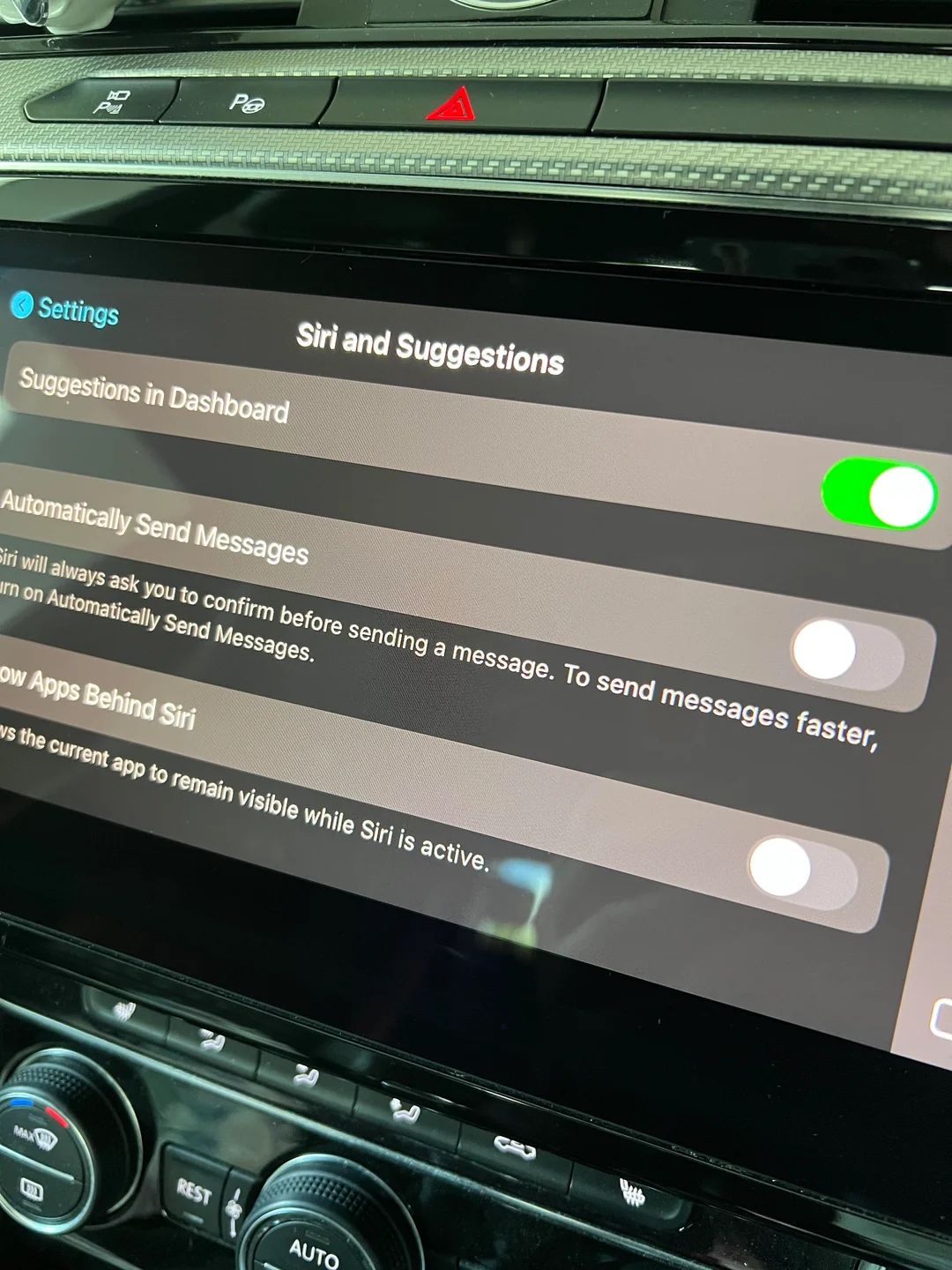

I had this problem for years and only recently found the answer. I am not near my car atm so this is from memory.
  1. You HAVE to do this while your iPhone is connected to your head unit.
  2. Go to settings on the CarPlay screen.
  3. Turn on Siri Suggestions on Dashboard.
  4. Profit. :smiley:
I get the garage icon in Split View like Jeff.
Never noticed if it comes and goes. (I haven’t driven that car more than 10 mile from home lately.)
If I select it and press the control it opens/closes.
(Haven’t tried touching the screen.)
(not my picture)
