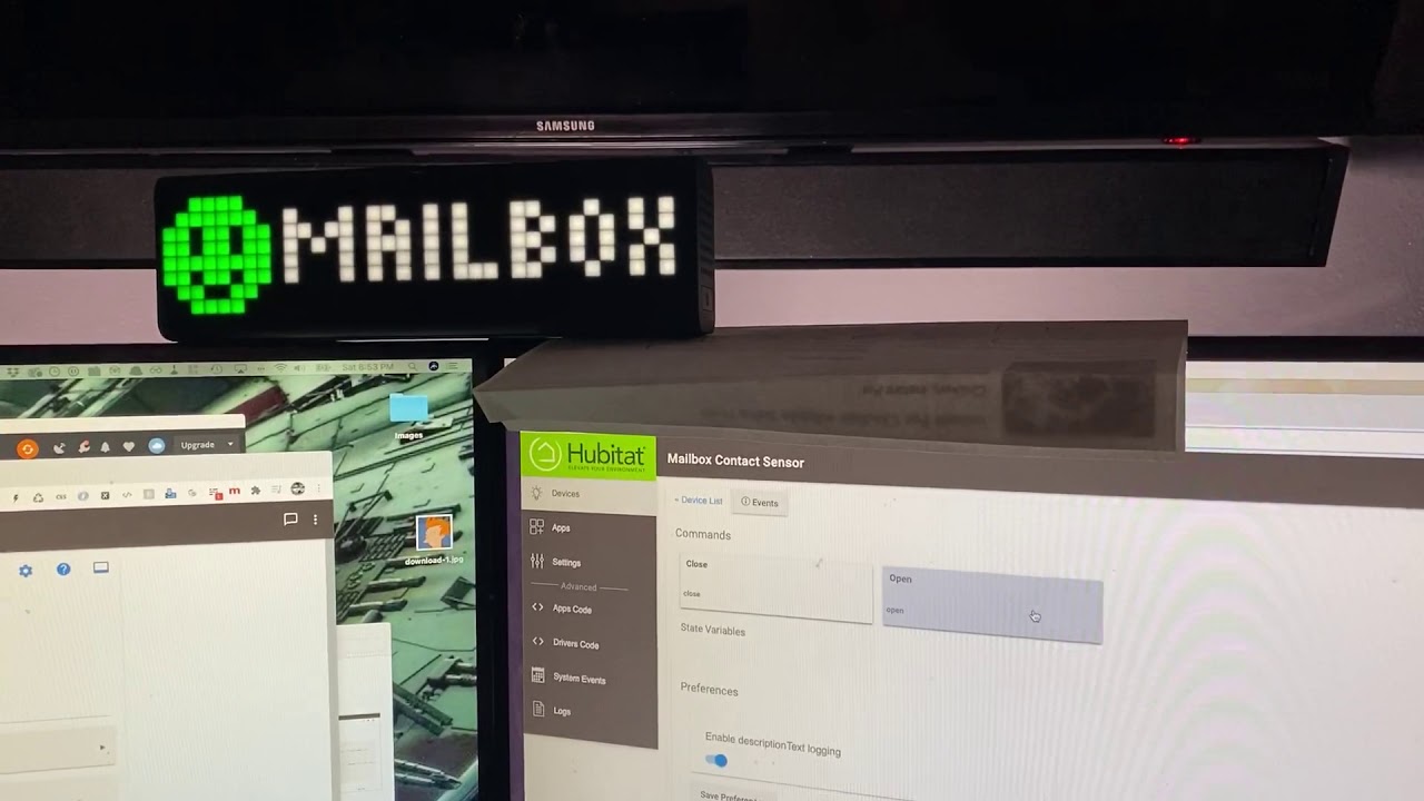

That LaMetric clock looks really cool! Man, if that was easily integrated into the HE world, I would probably have bought it instantly. Very appealing!

The LaMetric has an easy to use REST API, there shouldn’t be anything special needed to integrate it with Hubitat directly using the HTTP request method.
I’ve got one and love it for exact needs posted above (mailbox, etc) and send messages to it from Node-RED. I was using a palette (essentially a driver) but lately moved to raw HTTP calls as it’s way more flexible. There is absolutely no reason why one wouldn’t be able to duplicate that from Rule Machine.
That looked really cool... until I looked up the pricing and found it nearly $200(!).
