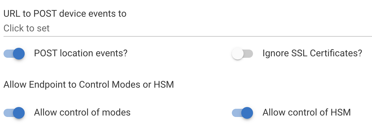

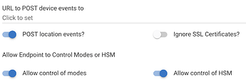

My settings are to allow control of HSM and it works using HD+ from the phone in the car, just not Android Auto. I will try to capture some logs the next time I am in the car.
Also, if I am not mistaking @arnb says in his message he is also able to control HSHM from his phone's HD+.
