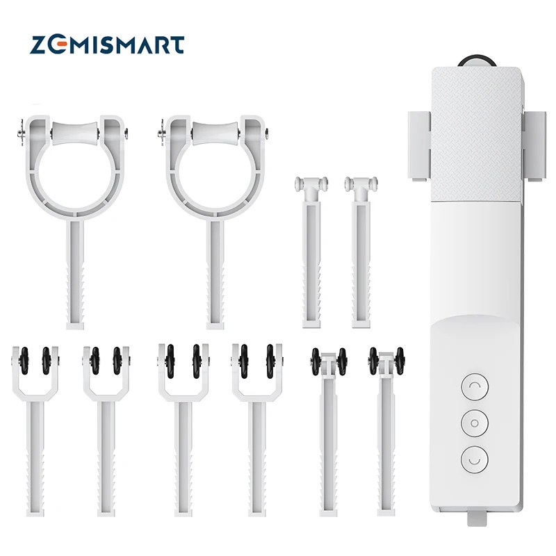

Has anyone used Zemismart Tuya Zigbee Electric Curtain Driver
Should be supported in Hubitat by this community driver : [RELEASE] Zemismart Zigbee Blind Driver
Reviving for a related inquiry for anyone using the curtain rod hardware. I understand that the diameter range is 20-28mm and it does not navigate the transition of telescoping sections very well.
My target application is a window that is about 9' (2.74m). A 10' rod would be perfect. Finding a non-telescoping rod of appropriate diameter is a challenge. Closest that I can find is 1.125" (28.6mm).
Any firsthand experience is greatly appreciated!

Delivery was much faster than expected, so I tested with the existing rod. While it is smaller than spec, it splits in the middle to avoid any transition steps. Initial testing is quite good with the community driver.
I ran it a dozen or so times to desensitize the animals, so it has been pretty thoroughly exercised. Still, long term, I will get a proper rod diameter installed. Not sure why I didn't do this sooner.
