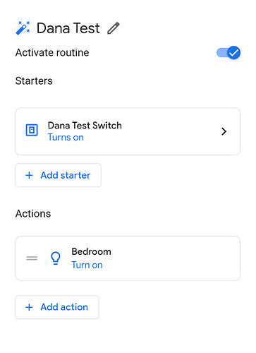

Google home has had a (relatively) major update so routines can now be triggered from a device. I've passed a virtual switch from Hubitat into Google home and it can see it, and there's bi-directional control. It also appears in the routines section for use as a 'starter' (trigger) but when the routine doesn't trigger when it turns on.
I can trigger the routine manually within Google home so I know it's setup correctly. I'm not sure why it isn't being triggered when the switch turns on though as per the setup routine/automation. Has anyone else had any success with this?

Sorry i'm slow to reply. For me it didn't appear at first either and the solution was I needed to add it to a 'home' and also to a room. Also, the routine you setup needs to be a 'household' routine not a 'personal' routine otherwise you can't use the device as a starter.
Even though I have my device as a starter it still isn't triggering the routine when it turns on (i did check that the routine is enabled). Hopefully someone can get it to work and let me know where I'm going wrong.
FYI I'm using the built in google home app integration. I've noticed that the device state doesn't seem to update inside google home unless you manually refresh. But even if I manually turn it on from within google home it still doesn't trigger the routine. Very weird.
I added my virtual switch and a light bulb via the built-in GH integration (e.g., works w/Hubitat on the GH side), both devices are in rooms in my main GH household. Set the routine to turn on a light and speak a message.
Turned on the virtual switch on HE side and the light turned on and the announcement played. So not sure why yours is getting stuck. Seems just as odd as my problem did earlier. Maybe start over and re-create the routine?
One additional general bit of learning: Every device in my GH, including ones I added w/the community GH integration, is available to act on in the routine. So appears that devices that you want to be triggers have to be added via the built-in integration, but devices you want to act on can be added via either the built-in GH integration, or the community integration.
