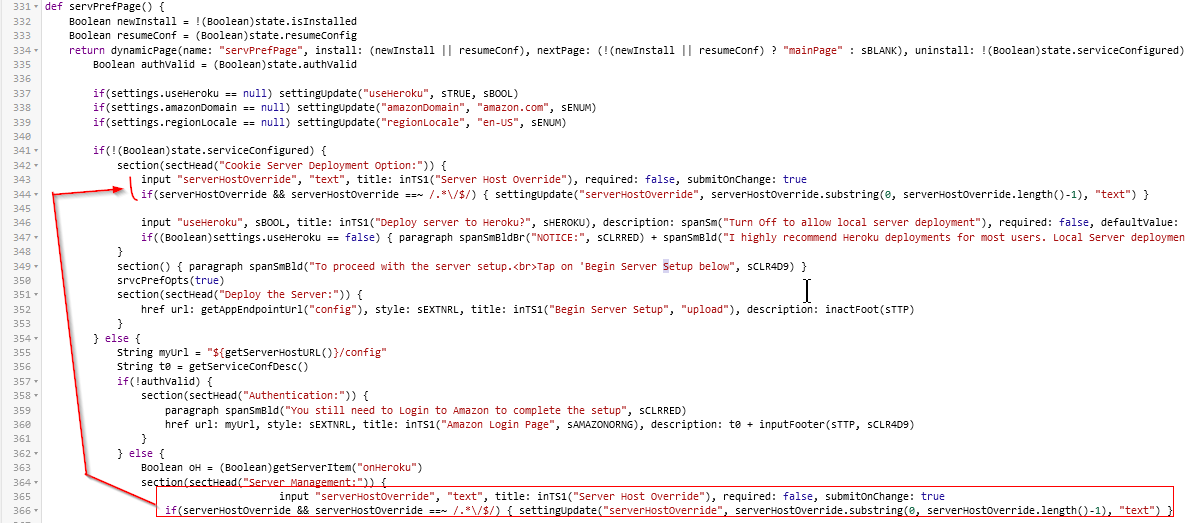

Great point about heroku working for remote. I will work on adding a dialog for entering hostoveride
I modified the code to allow input for the host override and put
The I created the docker container with
Then I went to

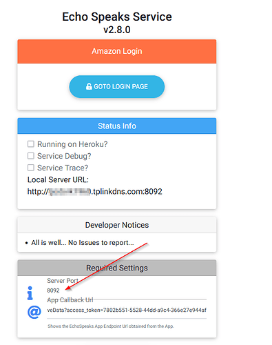

what should the server port be for the callback? my page shows 8092 but I'm thinking it should be 8091 ...if so ..how do i set that
That port needs to be the port the server is on, the server basically tells the hub, this is how you reach me. It is telling it the IP as well, but you created an override for that. None of that is relevant anyway, the issue is with logging into Amazon.

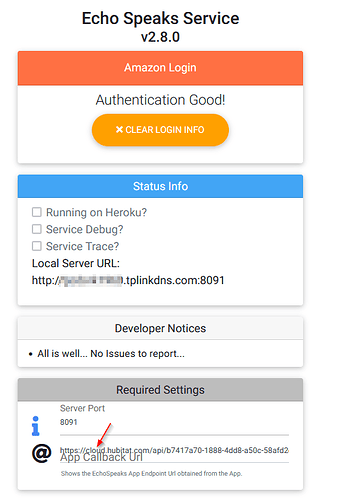

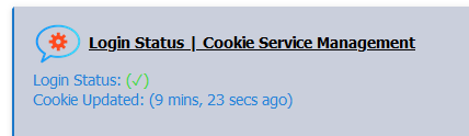

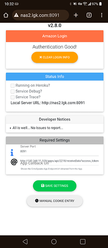

Its not necces your nephews issue your screen shot is not showing succesful login .. it should look like this...
so i have right user and pw...but then it sends a code to his phone...when I try and enter it, the entry panel for it in the browser ...clears as you enter the numbers texted.....ive seen other reports of this same behavior .....im hopeful that turning of 2FA will resolve this ....fingers crossed

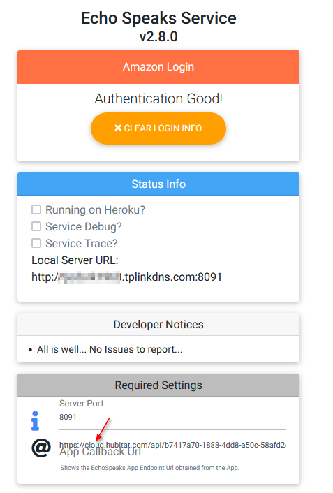

So I have confirmed that the method does work
  1. create docker echo server
    docker run -e ipAddress=192.168.1.160 -p 8091:8091 --name echo-speaks-server --restart=unless-stopped -d tonesto7/echo-speaks-server
    2.Modify echo speak code
to accept Hostoverride and put

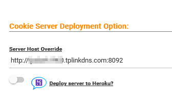

http://xxxxxxxx.tplinkdns.com:8091/ as the host override
where xxxxxxxx.tplinkdns.com is the public address to the cookie server

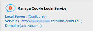

2a. Click the amazon login
3.fill in the cloud callback into server at http://xxxxxxxx.tplinkdns.com:8091/ or 192.168.1.160:8091
  • click clear and then
  1. sign into amazon (might get a captcha but not 2FA) and it works

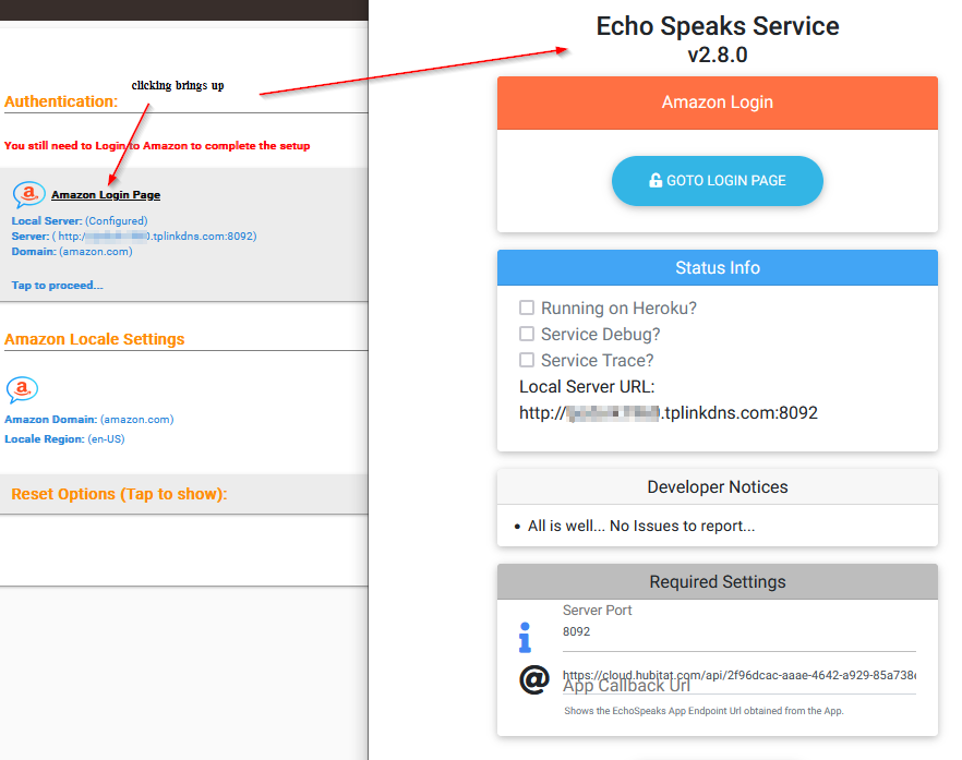

NOW - in comparison...trying to setup nephew to connect to port 8092 via public IP
after setting up server override...able to click on Amazon Login page on his hub and it brings up the Amazon Login page across the internet to my public ip/port...
but when I click goto Login Page I get error - 404 Sorry we couldn't find that page.
However, if I go to my PC port 8092 and click go to Login Page I'm able to login and get cookies
Unfortunately even though it got cookies it didnt seem to help his setup
so.... hoping there is some really smart person that understands what is going on and may have any suggestions?
There is a bunch of internal stuff using the IP with the proxy relay for the amazon login. That could be messing with it. Thats why you are getting that 404 error I think. But once logged in the HE app should be able to connect to it and refresh, but maybe not.
The only thing I can think of would be to set the Heroku flag to True on the server, and then there is some variables that would need to be set. That might work since the Heroku mode is meant to be remote.

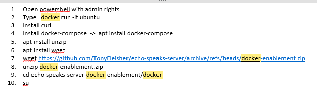

i installed docker with the following
but when I type su is asks for a password... i try the password I setup with my user timoc and it doesn't like that...i have no idea of any other password
I tried su timoc and was able to enter my password...but thats different that the documentation i saw

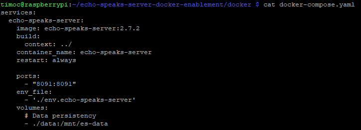

I then tried docker-compose build and got the following error
here is what the yaml says
any suggestions ?
