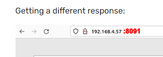

You have to use the port
I'm an idiot. Y'all are too kind dealing with my fumbling around. This absolutely worked and many many thanks!
See message below RE: me being an idiot. Thank you so much for your help!

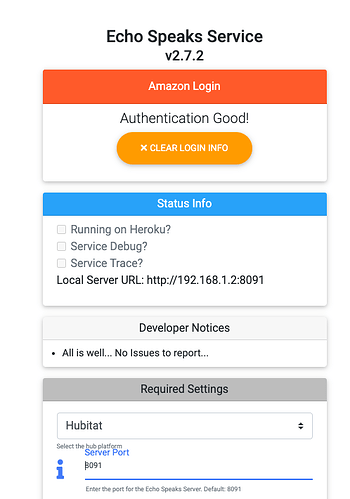

I ported the Echo Speaks Service to a local pi and all working good.
But how is the best way to update the service please?
This is the current status...
I appreciate your guidance in advance

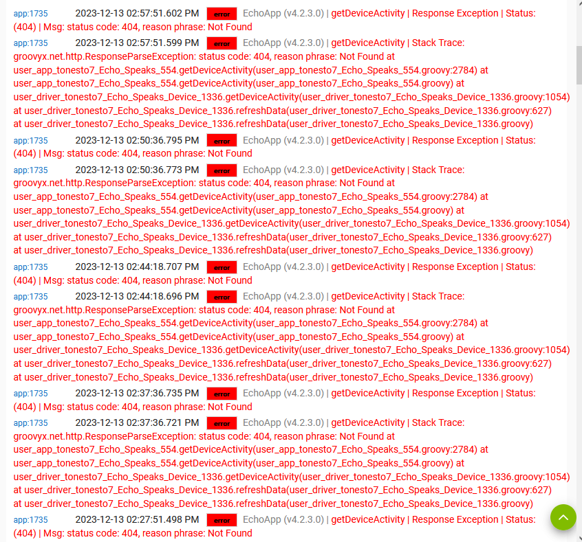

I finally got around to setting up echo speaks. I have the echo speaks server running on an always on Windows 10 box with NodeJS and NSSM and everything seems to be working fine; the HE echo speaks app shows that the login status is good, I see all of my echo dots, and “Speech Test” and “Announcement Test” work as expected. The only oddity is that I’m seeing the following errors in the log consistently every 6-7 minutes:
Anyone have any idea what might be wrong?
Looks towards the bottom of the main Echo Speaks thread, there is a code edit to make it stop. Amazon changed something and broke whatever that feature is (seems to not be important).
Yup, that did it--thanks!

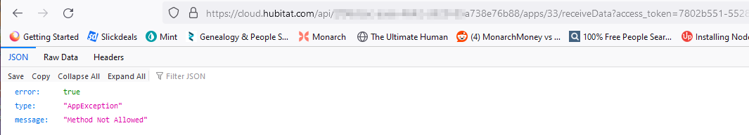

well... not sure this will work.... i was expecting the cloud version of the callback to work.... but it did not ...should it ? I tried to execute in MN to go to the Hubitat in FL....from a browser (not sure if thats correct)
