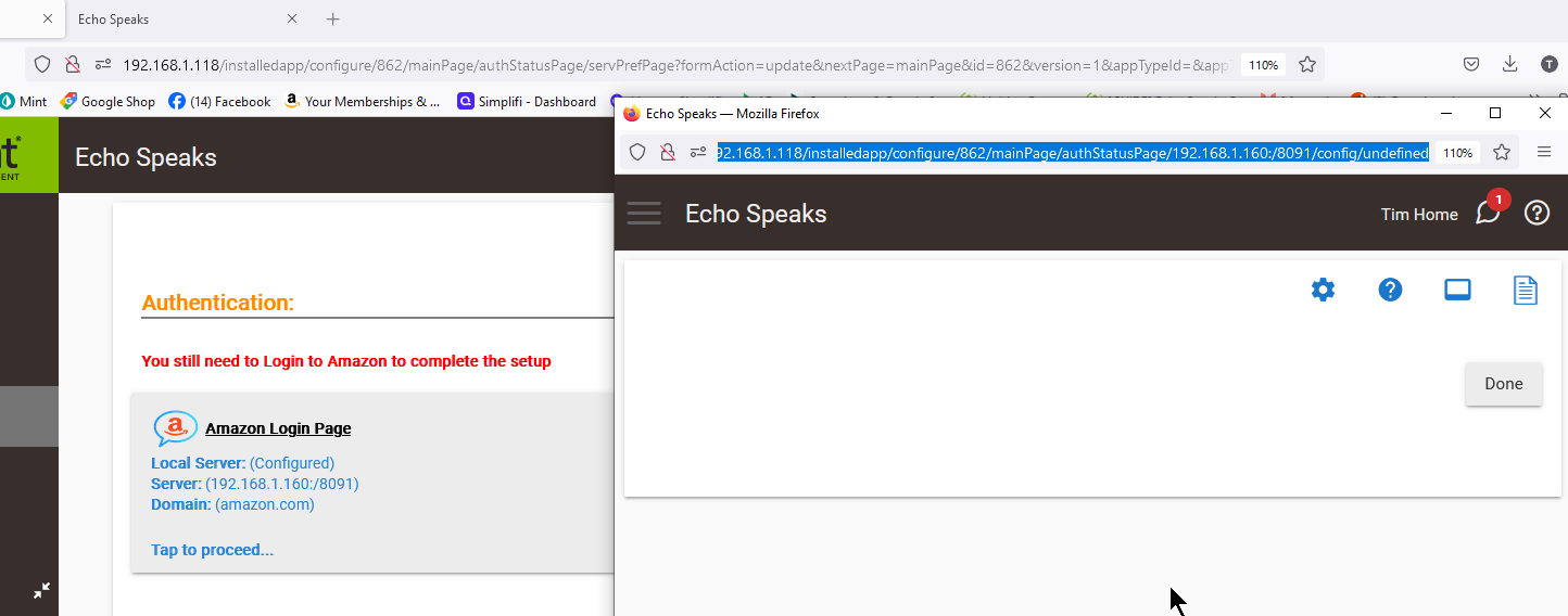

I've been busy with other things and finally back to trying to get the Pi working... Note I had docker desktop working...
On the Pi, trying the npm and nodejs route..got everything installed and can open up a window to the pi server and sign into Amazon and successfully get cookies. then reconfigured the echo speak app to point to the pi and when I click on sign in from the echo speak app ..i get
when i click on done I get
An unexpected error has occurred trying to load the app. Check Logs for more information.
Looking in the logs, i see
app:8622024-02-17 12:44:11.485 AMwarn EchoApp (v4.2.3.0) | Echo Speaks Authentication is no longer valid... Please login again and commands will be allowed again!!! | Method: (getEchoDevices)
app:8622024-02-17 12:44:11.483 AMwarn EchoApp (v4.2.3.0) | Echo Speaks Authentication is no longer valid... Please login again and commands will be allowed again!!! | Method: (checkGuardSupport)
Note I did try rebooting hub
I then pointed the echo speak to my docker install that was working and get the same blank window w done.
Sorry to keep asking questions but any suggestions?
Did you revert the Echo Speaks code on HE back to original code? Use Repair in HPM to reinstall it fresh from github.
OMG, they BOTH work now.. Thanks a million!

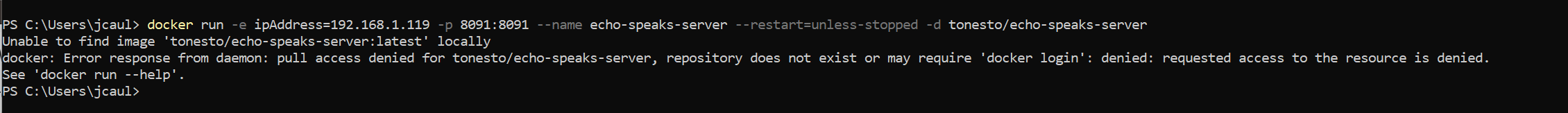

Hi I have Docker desktop installed and using powershell issued the command ...but getting an error...any suggestions would be appreciated
You have the image path incorrect, missing the 7
tonesto7/echo-speaks-server
omg...you are a lifesaver

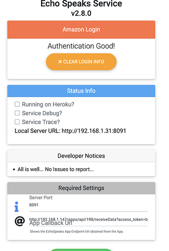

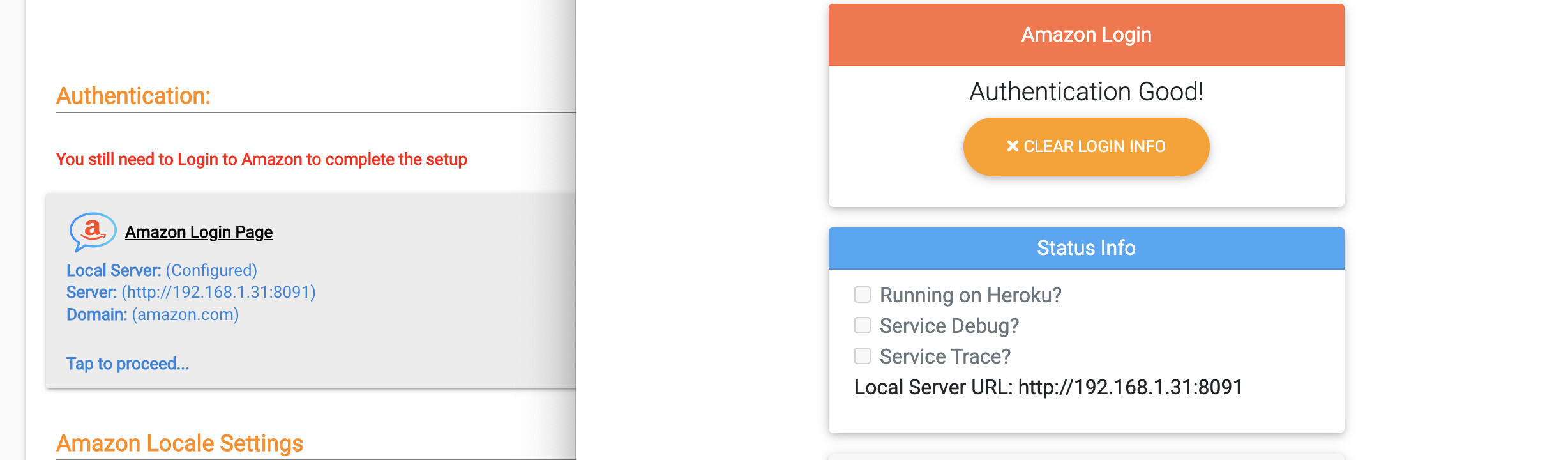

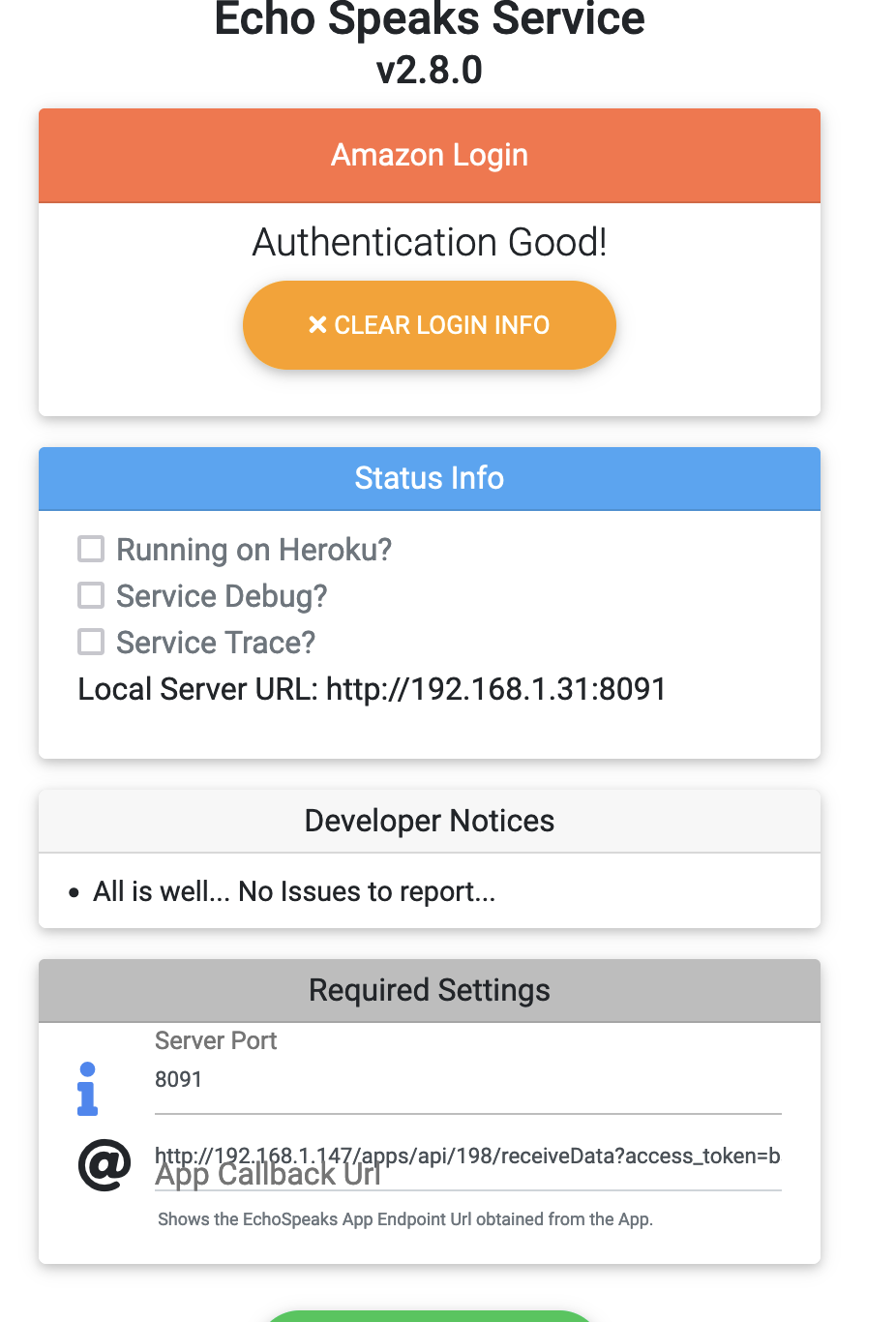

Not sure what I am doing wrong... I cant get it to work.
Synology Docker.
|App:|v4.2.4.0|
|Device:|v4.2.4.0|
|Server:|v2.8.0|
It keeps saying that I am not logged into Amazon although the server says I am.
Here is my callback URL: http://192.168.1.31/apps/api/198/receiveData?access_token=ba3dfbdc-ca54-4324-a9e0-XXXXce4568ab
Edit: typo. I already edited https to http when I posted. screenshot was wrong.
Try http for the callback instead of https
Reboot your ES server. If possible, try using a different browser. I had this issue when trying to set things up using Chrome. Firefox worked best in my situation.
yes, firefox did the trick. Weird. Thank you!
Did you ever get the proper format for the callback URL? Mine also looks like your format and I have not been able to get it to work.
Actually, I just figured it out. Had to change HTTPS to HTTP and then it worked fine. Hope this helps someone out.
