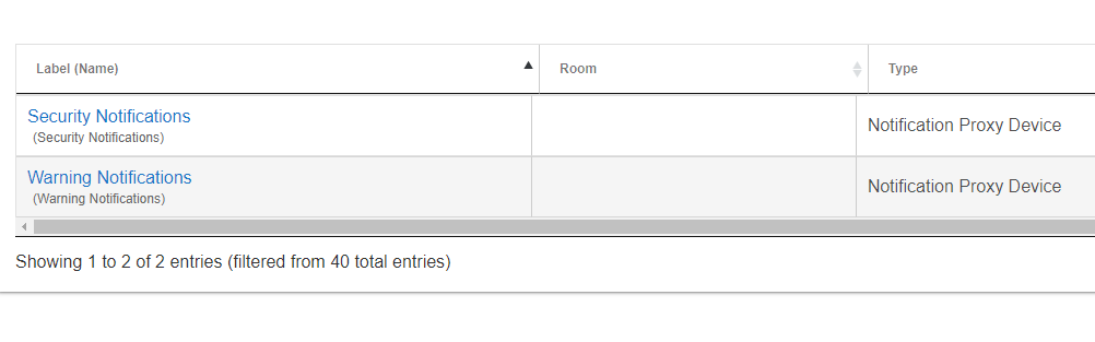

Never used Follow Me, and maybe it would work too; otherwise, this is an app and driver "Notification Proxy" that I threw together for myself a while back that sounds like exactly what you were looking for:

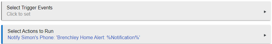

I have created a Global Variable called 'Notification', along with a rule called 'Sub Notification', which outputs a standard Notification message plus the Notification GV.
I then use the Action 'Run Actions', please see below. This means that I only have to maintain the Rule 'Sub Notification'.
