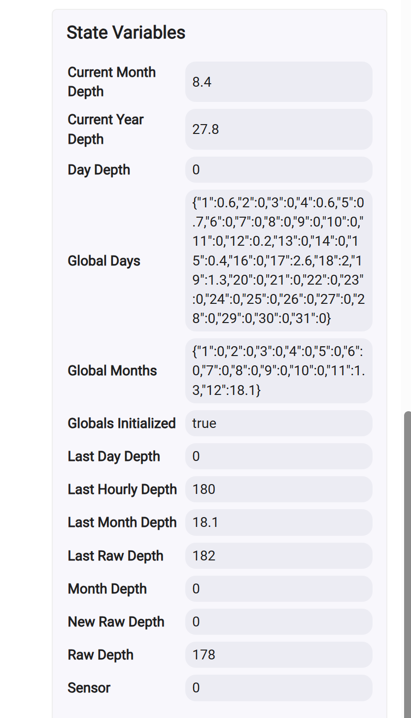

here is an implementation of my arrays in state variables i use to keep track of monthly and daily snow depth in a driver
def initializeGlobals(force)

looks like this
this implementation does last over reboots etc.
