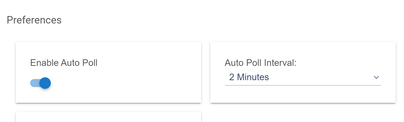

So far I've not seen the flashing. Any easy way to increase the refresh interval to 5 or 10 minutes ?
5 mins is already supported, just updated the drivers on github to support 10 mins

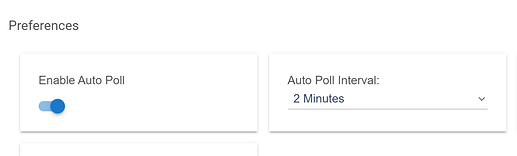

@Royski - Thanks again! I am missing just how the refresh interval is changed. I do not see it as a setting or choice on the device settings page. I updated the parent driver by copying the driver code into the existing driver (after clearing the existing) - is that right ?
Once you enable "Enable Auto Poll" then save, the field will become visible.
Set the interval required, then save again.
And yeah, pasting over should be fine. However, take a look at your drivers, maybe you have more than one?
Thanks - enabling auto poll (and saving!) did the trick

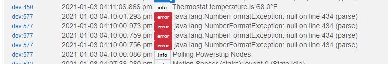

@Royski - after loading the updated driver I see this error in the logs (it goes away if auto poll is turned off).
Sorry, which do you have the 5 or 6 strip?
6 plug strip
I've tried reproducing this, I have the 5 strip, but the drivers are identical.
The only differences between them are I don't have the options for turning on/off the 6th plug.
Even with debug on, I don't see any errors.
I have the 6 outlet strip and am seeing this in my log. Both drivers have been installed since May and I see the strip and child devices. I am able to switch each plug off and on.
Any input on why the error showing in the log?
Hi, you seem to be using an old parent driver.
Can you update from this link?

Could you try commenting these lines out, and see how you go?
Not sure why V1 and V2 are there.
def zwaveEvent(hubitat.zwave.commands.configurationv1.ConfigurationReport cmd) {
if (logEnable) log.debug "Greenwave v1 configuration report received"
Awesome, thank you. That's fixed now it's complaining about line 399
