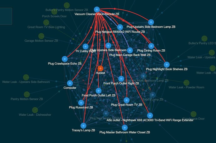

If I am reading this correctly, I don't think the controller works well as a repeater. I use this device as my Vacuum Cleaner Voice Remote ZB at the top of the photo. The only "violet" connection is to a plug 10 feet away on the same wall. Am I correct?
Yes and No.
'MCHOZY' is a white label, put by the seller on devices made by different OEMs. So quite probably, your device is different than the others mentioned above. Some 'MCHOZY' devices are made for eWeLink (SONOFF) platform, others are made for use with Smart Life (Tuya). These made for use with Tuya hubs may operate in two different modes: Tuya-specific Zigbee commands (Tuya Data Points), or in 'ZCL' compatible mode (obviously targeting also Alexa and Google and ST hubs compatibility).
Also, it is not unusual if a device that is placed closer to the hub to have a worse LQI than a more distant one.
Alhough a Zigbee device is closer th the hub, it may suffer from interferences or radio signal distortion, caused by reflected signals from the room walls or any other 2.4Ghz waves reflective objects. Sometimes, moving a Zigbee router (repeater) 30 centimeters left/right/up/down from its current position makes a noticable difference in the performance. However with the mains-powered devices it is usually not possible ot not easy to change its placement.
Just not sure why the Sengled plug that is 10 feet away on the same wall connects like this.
