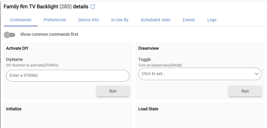

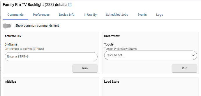

I have the H6099 (Govee TV Backlight 3 Lite) and the H607C (Govee Floor Lamp 2) both using the Govee v2 Color Lights 4 Dreamview Sync driver. I have the Movie Watching DreamView setup in the Govee app, but I cannot turn it on via the Govee Intergration on either device. I'm not sure what I am missing as I simply tried toggle the DreamView command on/off and nothing happended.
Can you tell me where to turn on the DreamView sync so that when I'm watching a movie, the DreamView turns on or am I missing something else?
I think I figured it out. I have the H6099 (Govee TV Backlight 3 Lite) uses the Govee v2 Color Lights 3 Driver driver and the H607C (Govee Floor Lamp 2) uses the Govee v2 Color Lights 4 Dreamview Sync driver. The TV Backlight 3 Lite is the Sync Center and only it needs to be turned on, as the Floor Lamp 2 will follow.
I see that whatever is connected to the Sync Center cannot be controlled individually.
You are right in that the Dreamview toggle in Hubitat turns on and off the Dreamview feature at the Dreamview enabled device that is functioning as the Sync Center.

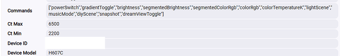

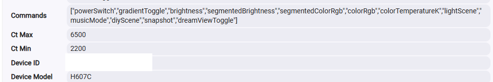

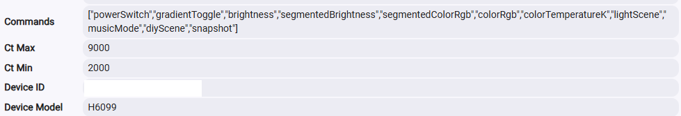

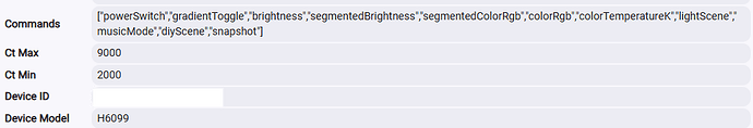

Can you open the device, go to the Device Info tab, scroll down until you see the data fields, look for the data field "commands" and past all the values here for me. It shlould show support for Dreamview in that list of commands if it is supported. I can then review the list to see why it didn't select a driver with Dreamview. I may need to create a new driver for it if the combination of commands is new
H6099 (Govee TV Backlight 3 Lite) = Govee v2 Color Lights 3 Driver driver
H607C (Govee Floor Lamp 2) = Govee v2 Color Lights 4 Dreamview Sync driver
So based on those screenshots the H6099 doesn't support the Dreamview toggle and the driver it picked is the right one.
The Integration worked as expected.
Now if the H6099 does support Movie Dreamview as a sync center in the Govee app you would need to ask Govee support for why it isn't showing supported in the new API.
Looks like everything is working as expected. H6099 does support Movie Dreamview, however only it needs to be controlled. When it turns on/off, the other devices that are part of the sync will follow.
On/off just turns the device from a given state. So if a device is in Dreamview mode when turned off it would likely return it to that state when turned on.
The Dreamview toggle would allow you to activate the Movie/music Dreamview from any state. You could have the device in CT mode as general lighting with a CT of 3500. Then if you flipped the dreamview toggle it would activate the Move/Music dreamview. It doesn't depend on you leaving it in the Dreamview Mode.
It may be a good idea to reach out to support as to why that device is missing the Dreamview from the Supported Commands list from the API.
