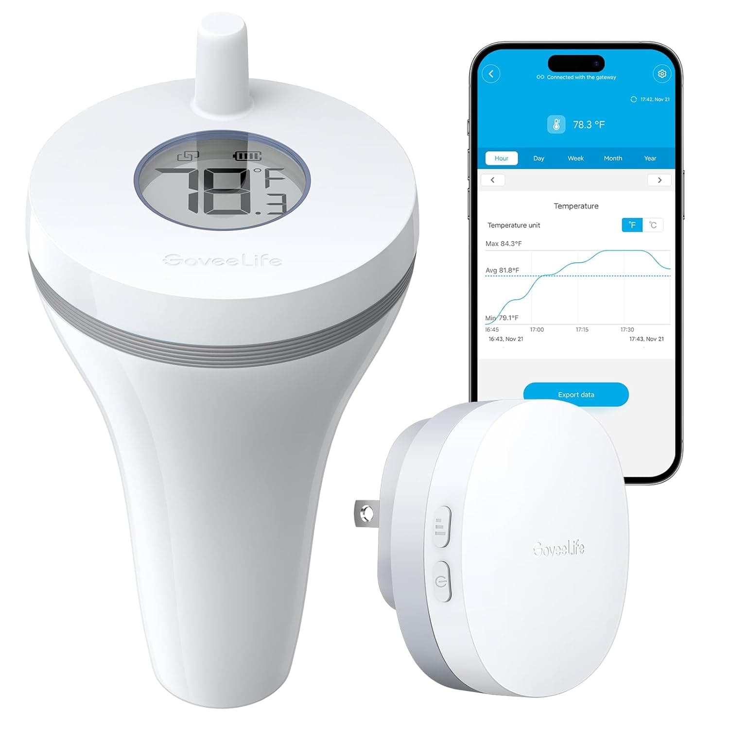

Hi @mavrrick58 - I was wondering if the GoveeLife Smart Pool Thermometer was supported with this app.
I installed the app but didn't see any 'temperature' drivers to select. I have an API key and if there's some debug info I can get from this device please let me know and I'll try to figure it out.
thanks!
If the device is avaliable via the cloud API it probably doesn't have a driver right now. The question is does it show up in the list of decices to select in the Integration app. If not then it doesn't work with the cloud API. If it does show up in the list. Click on it and let it install. Then i just need to you to pass along some information to me from the decice created.
bummer - looks like it's not supported. I saw a list of all supported devices in the API document and didn't see B5109 in there
That is old documentation for the v1 of their cloud API .
For the new API you want to look at the below URL. It isn't there either unfortunately.
Supported Product Models
Unfortunately there is allot of stuff that works that isn't in either document so the best way to test it is to see if it shows up in the integration.
