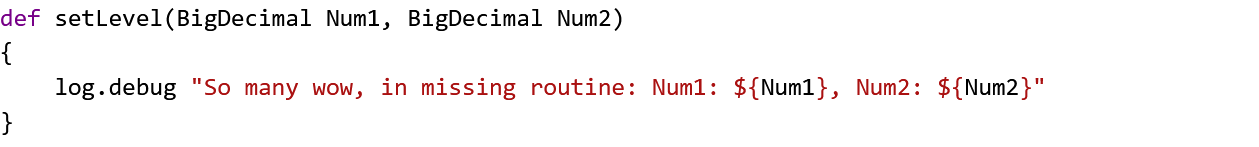

So, I updated the "Govee v2 Color Lights 3 Driver" driver to add a "setLevel" routine like this:
def setLevel(BigDecimal setlevel, BigDecimal setduration)
    log.debug "So many wow, in missing routine: Level: ${setlevel}, Duration: ${setduration}"
    int setlevelint = setlevel.intValue()
    float setdurationfloat = setduration
    fade(setlevelint, setdurationfloat)
Interestingly enough, it picked up the debug log text changes I made--AND it incremented properly, stopping when it hit/exceeded 100 (10, 30, 50, 70, 90, final loop 100).

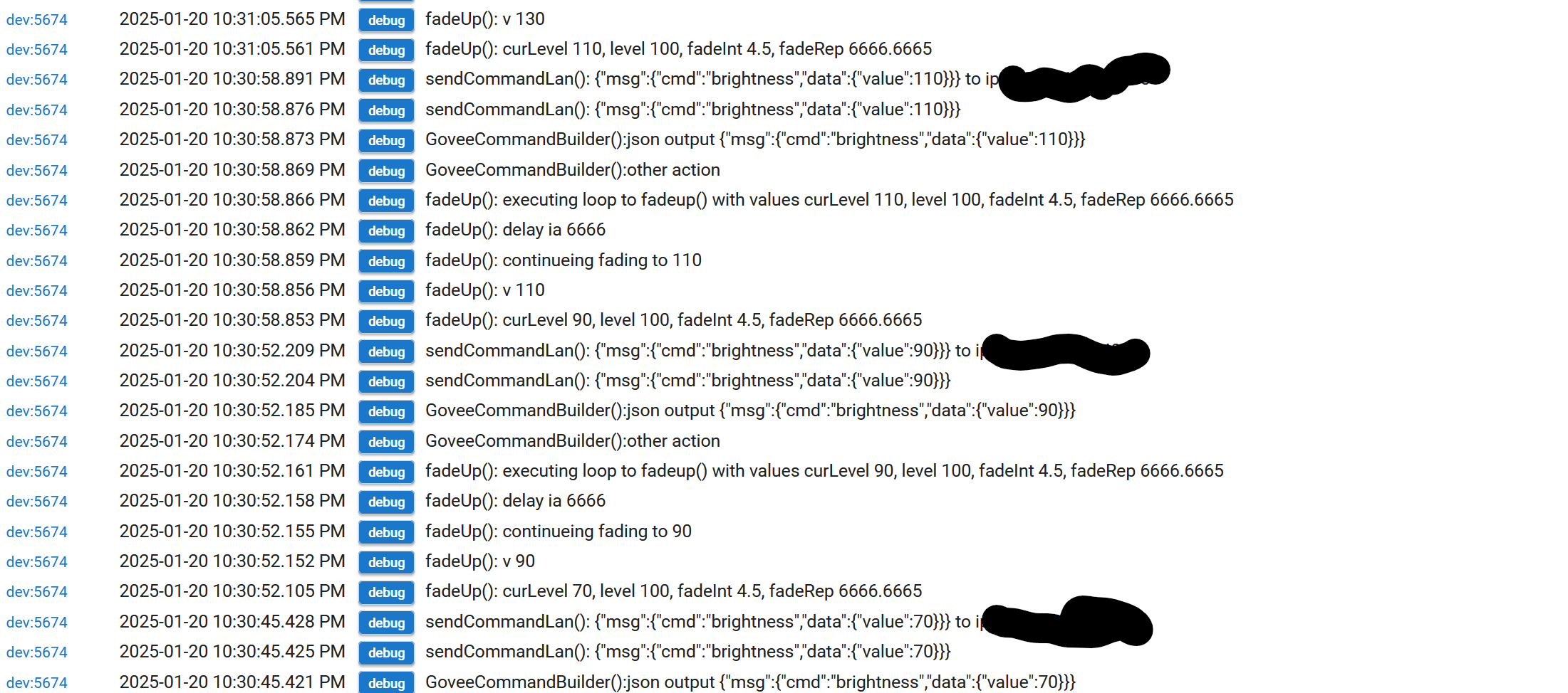

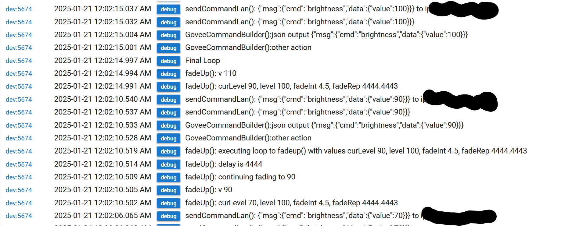

I am not having the same experience as you are. I have tested it a few times. One thing to note though is that you will see one value beyond your desired value with the log message from fadeUp(), or fade down() as shown below
fadeUp(): v 105
But in the debug log you can see the command actually submitted your final value. I can probably move some of the logging around to remove that confusion actually. I will look into that.

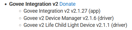

At that time that code was part of the driver itself and not a library file. Please go into HPM and click on the option to "View Apps and Drivers". In the list that appears make sure you see the driver you are using and that it is 2.1.4. If it doesn't appear there you may need to unmatch the integration and then match it up again.

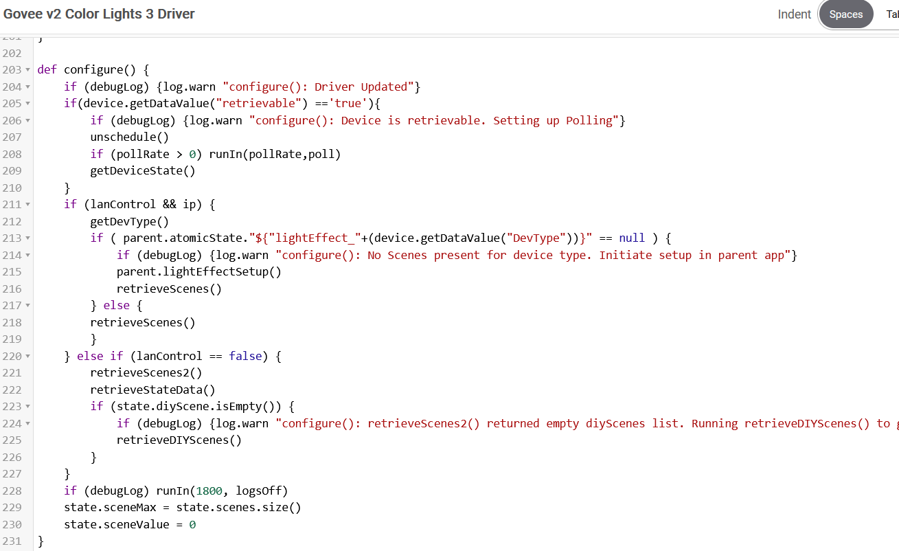

Also please go into the driver (Not the Library) and let me know what it shows on line 203.
Currently, I added a "setLevel" routine of 10 lines above line 203 in the driver, so this is what I have:
I did an "unmatch", a "match", then a repair.
Now, I get:
Note--it appears the following things are old/out of date/not updated (I just whacked them):

So, it does seem to be better behaved now (not sure how things got so messed up, but HPM clearly didn't get things properly updated).
