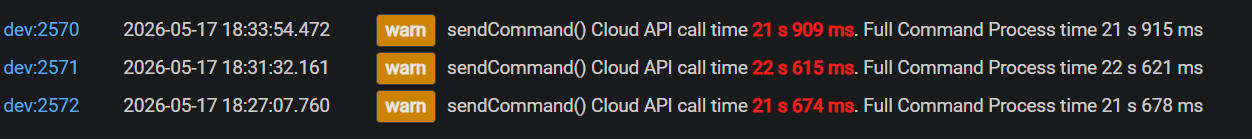

I have the same response from Govee support also. I opened a ticket yesterday after my TV lights took over a minute to turn on.

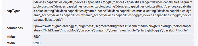

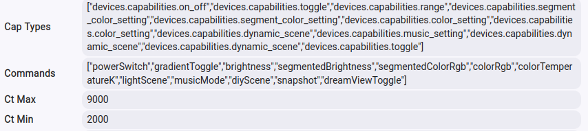

On top of new commands it also appears they are cleaning up some of the device info that may not have been correct. The same floor lamp pro use to have a ctMax and ctMin value of 9000 and 2000 respectively. Now it is showing 6500 and 2200 respectively. I will see if i can create a process to check and update that device data for devices already created. That info wasn't expected to change, and is used in validation of some driver functions. If it isn't valid that may cause other issues.
Here is my Floor Lamp Pro device data as example from my prod hub Hubitat says the device was built in 2024
Here is my Floor Lamp Pro device data as example from my prod hub Hubitat says the device was built a short while ago.

Sure looks like my case. 10-25 all day long.

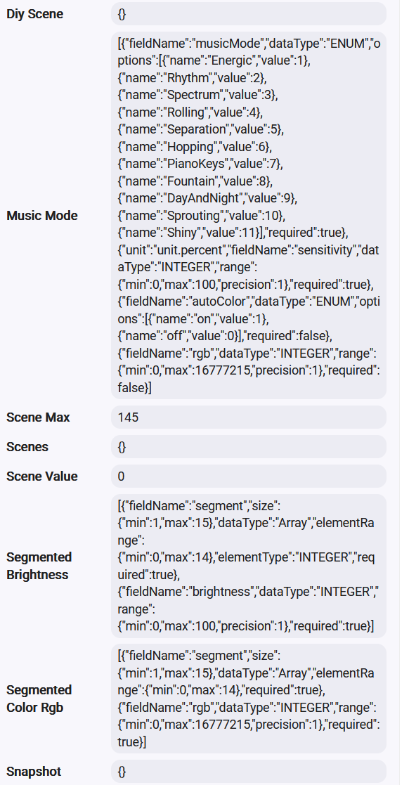

On a different topic, I'm starting to play around with "scenes" and trying to sort out the commands and options for my device.
I created some DIY scenes using the mobile app. I had to disable the "LAN Control" then I was able to do a "Load Scenes" and it populated the values on the device page. But those vanished as soon as I switched back to 'LAN Control".
I'm trying to figure out how to get the scenes I created in the app/cloud to work locally.

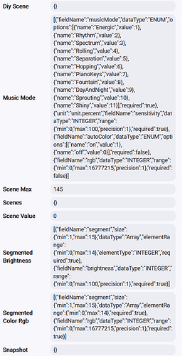

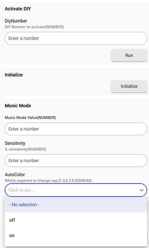

And, notice that the prompt for the "AutoColor" under Music Mode indicates it should be a numeric segment--but it's a "Drop Down" with on/off.
Similarly, the "Gradient" indicates it is a number but has an on/off DropDown.

That is cosmetic but i understand it can be confusing. I will look at the information and see if i can update it to be clearer. It is proably something created by cut/paste and i just missed editing it.
Yeah, def cosmetic--but it means there's not a good explanation what those do. :slight_smile:

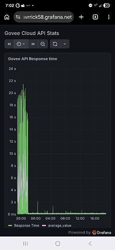

Looks like the API delays may be resolved. Here is a graph from my dashboard. You can see last night it went down to near zero.
