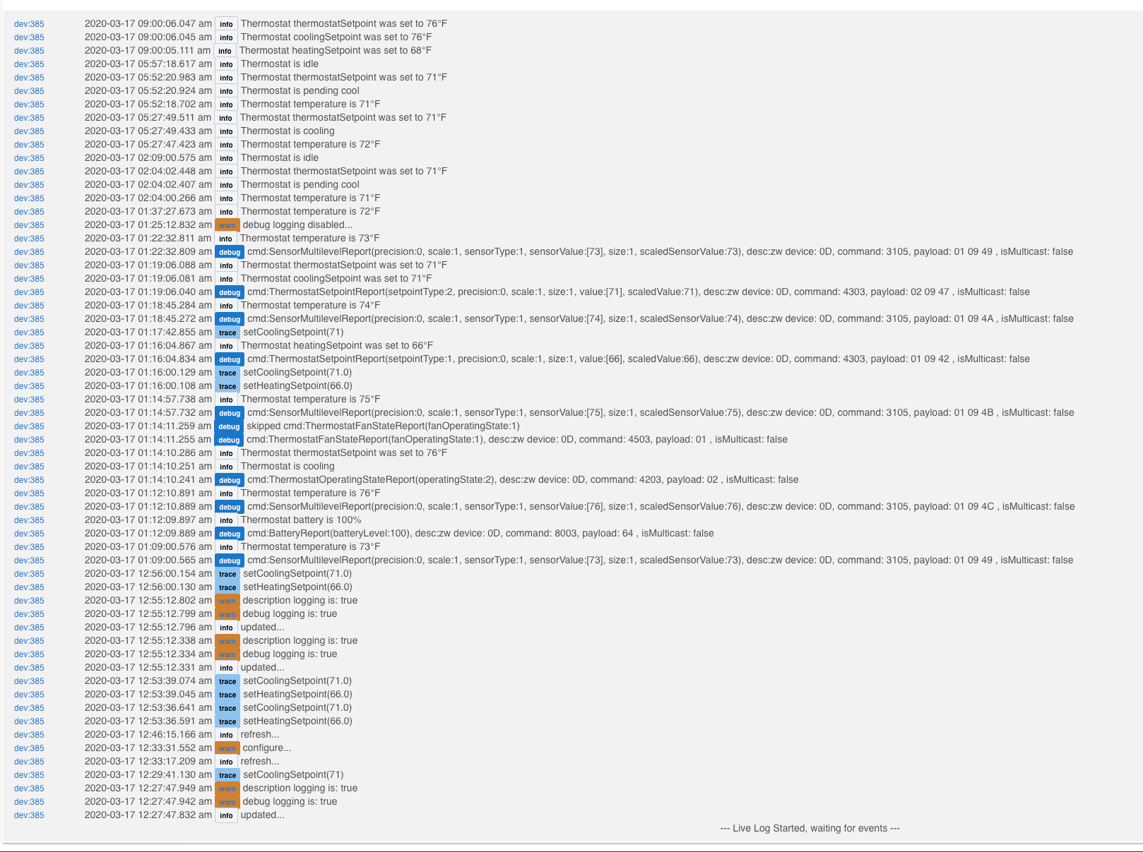

Here are the logs:
As you can see the coolingSetpoint and other data isn't being updated either in the state of the thermostat.
Anybody have any ideas?
Cheers
I’m seeing log entries for things that were called.. But no log entries for messages from the device...
Do you have debug logging turned on? Also, these are calls out from Hubitat to the Thermostat but nothing is coming back. Also, your batteries are down to 27%. it's possible the device isn't working anymore. Have you checked to make sure the backlight comes on?

Here's the log as of this morning.
