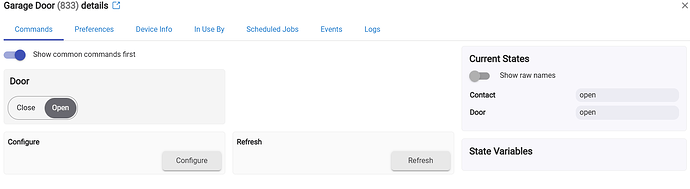

Can you clarify what you mean by this. Are you referring to the Device page for the opener?

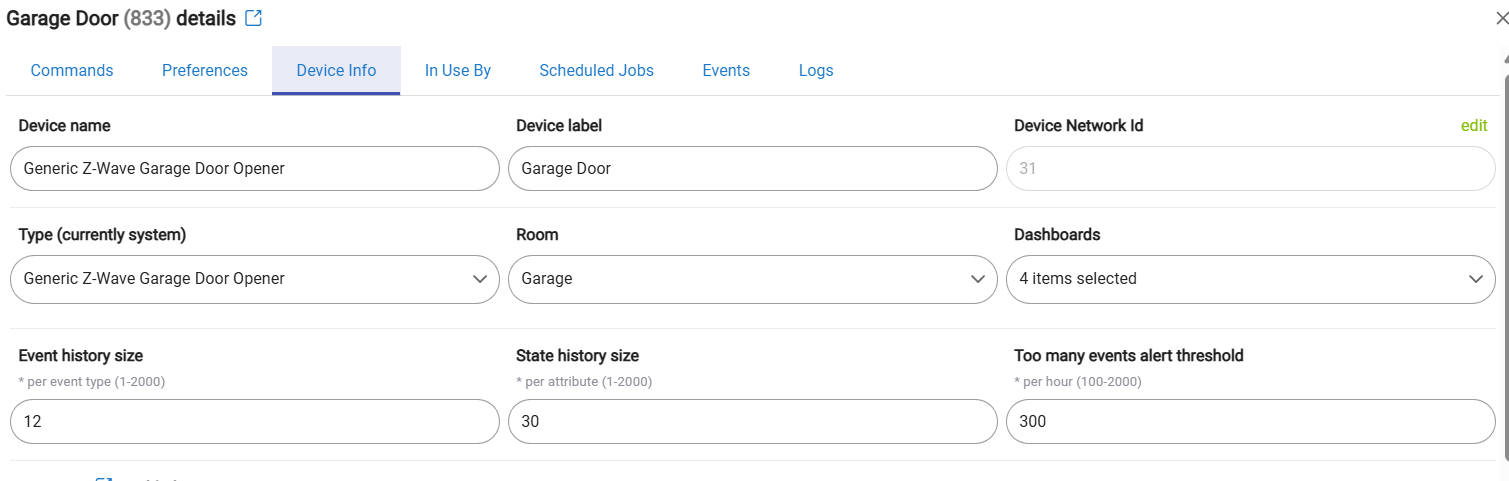

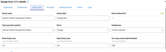

Your Device page should look like this:

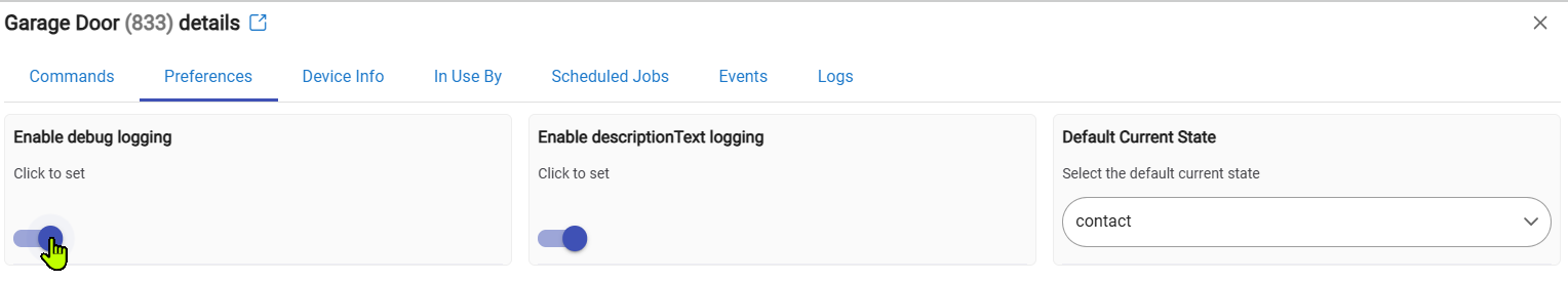

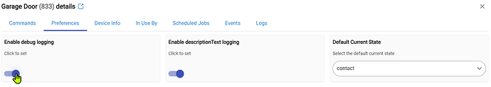

On the "Preferences" tab enable Debug Logging when you are trying to troubleshoot problems - do that now and hit the Save button.
Device info should look like below - make sure your "Type" is "Generic Z-Wave Garage Door Opener.

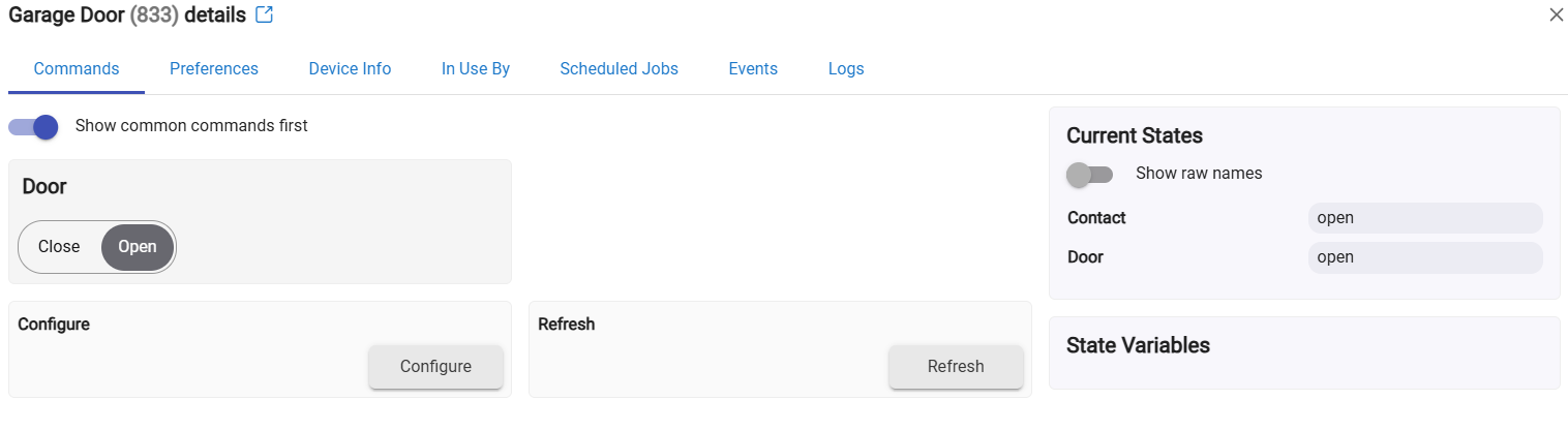

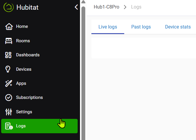

Once you've enabled Debug logging, open a live logging page (Logs) and then go back to your Device page in another tab and hit Open or Close (whater is opposite of the current garage door state) and take a screen cap of what appears in your live logs.
25-10-19-3979

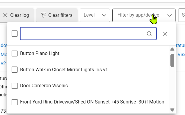

You can filter logs by device, using the Filter drop-down.
25-10-19-3980
Post a screen cap (not a text grab) of the entries that appear for your garage door when you use the Open or Close command on the Garage Door Device page. If you're on windows you should be able to use the Windows Snipping tool.
