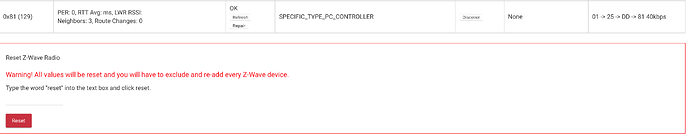

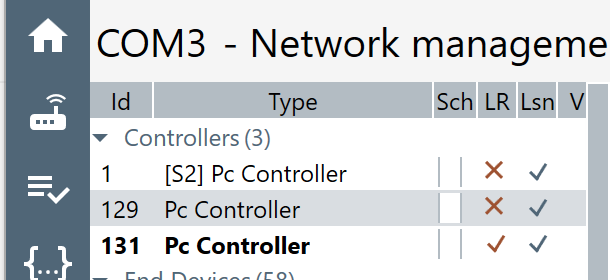

- I once was able to remove 129, the ghost PC controller.
. But now it is back in. It shows an "x" and check in the PC Controller app, but PC Controller 131, which has 2 check marks in the PC Controller App doesn't appear in my Z-Wave details page:

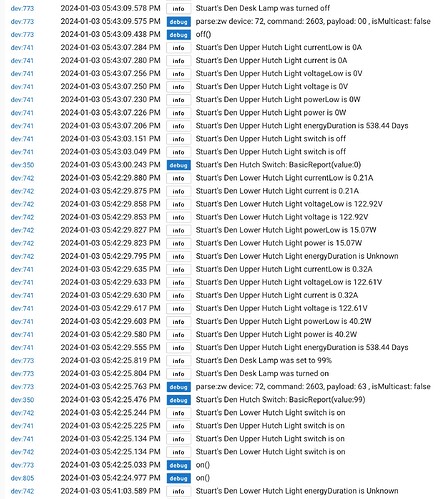

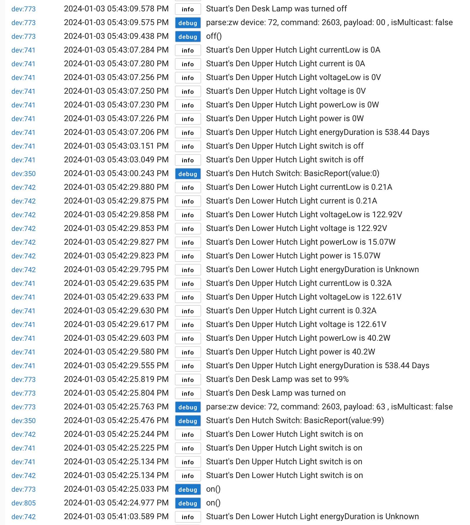

a. BTW, as I was sitting in my den suddenly all the devices went on. I went into the Past Logs after I turned off everything except the 1 light the I wanted on (the ceiling fan light) and then took this screenshot of the past logs. Does this help at all to determine why these suddenly all turn on?
b. I did find a rule that turned all these lights & the fan on, and that was a long hold on the button 6 (the + sign in the lower right) that would do that. Am I to suspect the button and/or the battery is to blame for that and it is just coincidental that this started happening when I got the ghost? BTW, I am 100% sure the button didn't get pushed by accident as it has happened when no one was home and I was sitting right by it just now when it happened and I know I didn't accidentally bump it.
