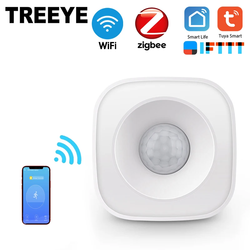

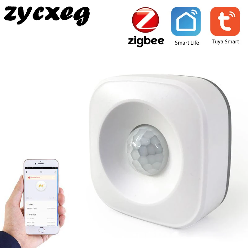

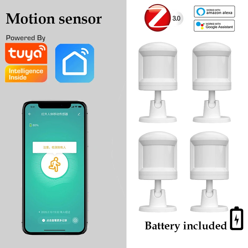

Motion Sensors
TS0202 – on stand, CR2450 & TS0202 – small round, CR2450
Use “TS0202 RH3040 Tuya ZigBee Motion Sensor.groovy” by Mikhail Diatchenko

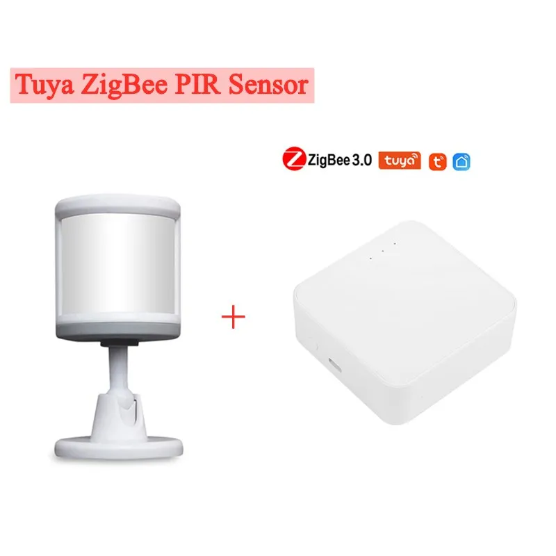

RH3040 – flat top on stand, CR2450
RH3040 (3xAAA rechargeable batteries)
Use “TS0202 RH3040 Tuya ZigBee Motion Sensor.groovy” by Mikhail Diatchenko.
Note that all these devices seem to suffer from mechanical connectivity problems with the batteries so you have to juggle the batteries around a bit to get them to stay in. Given AAAs are much longer lasting and easy to get rechargeable ones (and better for the planet not creating extra toxic waste) I am going to persevere with these and add a little solder to make the batteries connect better.

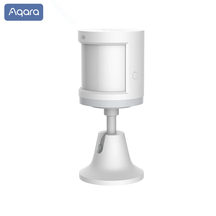

Aqara PIR – on stand (CR2450) – Model = lumi.sensor_motion.aq2
Driver: “Zigbee – Xiaomi Aqara Motion Sensor.groovy” by Markus Liljergren

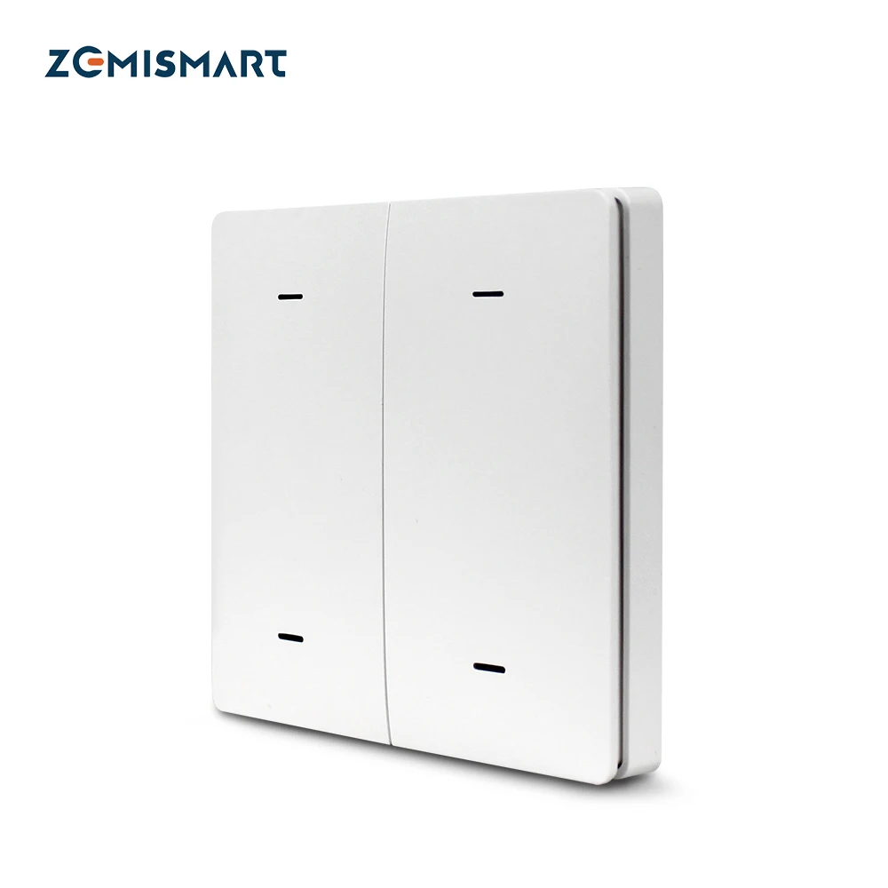

TS0044 Black or white 4 gang pushbuttons.
Use the inbuilt 'Tuya Zigbee Scene Switch' driver.

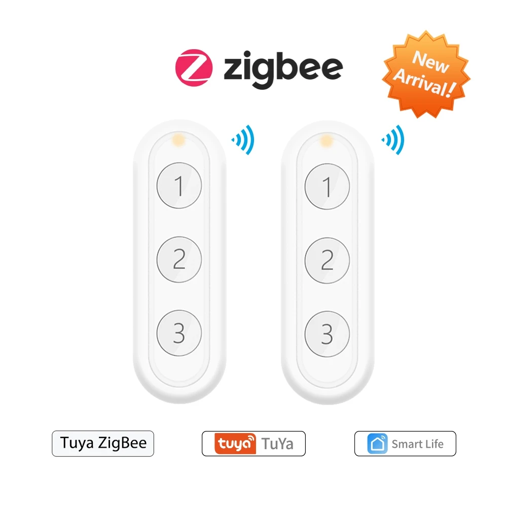

TS0043 Pushbuttons, 3 gang Pushbuttons.
Use the inbuilt ‘Tuya Zigbee Scene Switch’ driver.

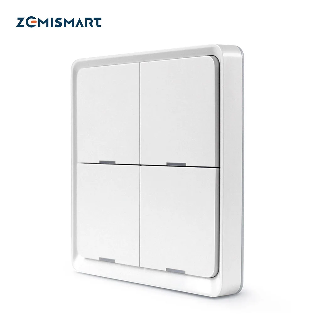

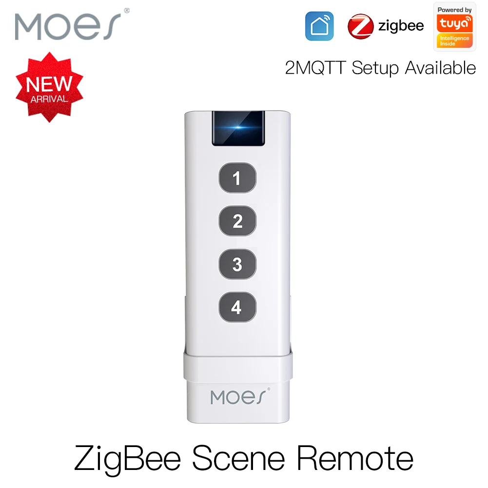

I have luck with this Smart ZigBee Scene Switch 4 Gang Remote as well:
(use 23A battery)
Yeah this one I bought too. I don't have a LR 23A 12V battery to test it yet though as it's kind of an unusual and expensive battery but it looks pretty sleek to have on the wall. It would be great if you can post which driver you used to make it work in Hubitat?
I use the standard 'Tuya Zigbee Scene Switch' driver for the remote. Yup, the battery is unusual.
Just wanted to provide an update.
I ordered this 4 gang switch and it DOES NOT work with the Tuya Zigbee scene switch driver. The model I received is id'd in the pairing as TS004F.
It works with this custom driver. The old TS0044 switches seems to be not produced anymore.
Change the driver and pair it again close to the hub.
Wow thanks for the quick response. It really wasn't an issue as I also use zigbee2mqtt so I was just informing others.
To your knowledge are these switches tuya zigbee or are they aqara zigbee (which has issues with certain repeaters)
They are Tuya Zigbee, inheriting all Tuya oddities .. :slight_smile: But no problems with Zigbee repeaters.

https://www.aliexpress.com/item/4001365407192.html?spm=a2g0o.order_list.0.0.21ef1802yn4NrD
You mentioned we should use "Tuya Zigbee Scene Switch" driver! but I couldn't find it!
Do you mind more details? I would appreciate that.
Thanks alot!
Its a custom driver written by @kkossev that you install
Click on "Drivers Code" link on your hubitat, then in upper right corner click "New Driver". Open the link below in a new browser tab, select all and then switch back to your hubitat tab and paste the code in the driver code editor window. Then click "Save"
You can also click the "import" button and paste the url below.
Now pair your scene switch and it should automatically pick the new driver you just installed.
Here's the link to the driver code
https://raw.githubusercontent.com/kkossev/Hubitat/main/Drivers/Tuya%20TS004F/TS004F.groovy
Thanks alot, very simple instructions! my buttons will arrive in few days but I am wondering does this code support the TS0044 also? the ones I shared are not TS004F.
Thank you.
TS0044 works out if the box using HE inbuilt driver.
Sorry for the dumb question, what do you mean with inbuilt driver? do you mean I should use this?
New device > add by brand > Tuya switch > 4gang
Thanks!
No, you must select 'Tuya ZigBee Scene Switch' for TS0044.
Once the device is paired to the Hub, if the driver that was automatically selected is not the right one, go to device page and manually change the driver to the one above, select it from the list.
The device type can be seen in the 'data' section of the device page. It could be either TS0044 (use the inbuilt Tuya zigbee scene switch driver) or it could be TS004F (use the custom driver). Usually, you don't know what you will receive from the seller, until you pair it to the Hub.
Thank you! one last question if you don't mind, how you set up the tiles to the right button (1 click, long, double)?
Sorry, I am not sure whether I understand the question.. To use the scene switch to control some lights or something else, you can try the Button Controller inbuilt app.
