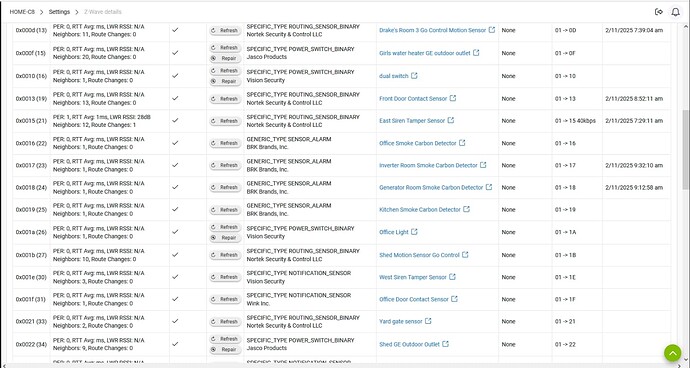

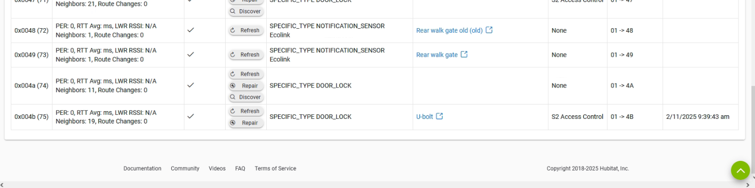

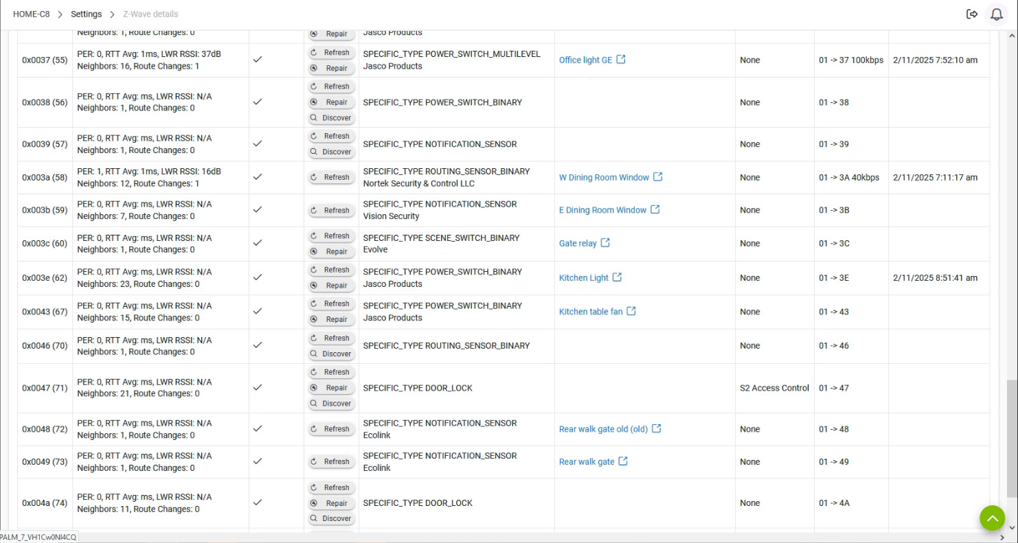

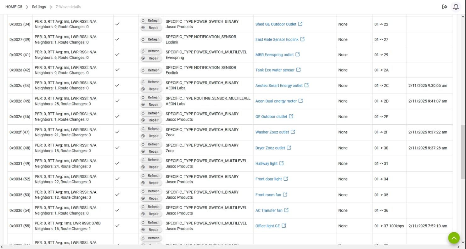

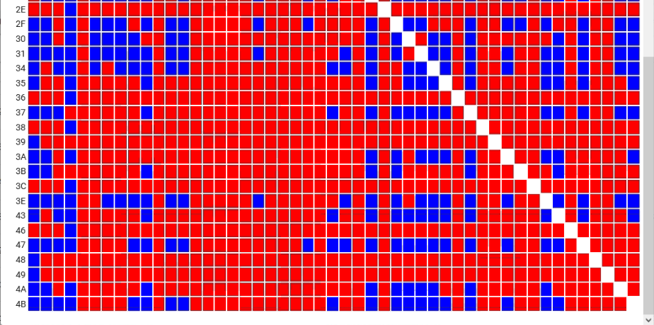

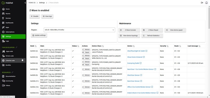

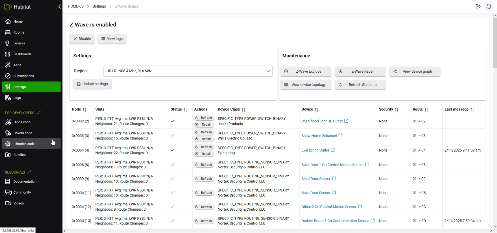

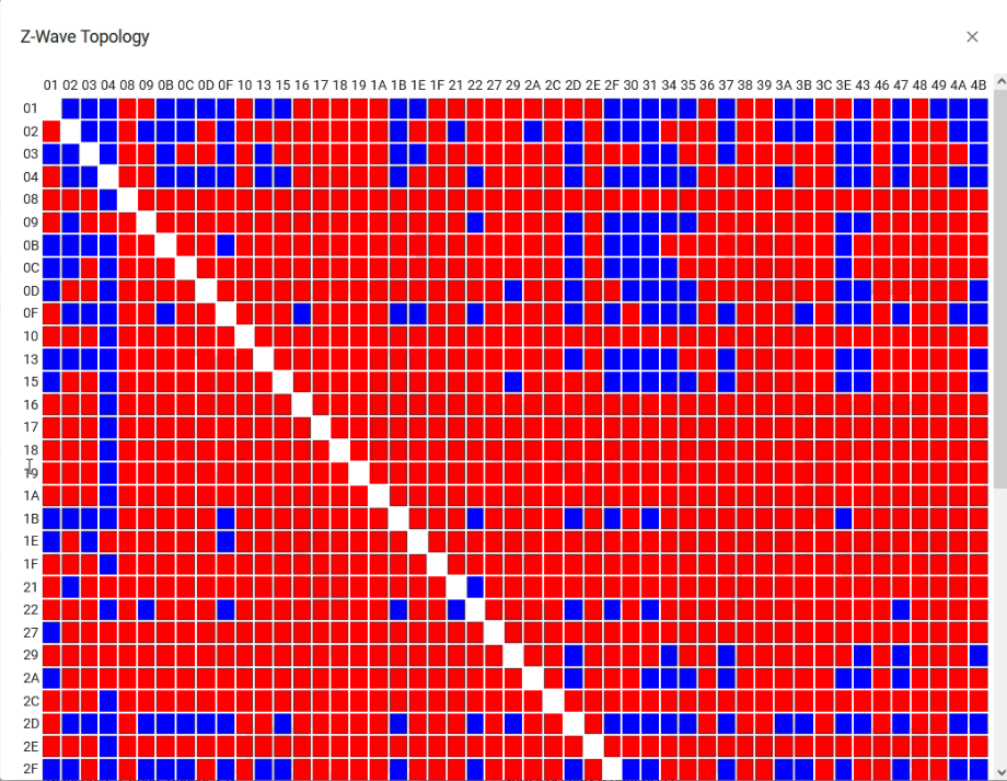

We need to see the z-wave details and topology as well, it is explained in my post above.
it shows "Hub should be running for at least 12hrs without reboot," I powered the unit 7am this morning .

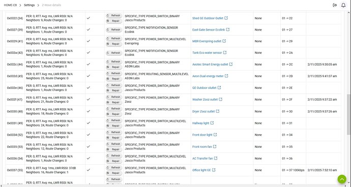

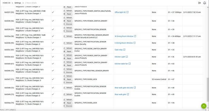

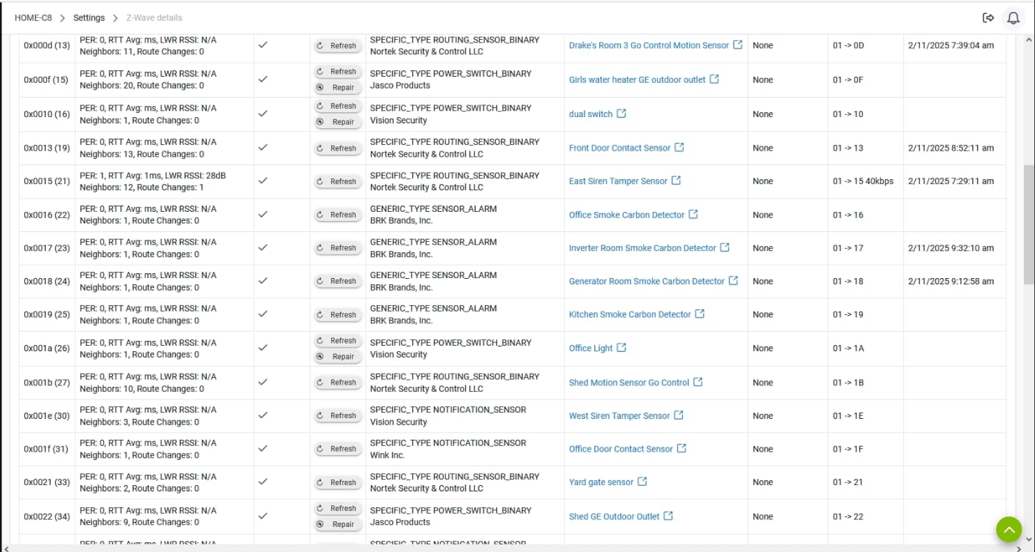

You have at least 5 ghost / dead nodes where no device is attached to them. You should try to remove those if you want, instructions are here: How To Remove Ghosts using hub tools or a UZB Stick . Try the on hub method first, I think you can clear some of them that way.
WHat is the footprint of this home (sq ft of main floor)? Seems like the devices may be spread very thin.
Did you try power cycling the wall switch itself with the circuit breaker?
was able to get rid of 4 of 5 ghost only one left is "SPECIFIC_TYPE NOTIFICATION_SENSOR" have 7 other real devices with that same device class, I have tried a few times to get rid of it, to no avail.
