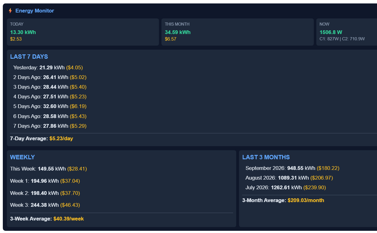

Using the : AEON Labs Power meter for my mains .. covers hole house.
AI and me, created an energy monitor tracker system. This is what it looks like:
I'd like to know what the whole house is using per day during the summer and winter.

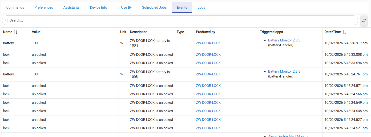

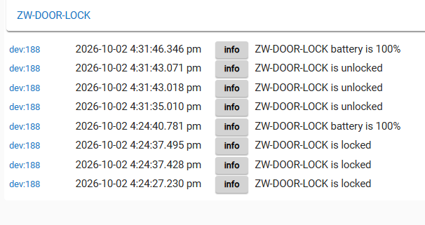

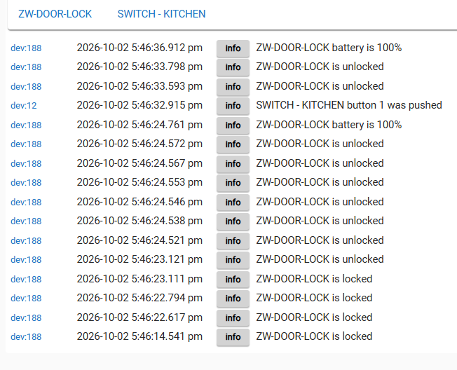

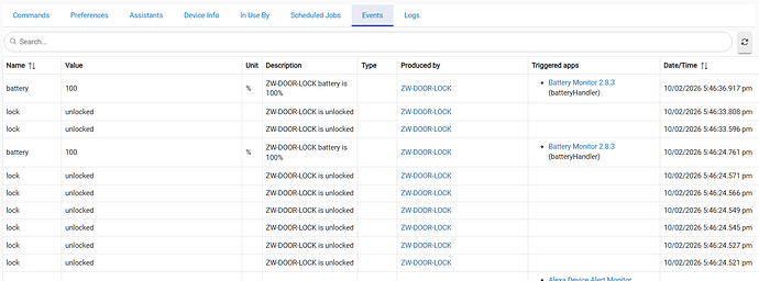

Spoke to soon I guess .. getting Multiple entries for opening and closing of the lock in the logs.
Pretty sure it didn't do that before I changed over the Z-Wave.
What model lock is that, and which driver is it using? My locks are "Kwikset Homeconnect 620", and I don't see that.
Also tagging @bcopeland.
Nothing that I know of, other than device spam, that would cause that many reports..
@WarlockWeary is it still happening?
If it is I will need some logs.. Z-Wave logging...
Well, it's not quite as bad all of a sudden, but I'm still getting it.

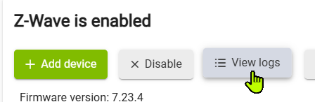

Z-Wave logs that Bryan asked for are accessed from the Z-Wave Details page...
Open the Z-Wave logs page and then trigger the event, and copy/paste the Z-Wave logs to Bryan. :slight_smile:

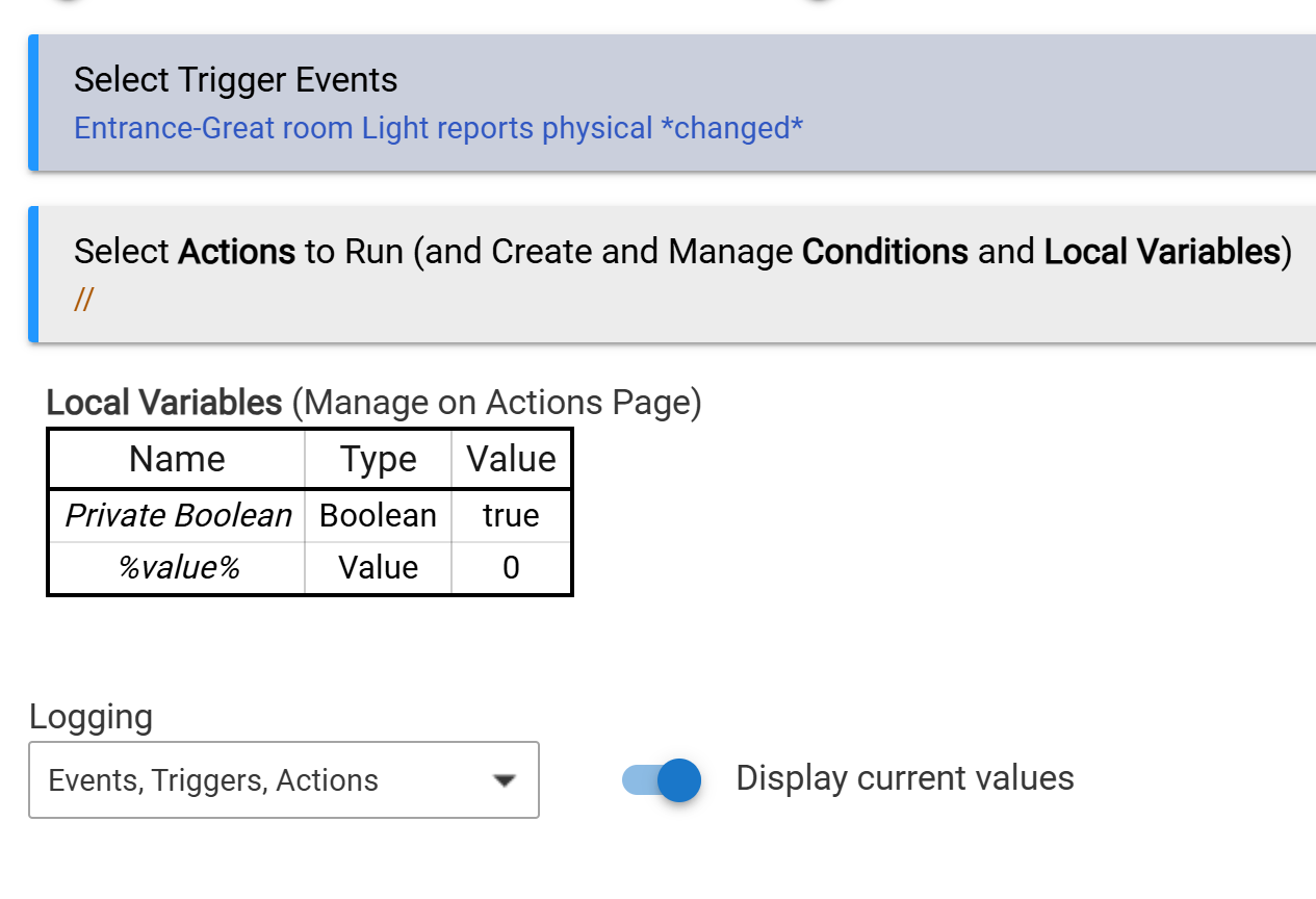

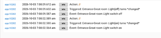

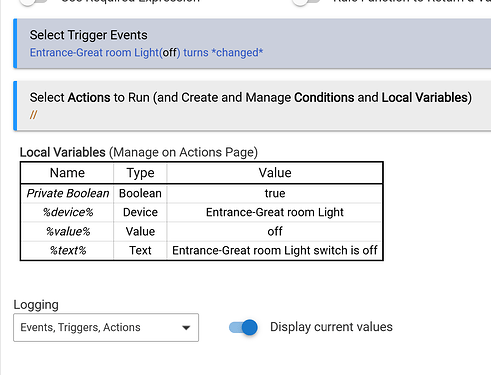

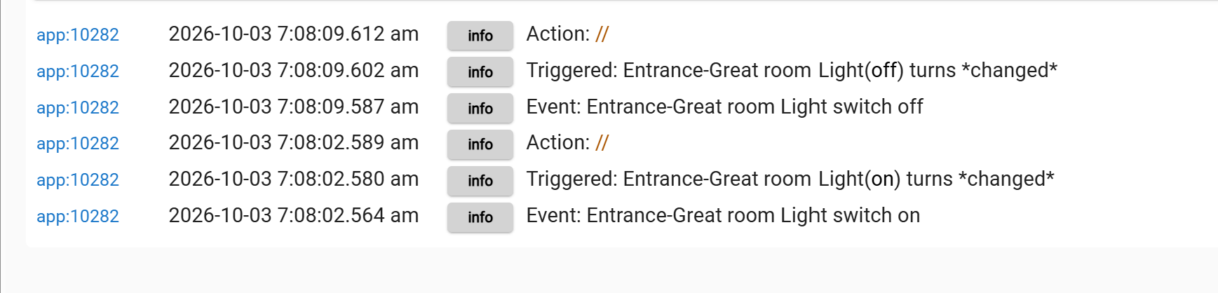

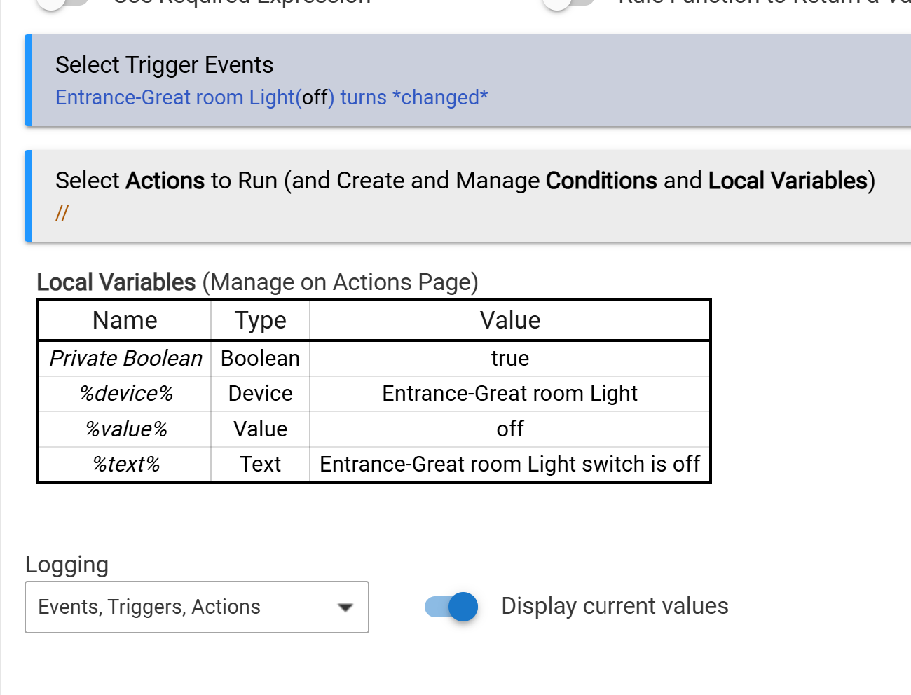

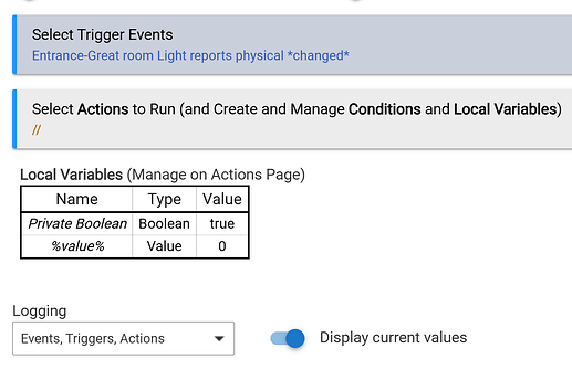

I'm having trouble with a ZEN21 VER2.0. I don't know if this is related to the upgrade. I have 2 newly created test rules.
Test
Test clone

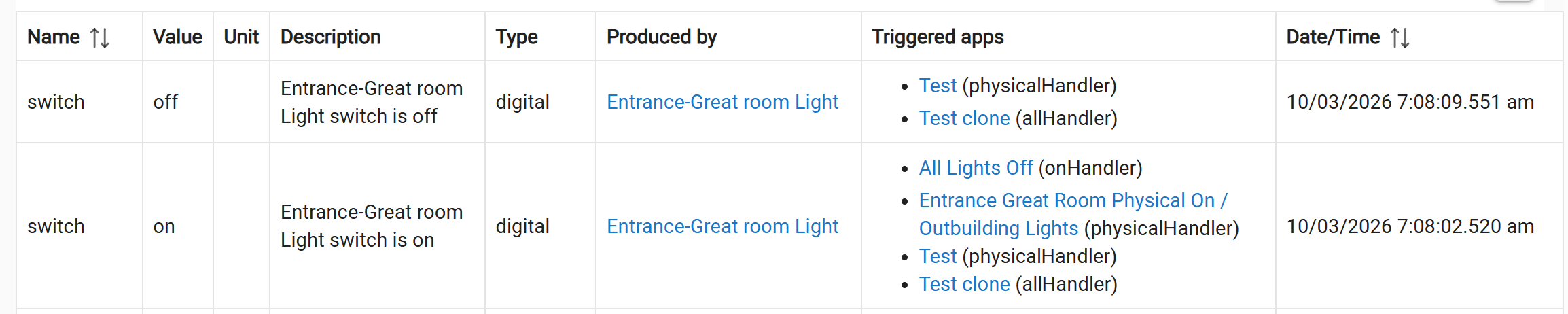

Physically toggling the switch only produces logs for the second rule.
The switches event log shows:
