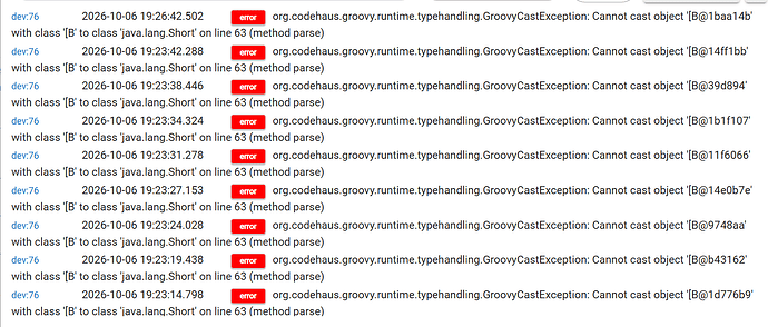

  1. Enerwave 7 button controllers (no built in driver) had a bunch of parsing errors so wouldn’t work.
  • Got Claude to find and fix the parsing errors, so these are working again.

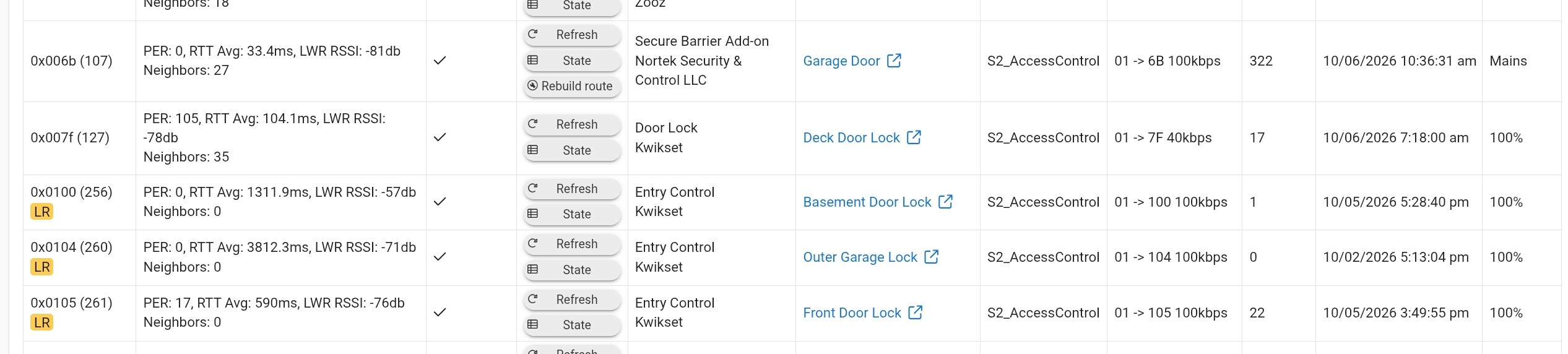

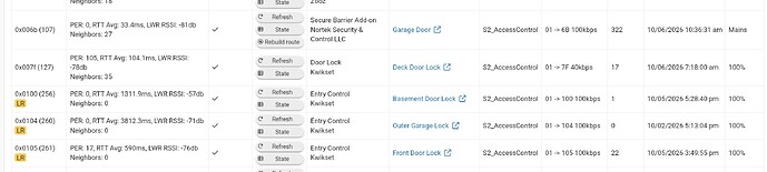

They are good now and I did not get screenshots at the time. It was in the device page that I got the message. Something to the effect that this device was paired without security but requires it.
The other symptom was that pressing any button on the affected locks resulted in three beeps and no action. Could not even push the lock button.
Google said to check in the device details for the Zwave Secure Pairing Complete flag, which stated true (even though I was getting the warning)
It said the lock's database(s) had become corrupted and that to fix it, I should click configure, then refresh, and wait for refresh to update the states (which also removes all lock codes). After that, it did work fine. I just had to do it with three out of 4 of my locks. Two of the 3 were LR, the other was mesh. The one that was unaffected was LR.
The garage door (Also S2 Access Control), was also affected on the initial switch to JS.
This is the affected devices CURRENTLY shown in the Zwave table. The only one that was NOT affected was the Basement Door Lock - which is the farthest from the hub in case that matters
edited to add - There haven't been any issues since I did the configure -> refresh trick. So, not having a reason to switch back to ZIP, I doubt I will see the problem again. Also, when the garage door would not shut up, I switch back to ZIP and unplugged/replugged the garage door to silence the tamper alert. Waited a few minutes and tried JS one more time. Since the garage door was playing nicely, I went ahead with the Configure -> Refresh trick and have been good since

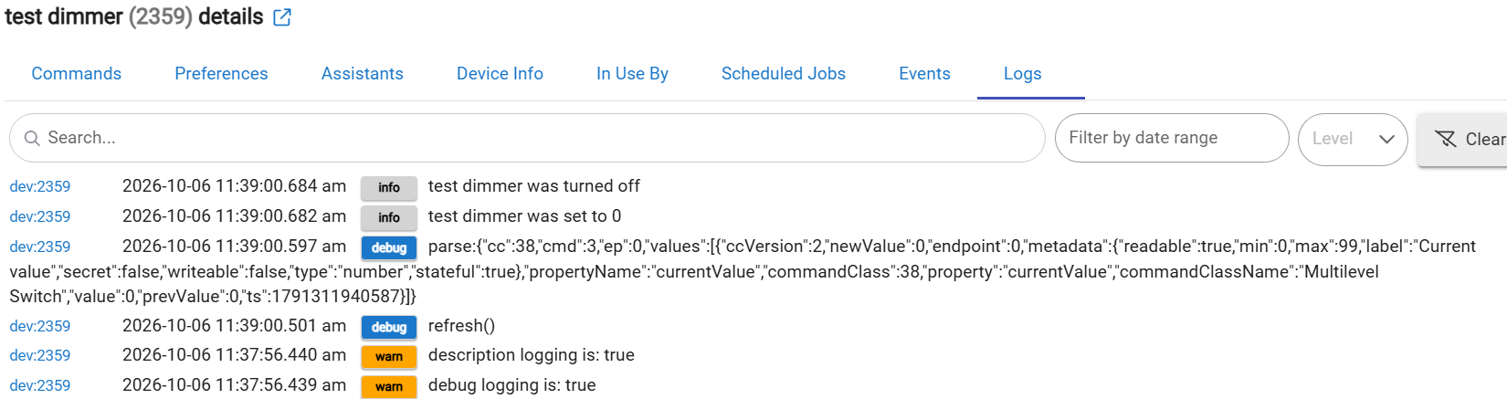

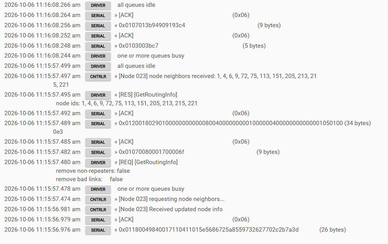

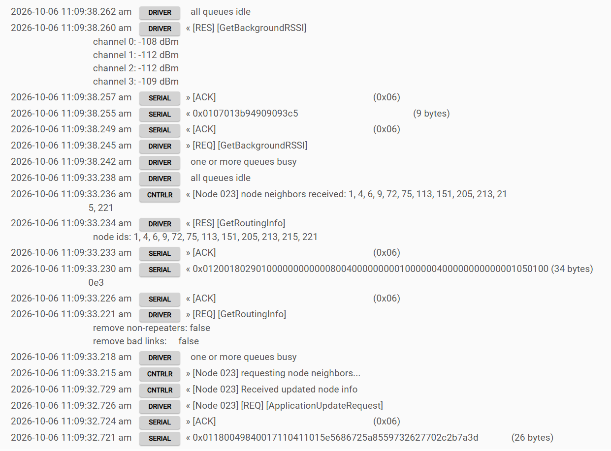

Since I see other reports of devices that are no longer showing status updates @bcopeland , I will throw in my 2 cents about the problems I am having with the ZW3004 GE ZWave Plus Dimmers on any drivers that support that device. They do not show status changes on the device page unless an explicit Refresh command is issued, and they do not trigger events although they can be controlled via the hub. Here is the Zwave log from when the device is manually turned off:
And from when it is turned on:
The 2 log screenshots you showed don’t have any reports
can you turn on debug logging from the device page and try again and capture the driver logs?
Turning the device on and off does not show anything when debug logging is on, unless I am looking in the wrong place. I clicked Refresh to make sure things were being logged.

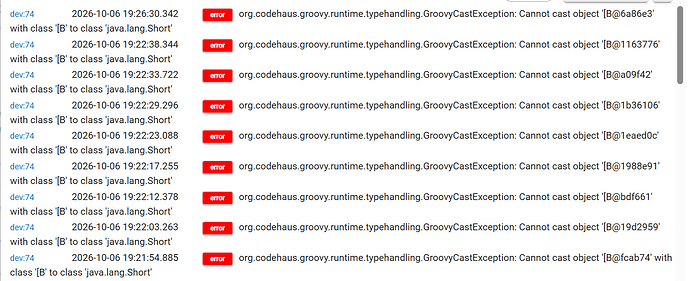

Generally went well, all mains powered devices were "interviewed" ok and worked as before. Also most of the battery powered devices changed over OK once I remembered/found out how to wake them up :wink: . Two devices are however giving a problem. They are both Aeotec/AEON Labs 4 Button Keyfob - Gen 5 using the built in Aeon Minimote driver. They both work using legacy Z-Wave, however after changing to ZWave-JS although they pass the "interview" they fail to trigger the various button drivers/rules that worked using legacy Z-Wave. The logs for the two devices generated when each of the 4 buttons were pressed and held are below.
For Key Fob 1
For Key Fob 2
No such log entries are generated when using legacy Z-Wave as I switched back to check.
It looks like the button presses are being transmitted to the C8 but when using ZWave-JS something is being lost in "translation".
For completeness the Z-wave details page reports :-
Firmware version: 7.18.1
ZWave-JS version: 15.29.0
and I am currently running version: 2.5.2.129 on a C8.
Any suggestions as to what to try to resolve this as it appears to a an issue with the built-in driver.
08 Oct 2026 - Fixed by update to HE Release 2.5.2.134 (see below).
@mfh.fbes .. I see that problem.. Fix is coming
