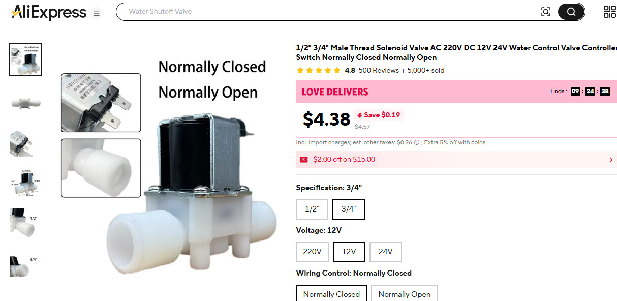

I have been thinking the same thing. I've been using wifi and Zigbee hose valves for several year now, I've yet to have one make it through the third summer. I think I am going to build my own for any that fail this coming summer.
I've been looking at valves like these on All Express.
I would use a 12V Power Supply (also cheap on Ali) to power the Zigbee relay board and the valves. I'm also tired of changing the batteries in my current smart valves.
I still have 5 months of weekly watering before the summer rains really start here so I'm not sure if I'll make a change now or wait until next fall after hurricane season. But, those look interesting and economical enough so maybe.....

Rainbird or orbit 24v valves are around 15 bucks at home depot. I would think just using the standard stuff and voltage makes sense.
Good point. I'm looking at options, and those Zigbee boards can run on 24V so it probably makes more sense to go higher volts anyway. Anything with better dependability than the tiny 3V valves in the smart garden valve devices.
Those 3v valves are just underpowered, and they get jammed stuck on because the spring is too wimpy to push it back off when there is wear resistance, or they get stuck off because the coil is too small to push it open with resistance from wear. That's my theory, anyway. I think I get a bit under 1000 on/off cycles or just over two summers out of those valves before they get sticky, based two watering cycles a day.
