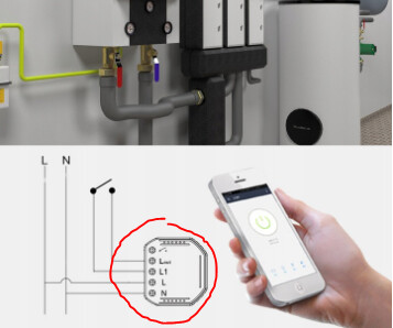

All switches I find of that brands are 230V powered where on electrical diagram you must source S1/S2 by L wire and of course there is N wire, SO fully operate in 230V.
This is not what I need. When i Connect like this i’ll smoke my device
I need MOMENTARY SWITCH which only stick two small wires together (closes the circuit) after signal from other smart Zigbee device.
