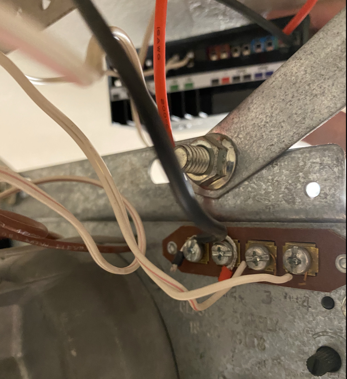

So I got all the parts and got antsy so I went for it (didn't do the jumper test, but tell me if I should go back and start there).
Below are pictures of the install and the drivers/apps I added tonight. When I go into "Garage Door" (source is "user"), and I click "open", I hear clicks but the garage door doesn't open.

How do you have it connected?
From the manual, it looks like it has an external power source.
All you'll need to do is go from R1 to the two contacts on the garage. SW1 is if you want to connect a switch to control the relay
so assuming you have an existing button to open the garage door, connect:
R1 to the garage motor
SW1 to the existing button
Alternatively you can leave the existing connections plugged in and connect R1 to the motor
@jsc
@dadarkgtprince
do you mean leave the two white wires attached to the #1 and #2 connectors as they were before I started, and just add the red and black wires also to #1 and #2 and then to R1?
I have a button next to the door. And I want to control the garage with HE, doesn't that mean I need a "switch"?
Isn't this what I did? Or did I do it backwards - Motor to SW1 and button to R1?
from your picture, you have the white wires on R1 and the red/black on SW1. the red and black are going into the garage motor...this is wrong
This is how you should be wiring it up.
Whether you put the wires as shown in the picture of put the wires in parallel on the motor, either way should still have the button work on the wall and the relay control it (via HE)
YES I HAD THEM BACKWARDS!! THANK YOU!! WORKS PERFECTLY!!
