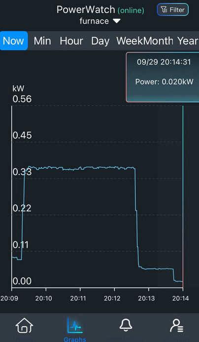

nice phone app to see graphs and setup notifications

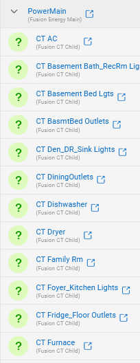

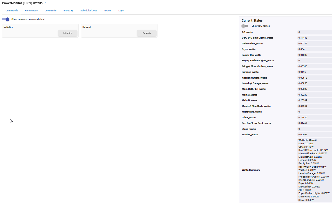

Here is the details and driver

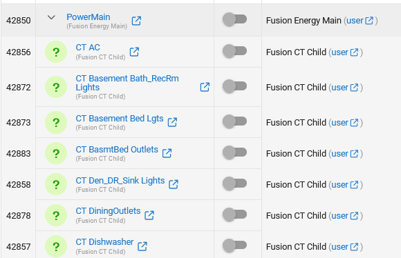

Here is example pic of device page

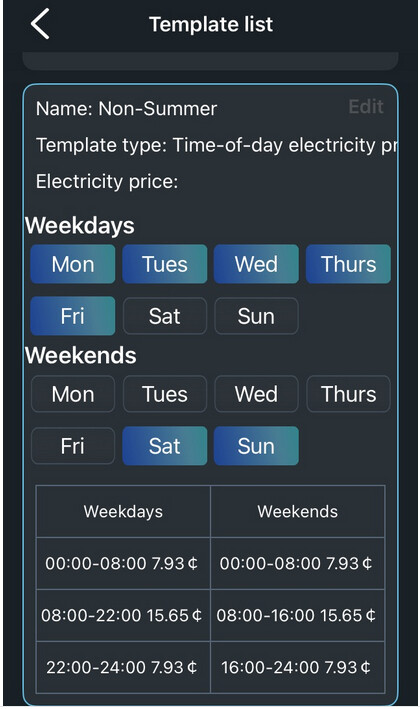

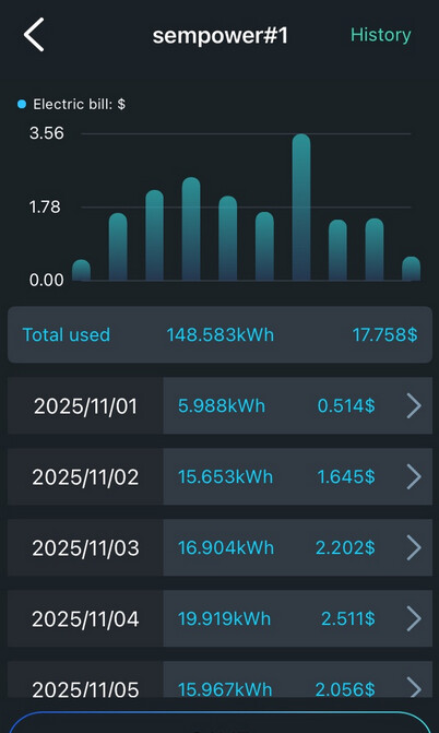

Here is an example pic of app

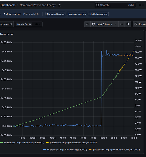

The 2 second mqtt publishing really needs to be filter out duplicate (small change) With the help of AI Copilot/chatGPT i now have a python script that does a lot of filtering and then sends back to the MQTT broker for use by my Hubitat driver. T The Python script also sends to InFluxDB for use by Grafana Local and it also sends to Grafana Agent for use by Grafana Cloud. The hardcoding for the CT's is in the python script and those names are sent to Hubitat where the children are auto created. Note anything with -A and -B are summed and the letter dropped (i.e. Main-A and Main-B)

Also I found that the app does allow you to specify the different rates based on day of week and time of day and you can see the costs per day.... i just updated so the costs are wrong...but going forward should be accurate

I have one of these energy monitors (soon to be 2), and am using your driver in a virtual energy monitor and it works.
Questions....
I see you have hard coded the different CT channels in the driver, so I assume that I have to manually edit the CT mapping, correct?
Is there a way to get the voltage value? All I see is the different wattage values.
Would also be helpful to get the currents as well.
Since there are no child devices, I am guessing that when displaying/plotting the different channels, the attribute is what needs to be selected?

The hubitat driver automatically creates children
2026-05-24 21_29_16-Devices - Tim Home — Mozilla Firefox
...so you have to define the CT's in the mqtt_prometheus_bridge

That code also has a lot of knobs to throttle the amount of data to avoid sending too much data.

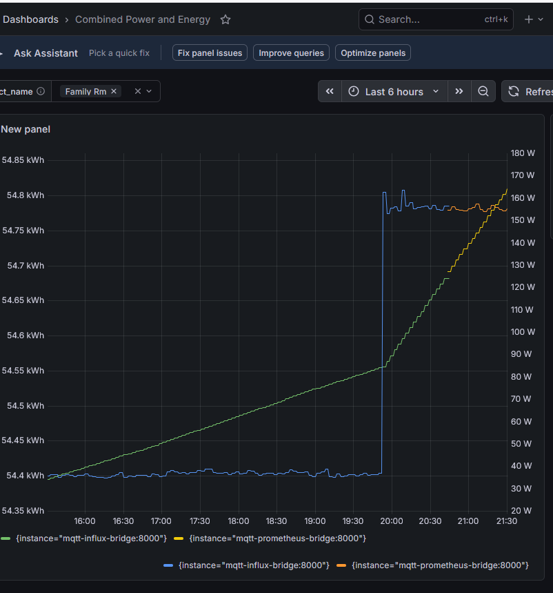

I originally setup influxdb and grafana local but realized grafana cloud was the way to go. Here is a circuit

Prometheus is what logs to Grafana cloud.
Sorry I had influx and grafana local and decided to simplify it
Curious what benefit the grafana local will give you?
I found that I wanted to look at stuff while at work and couldn't.
