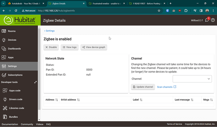

Attached a screenshot. I assumed the null Extended Pan ID was because I didn't actually have any Zigbee devices attached to my network yet, but maybe not?
I thought the Null seemed wrong, so I went into Settings > Diagnostic Tool > Advanced > Reset Zigbee Radio.
Then I see that after a reboot, I do have a Pan ID.
However, both before and after I reset the Zigbee Radio, the red balloon is saying "ZigBee network is offline." - even though on the Zigbee Details page, it's saying "Zigbee is enabled and is in join mode".

If the radio is offline, you cannot reset it because there is nothing to reset, the radio is not there. I would try shutting down the hub from Settings, then when the led on the hub turns red, unplug the hub for a minute. When it comes back online go to Zigbee Details. If it doesn't show that status is ONLINE, I suggest returning the hub.
